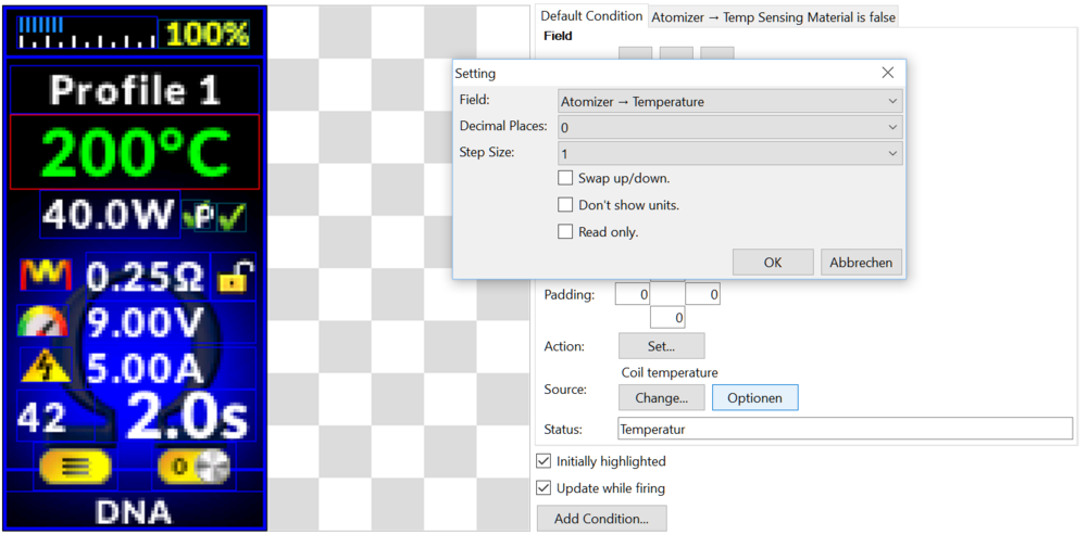

X-R4Y Posted October 16, 2017 Report Share Posted October 16, 2017 Open eScribe, Theme Designer, open your screen for editing temperature control settings, select the temperature field -> Source: Temperature -> Options -> Step Size You can change it to different values (1,2,5,10) to your likings. Link to comment Share on other sites More sharing options...

Dimento Posted October 22, 2017 Report Share Posted October 22, 2017 Select inside the Theme Designer the "Screens" Tab and then select the Mainscreen (right side). Then select inside the Screen editor the Temperature Field. On the right side will appear the wanted Settings. See also the attached Screenshot.... 1 Link to comment Share on other sites More sharing options...
