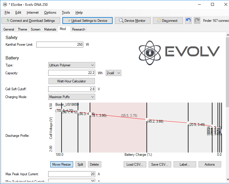

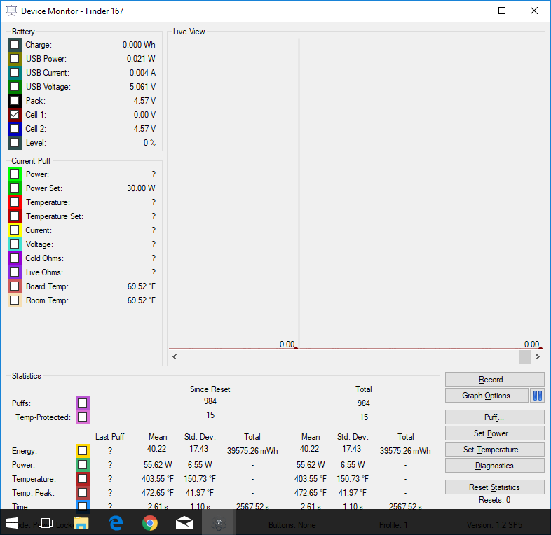

Ricky84 Posted September 11, 2017 Report Posted September 11, 2017 Hi guys, I desperately need help before contacting vendor. had finder for 2 days and now getting check battery error. using brand new samsung 30Q batteries. Please see screenshots: battery setup.bmp device monitor.bmp
dwcraig1 Posted September 12, 2017 Report Posted September 12, 2017 The battery management chip is defective, nothing can be done other than replace the board/mod to fix it by the consumer.
Ricky84 Posted September 12, 2017 Author Report Posted September 12, 2017 5 hours ago, dwcraig1 said: The battery management chip is defective, nothing can be done other than replace the board/mod to fix it by the consumer. Hi, thanks for the feedback. Was really hoping that would not be the issue..
