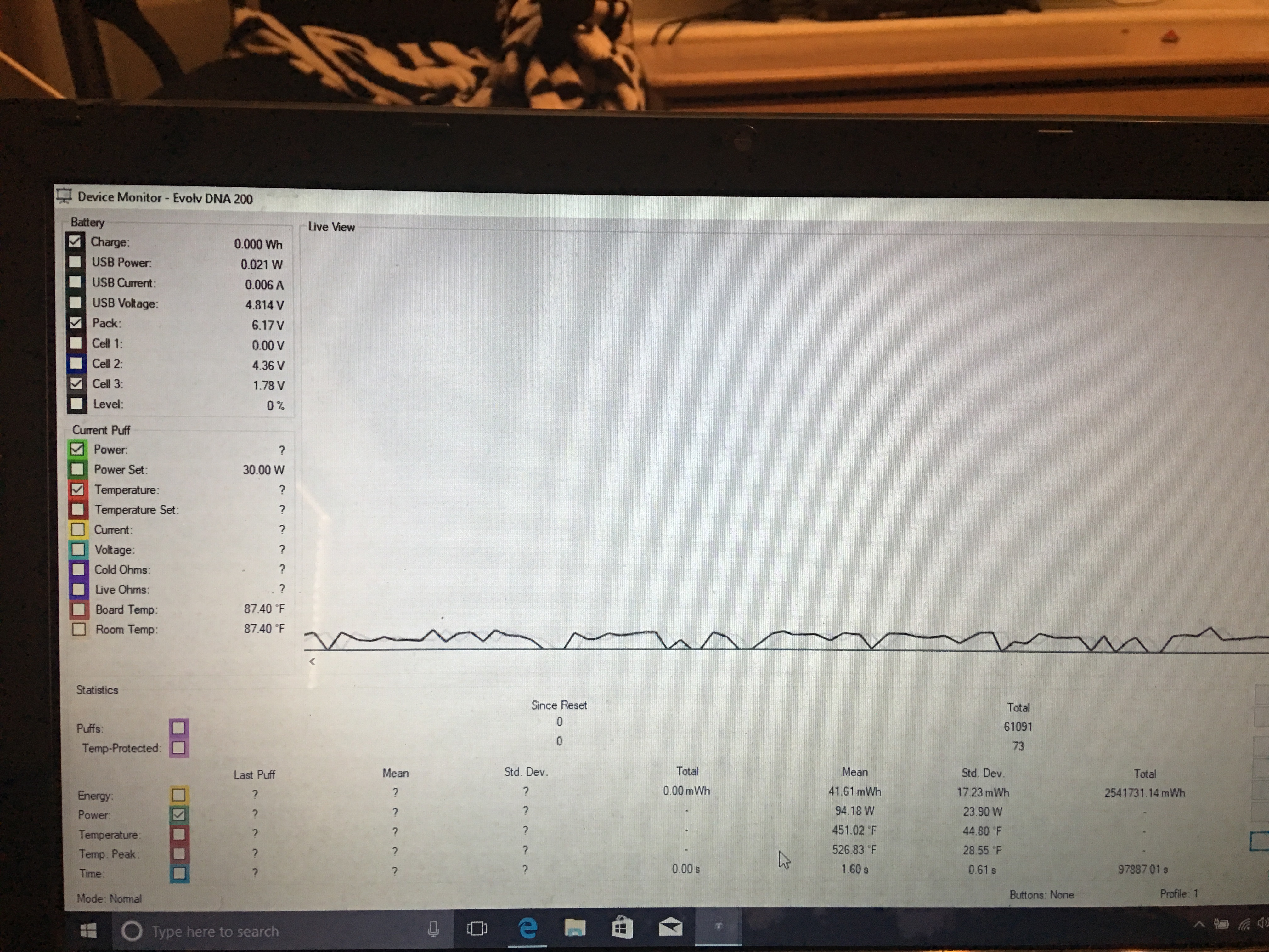

Bcr8709 Posted August 24, 2017 Report Posted August 24, 2017 So after I picked this DNA 200 up, I notice that it wasn't reading my batteries so I charge all three batteries all running at 4.19 4.20 V but it still told me to check batteries. If I add any atomizer ANY, it flashes "short" so I have attached a picture of the monitoring system after resetting said DNA to factory settings, if anyone knows how to read it well enough, please help, if you can. TIA!!!!!
BobC Posted August 27, 2017 Report Posted August 27, 2017 Looks like you have a battery connection problem on the mod
Lowbytes Posted August 27, 2017 Report Posted August 27, 2017 If all connections are soldered well (Balancer Port to cells) your DNA Board may be broken - you have already tried to reset to factory defaults - try to reflash the latest service pack - if it won´t help open a helpdesk ticket
