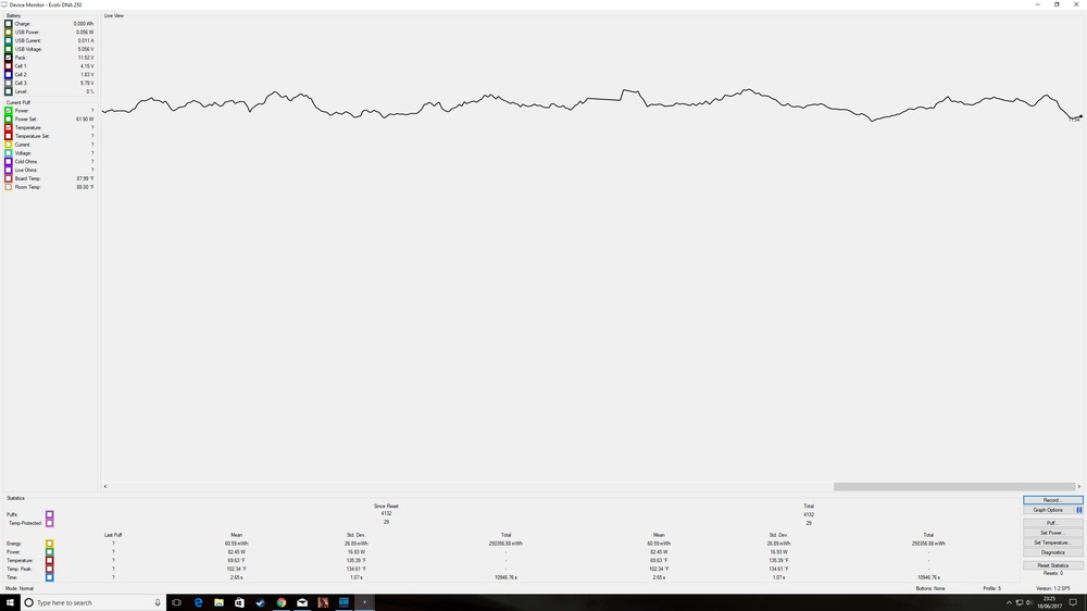

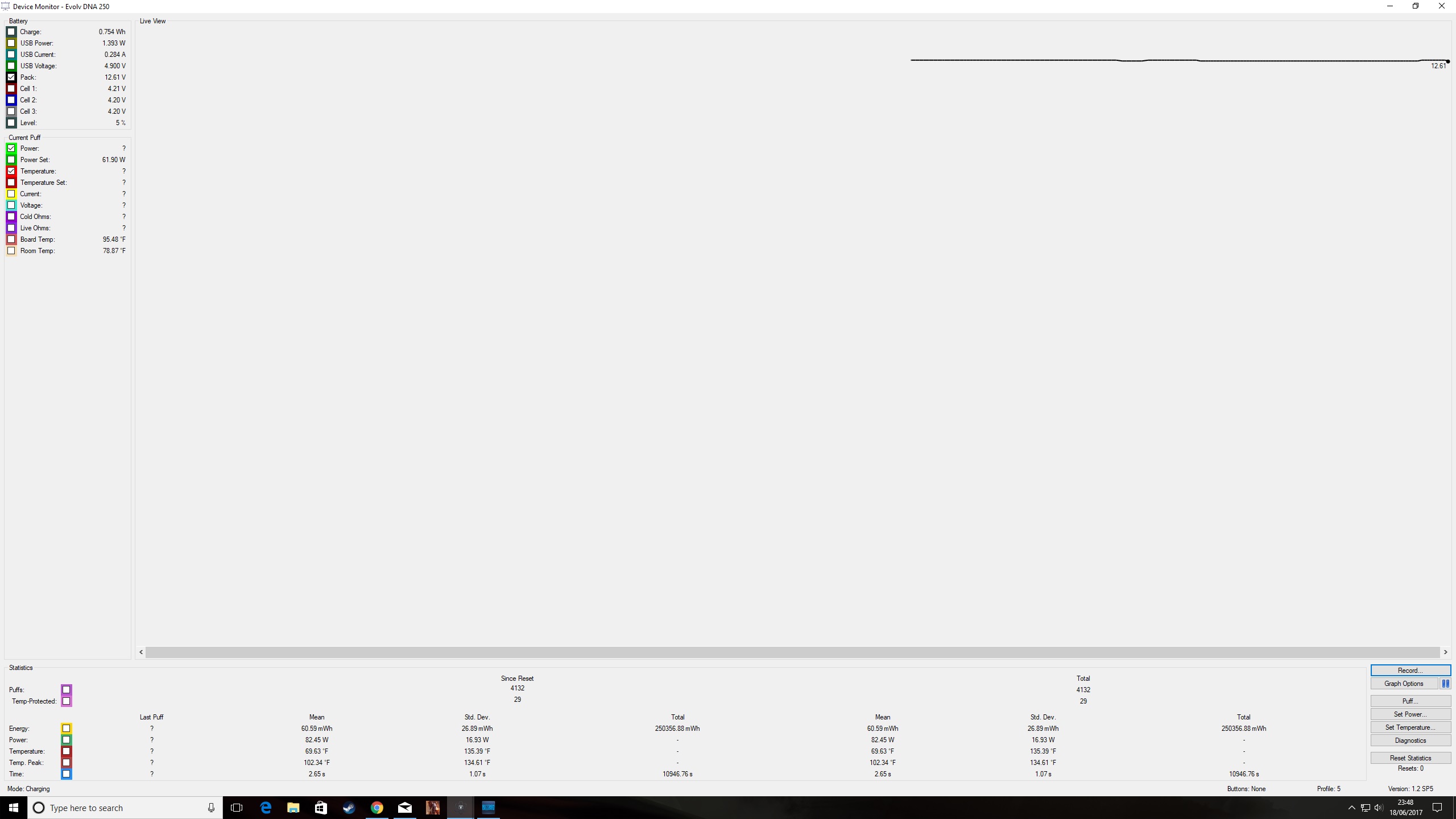

Ollie1221 Posted June 18, 2017 Author Report Posted June 18, 2017 no, i dont really use escribe much. i will connect it up now and printscreen the device monitor but i dont really know what i am looking for. i have desoldered all the connectors so i just have the chip at hand do i need so wire it all back up again to see whats going on in the device monitor?

67exec Posted June 18, 2017 Report Posted June 18, 2017 Does the board seem to work ok when the battery shows correct in escribe?
Ollie1221 Posted June 19, 2017 Author Report Posted June 19, 2017 Yeah but shows the battery is about quarter of the way full when I know the battery is charged a lot more than that.
