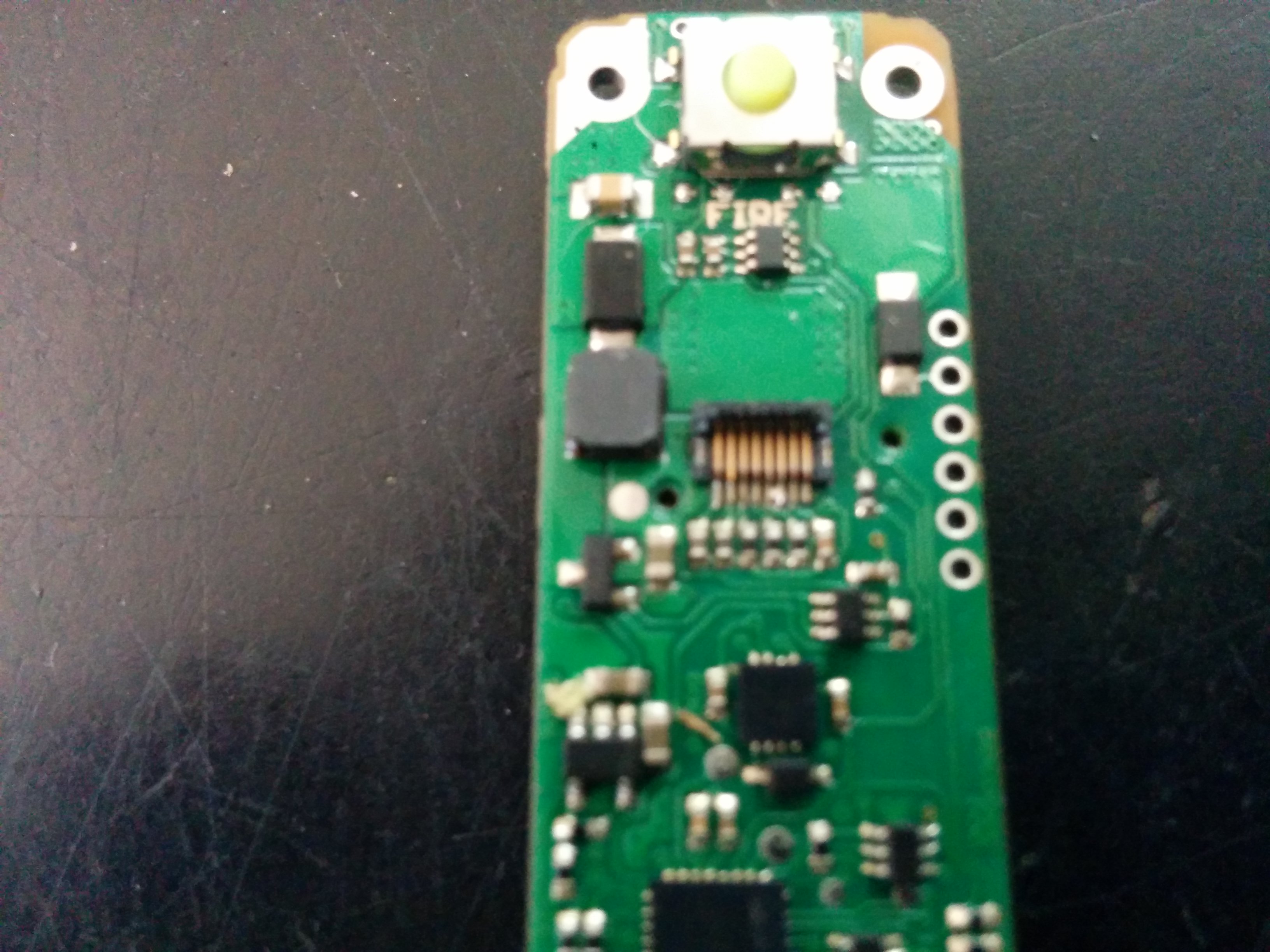

Legros Posted July 10, 2015 Author Report Share Posted July 10, 2015 Can you look at this Look like 2 pin on screen connecter are connected This is not normal? Link to comment Share on other sites More sharing options...
John Posted July 10, 2015 Report Share Posted July 10, 2015 Definitely not normal. If you are handy with solder wick and can remove it, you're welcome to do so. If not, send it back and we'll fix it. Sorry about that! I'll add a check for bridges there to the AOI program. Link to comment Share on other sites More sharing options...
Legros Posted July 10, 2015 Author Report Share Posted July 10, 2015 Good have some solder wick Thank you Link to comment Share on other sites More sharing options...
