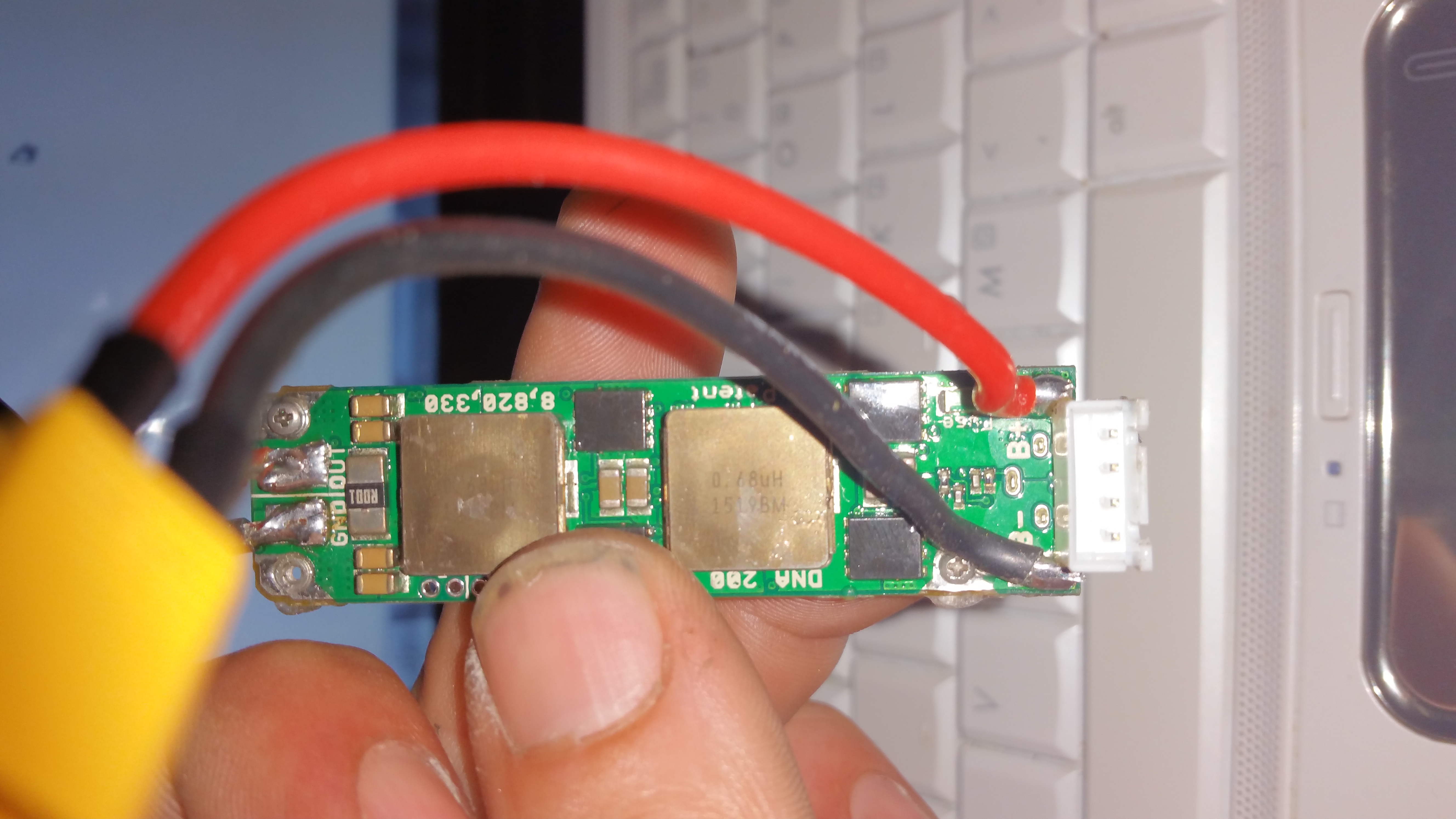

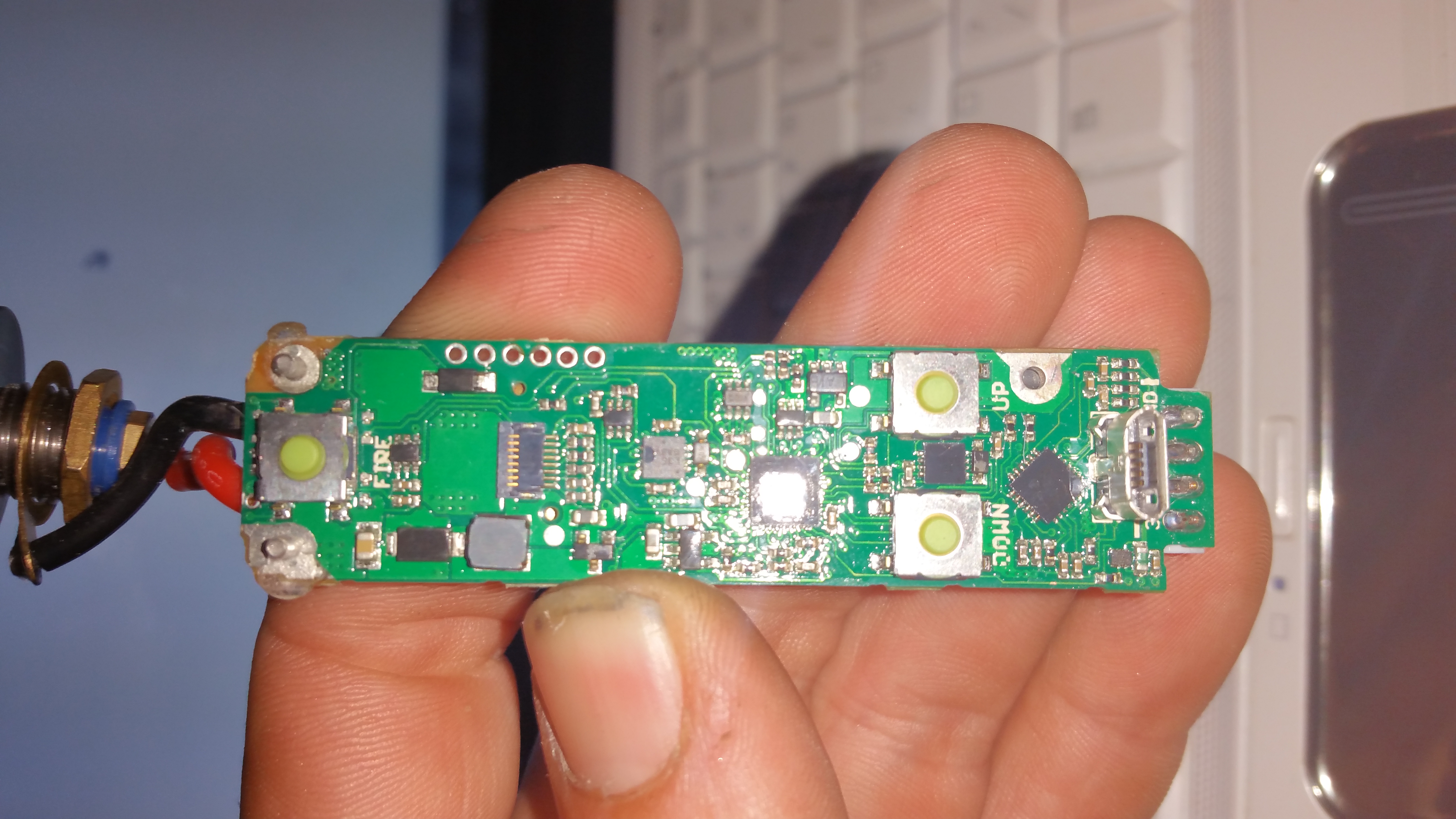

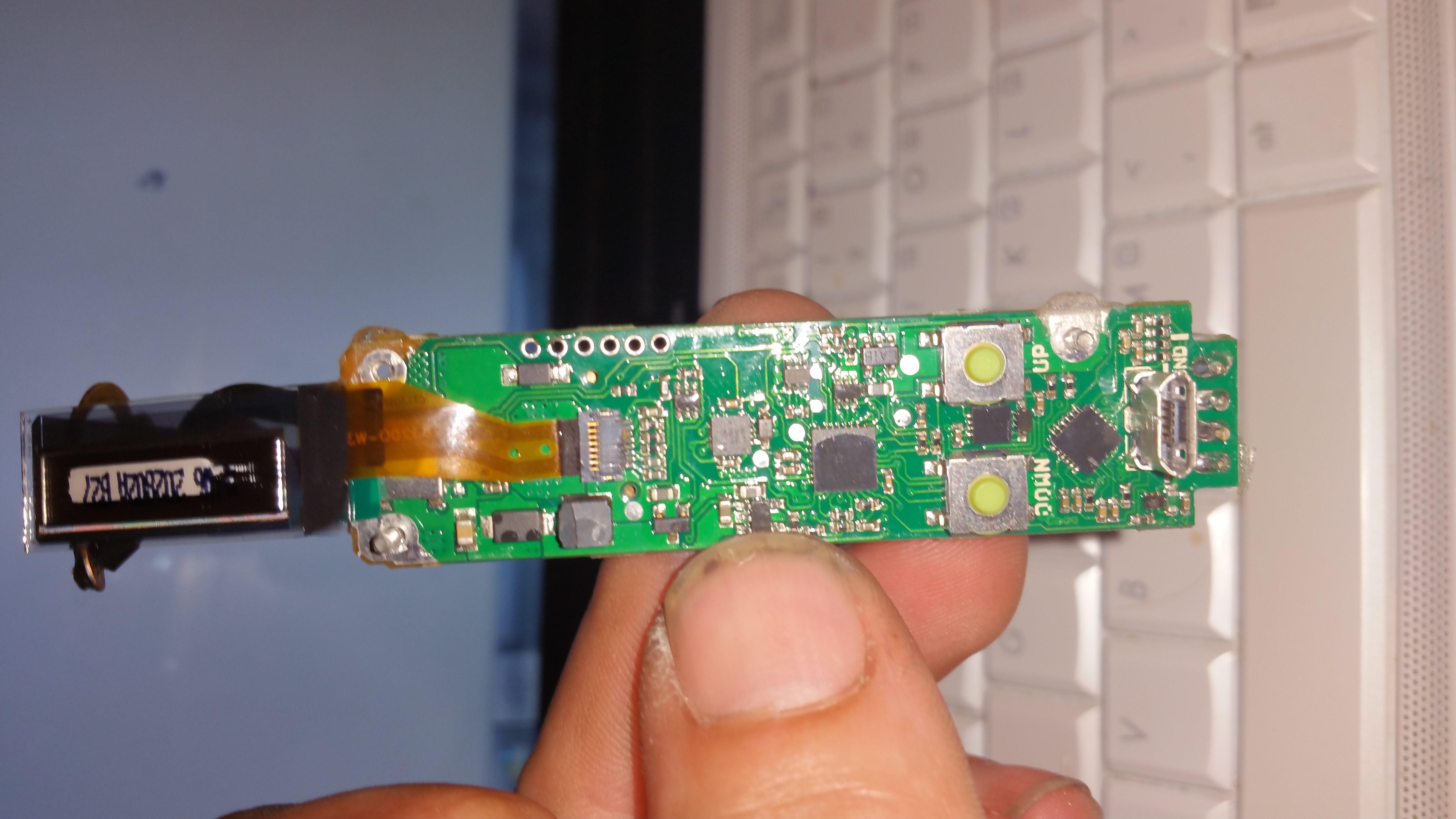

John Posted August 1, 2015 Report Posted August 1, 2015 Yeah the production date would be great, so we can see who was on the depaneling machine that day. That is my theory where that damage is coming from, they had to have the resistors when they got tested or they would have failed test and been sorted out.

John Posted August 2, 2015 Report Posted August 2, 2015 On the second one, is the tallest black component next to the screen connector... Cracked?
John Posted August 2, 2015 Report Posted August 2, 2015 Yeah that isn't any trouble I will have replacments out to you Monday, but I would like to get to the bottom of why you are having such unusually high numbers of issues. Are these being shipped to you in the retail black boxes?
Yurlosin Posted August 2, 2015 Report Posted August 2, 2015 They were in the black boxes I may have cracked the little black thing messing with the screen bezel taking it back apart after it didn't work I'd be more than happy to send all 3 to you so you can figure out what went wrong

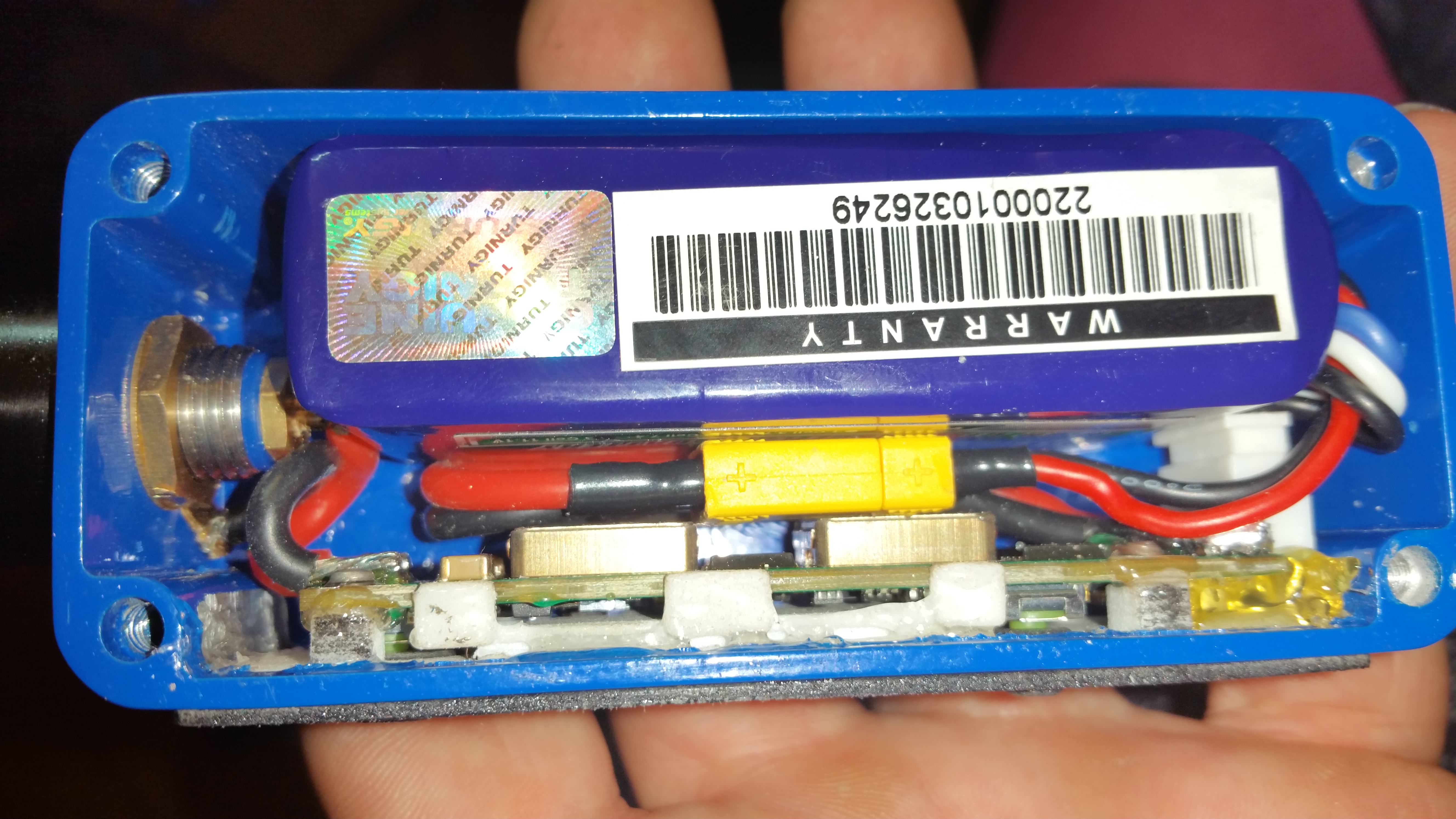

John Posted August 2, 2015 Report Posted August 2, 2015 Thanks. Can you also post (or pm) a picture of the inside of the mod these are going into? You know, the old once is happenstance, twice is coincidence, three times is enemy action.
Yurlosin Posted August 2, 2015 Report Posted August 2, 2015 No problem I understand the concern they are 1590a boxes turnigy nanotech 950 mah batteries and a mamu faceplate
