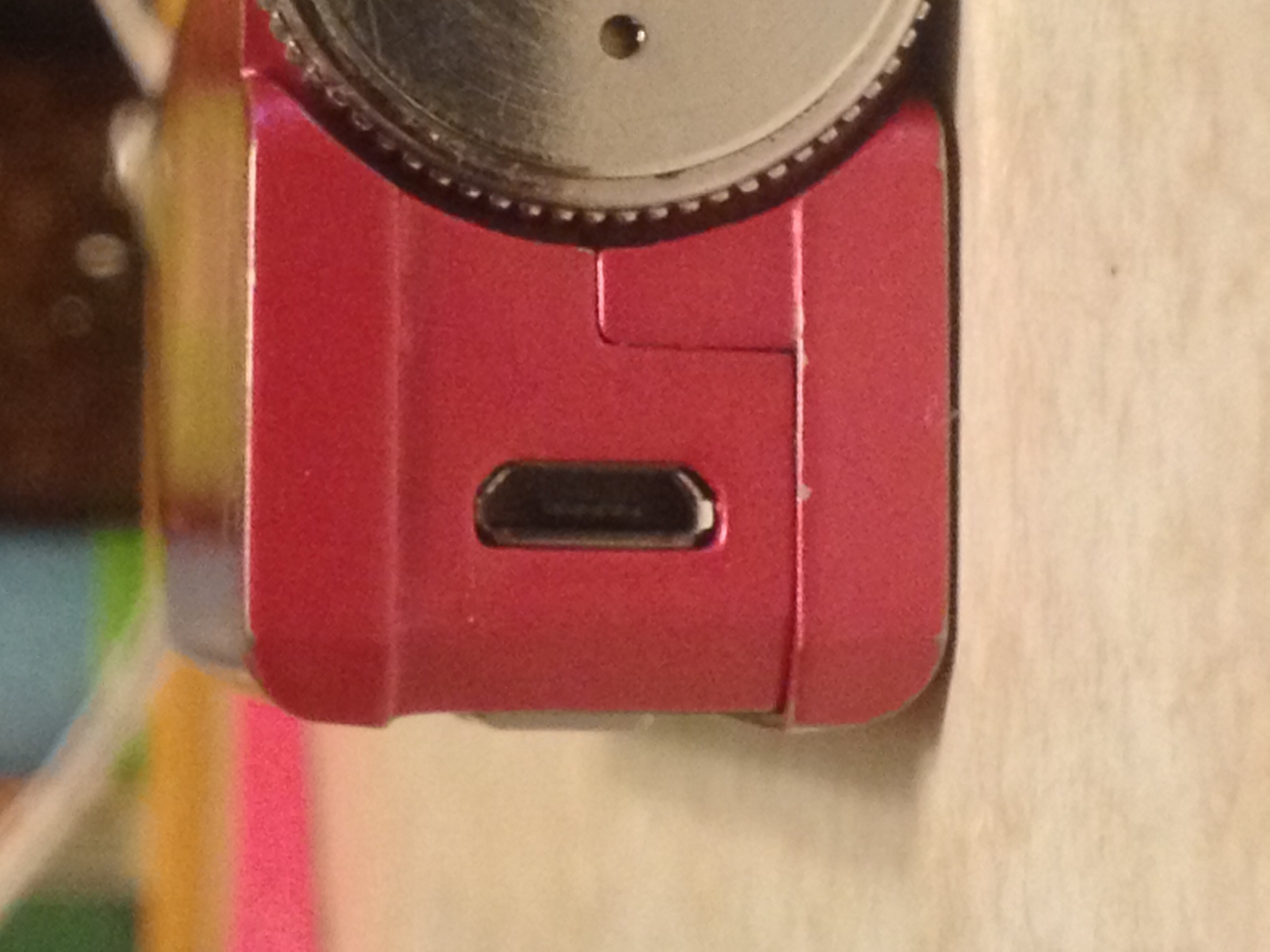

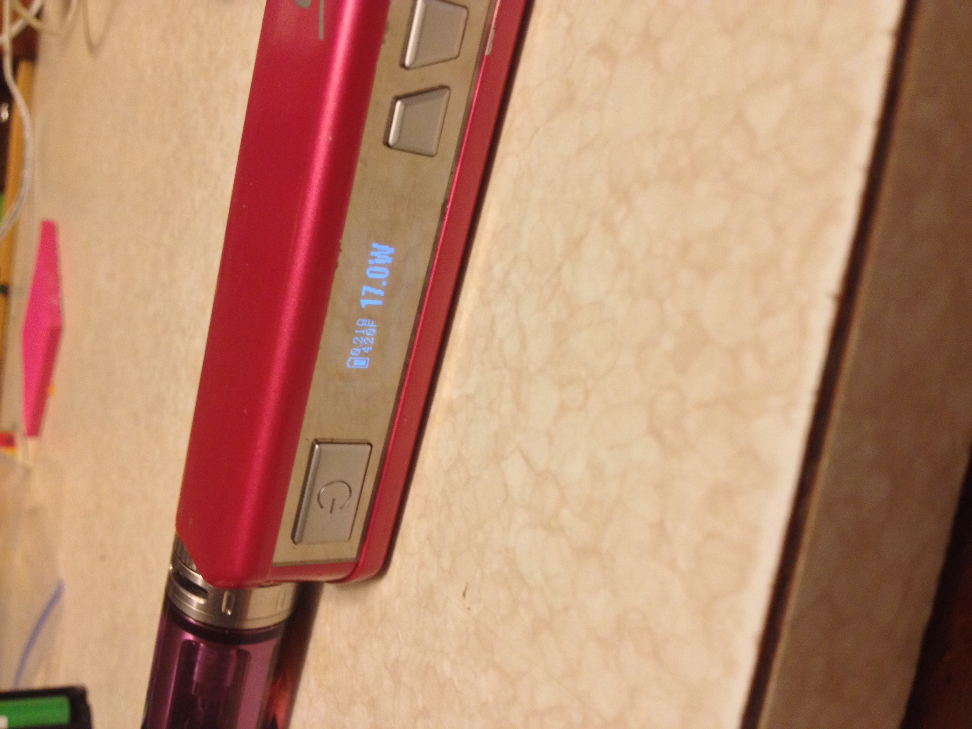

Guest Posted August 10, 2015 Report Posted August 10, 2015 Try fitting a DNA 25 in a ipv mini with charging capability like I did for my girlfriend

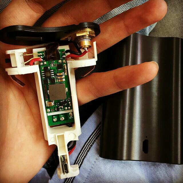

promod2000avenger Posted August 10, 2015 Report Posted August 10, 2015 Been trying to make the DNA 200 in a flask do-able.Some of my problems are as follows.Button configuration. (have to use remote buttons)Screen location. (have to make custom screen ribbon cable)And USB port.I am thinking I have to design a 3D printed sled to get everything to work.I'll keep you all updated when I succeed.Walt
