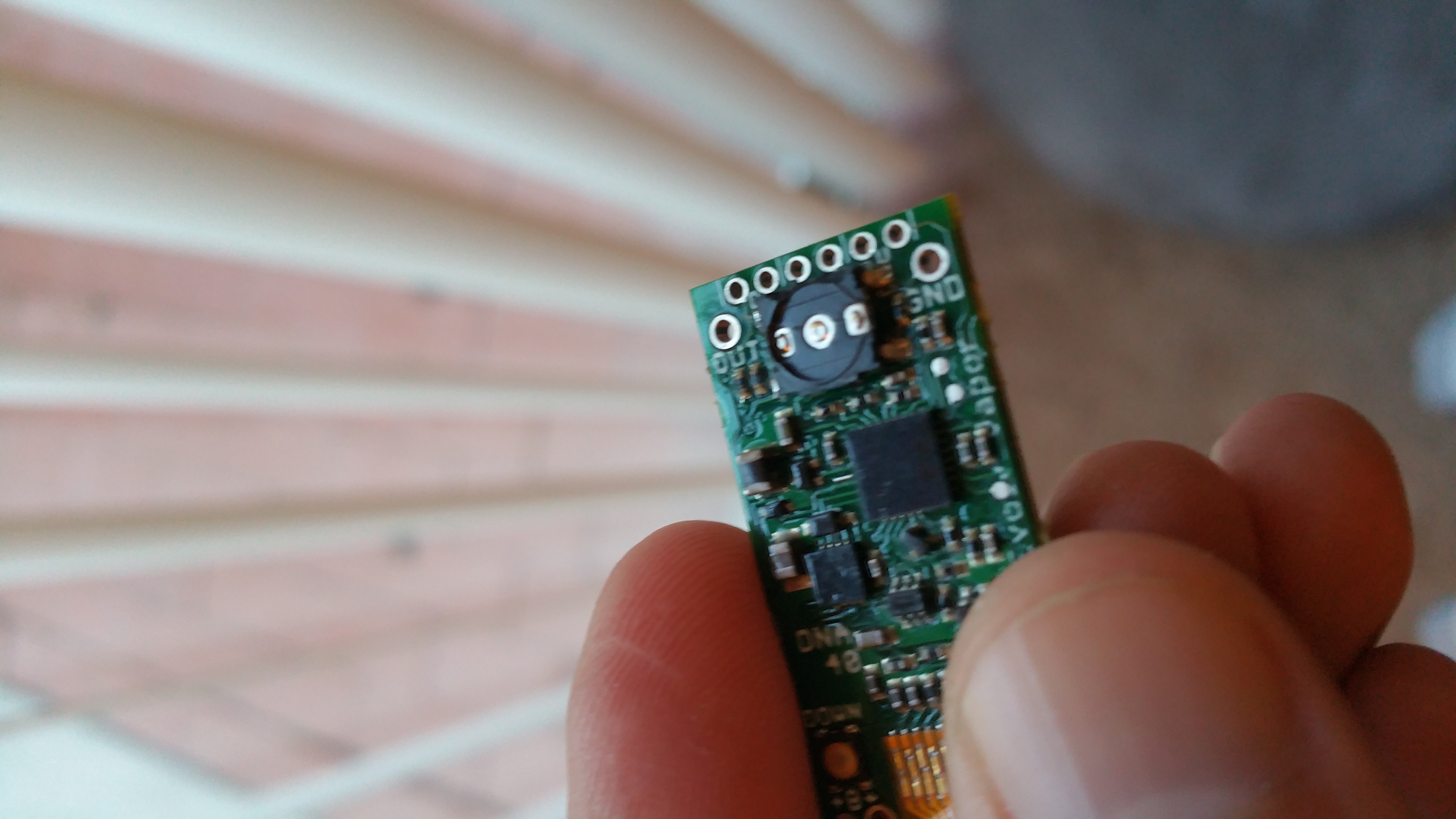

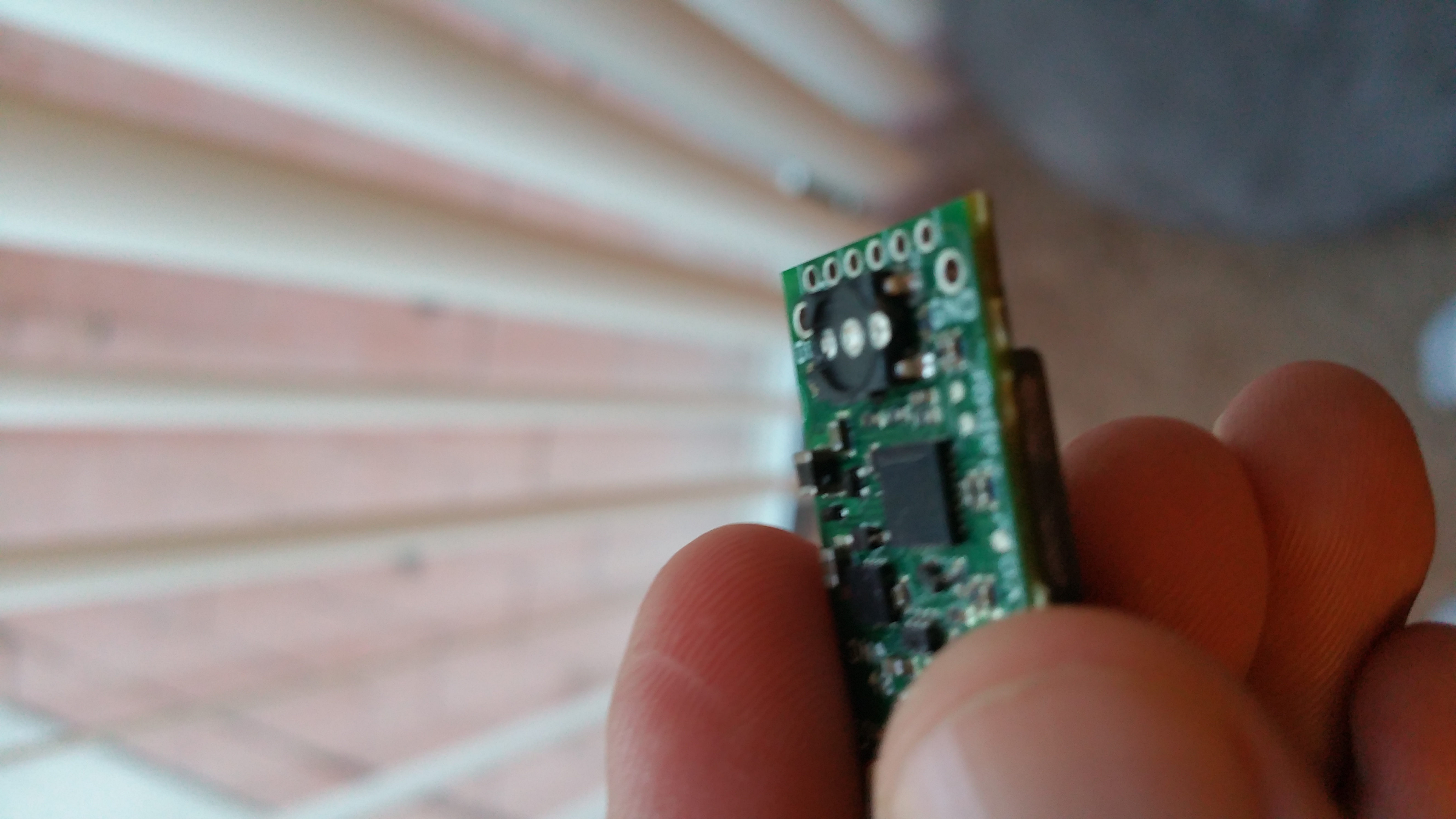

worserthanezra Posted July 21, 2015 Author Report Posted July 21, 2015 I plan on using remote switches for up/down and fire. Can the on-board buttons be removed as easily (without damaging the board) like the DNA40? I am trying to cut down on board width to create more space. Here are pics of a 40 with just the top section of the fire button removed to clarify what I'm intending to do.
John Posted July 21, 2015 Report Posted July 21, 2015 Yes, you can pull the actuator cap off the buttons quite easily if you need to. The buttons are, however, much harder to de-solder than the DNA 40 fire button, due to construction differences.
worserthanezra Posted July 21, 2015 Author Report Posted July 21, 2015 Okay, thank you John. I appreciate the info.

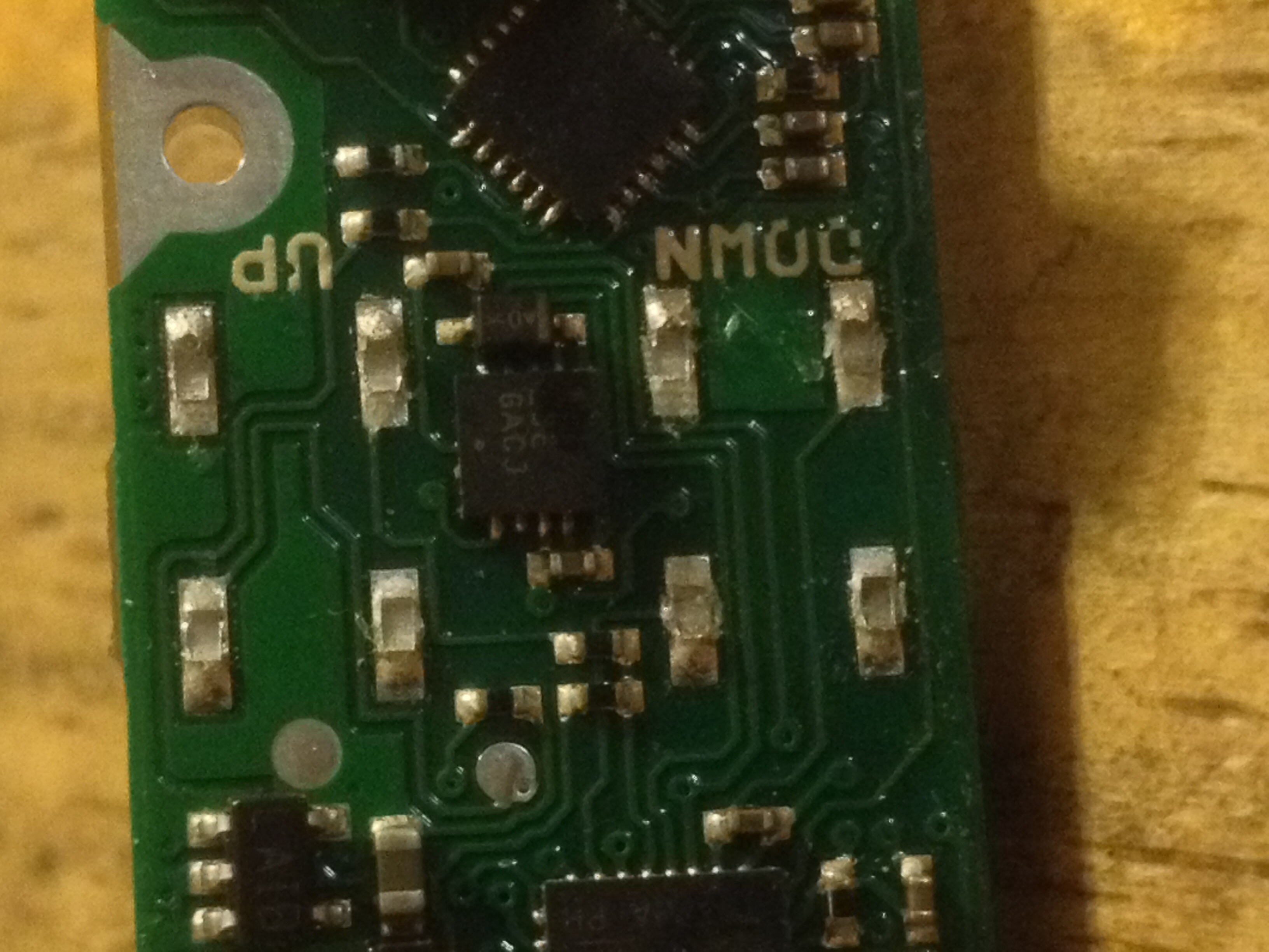

masonjarvapes Posted August 20, 2015 Report Posted August 20, 2015 Can you just clip them off Instead of desolder?
Guest Posted August 21, 2015 Report Posted August 21, 2015 Or put some needle nose pliyers on them and rock it back and forth, and yes the board does work
