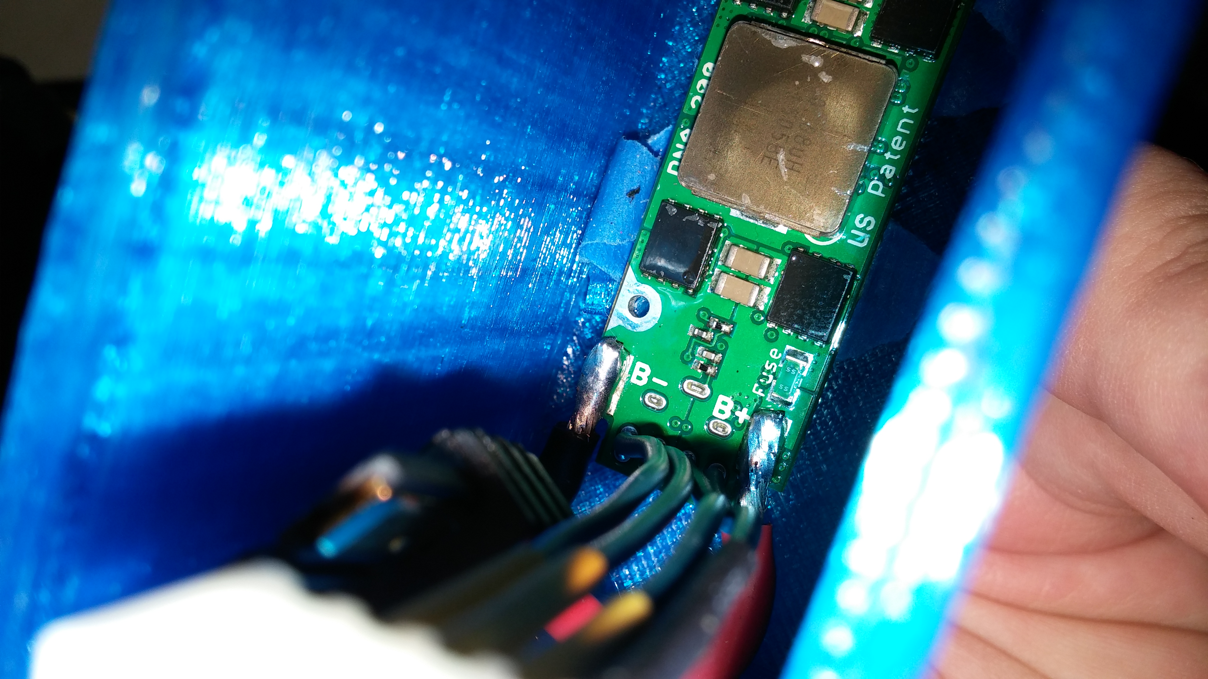

Sniffle Posted August 7, 2015 Author Report Share Posted August 7, 2015 I have had an assembled dna200 and its been working flawlessly for the last 3 weeks without issue. Out of nowhere this morning the fuse blew(didnt look blown initially only after feeling the fuse did the green cover flake off) on the way to work. Ive posted pics on Facebook and someone is saying that my battery wiring is too close to the fuse even though it doesnt extend past the solder pad and electrically they are tye same. This makes no sense and im still trying to figure out why this happened so that i can try to replace the fuse and keep on going. The camera angle makes the wiring seem extended further than it actually is Link to comment Share on other sites More sharing options...
John Posted August 7, 2015 Report Share Posted August 7, 2015 The battery ties to the fuse, you shouldn't blow it by soldering the wire to it. What kind of setup were you running? high ohms? low ohms? High watts? low watts?Anything different when it blew compared to how you had been running? Setup? Mechanical? Dropped?The wiring looks perfect to me, and it is't likely that you can short to case because your case looks 3d printed. Link to comment Share on other sites More sharing options...
Sniffle Posted August 7, 2015 Author Report Share Posted August 7, 2015 The case is 3d printed, it was not dropped fully charged battery from charging overnight 2200mah 30C 3s lipo. I believe it was ~.1ohm give or take running between 75 and 100 watts. Im beginning to think something might have happenened to my atomizer even though it looks pristine because while my DNA40s smay not fire it well... It should at least read the ohms... And it isnt... Not dropped or anything thats why its so unexpected... It worked last night and literally quit working between puffs in the car on my way to work this morning. Link to comment Share on other sites More sharing options...
John Posted August 7, 2015 Report Share Posted August 7, 2015 Well it won't read ohms with the fuse blown, and we handle atomizer shorts explicitly, so those shouldn't pop fuses. Shouldn't isn't the same as "certainly didn't" but output shorts are considered part of normal operation. Link to comment Share on other sites More sharing options...
Sniffle Posted August 7, 2015 Author Report Share Posted August 7, 2015 So i just popped the atomizer on my DNA40 it is reading .11 so it isnt that low. Link to comment Share on other sites More sharing options...
