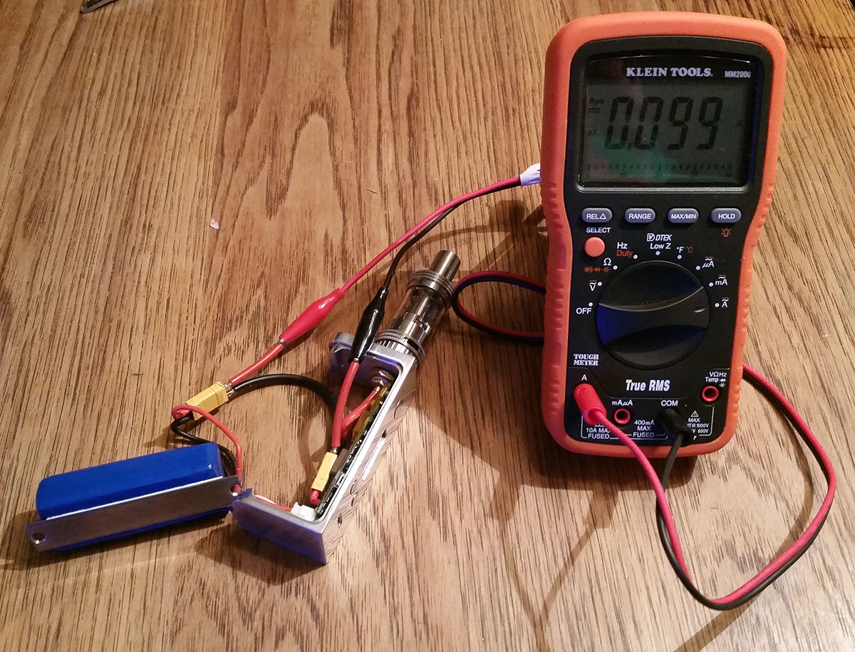

jevon Posted September 15, 2015 Report Posted September 15, 2015 I just started having a similar issue with my battery draining. I took it apart last night and made a connecter to go inline with the battery to measure current. I measured 0.1 Amps at idle. This picture was taken after 30 minutes of sitting idle on my table, still drawing 0.1 Amps. Is this normal? It seems awfully high for the microcontroller to draw that much current. Shouldn't it be in the 10's of milliamps? Does Evolve use the sleep timers available in their microcontroller?I'm going to look into it further this evening. Anyone have any ideas? Jevon
Brandon Posted September 15, 2015 Report Posted September 15, 2015 Should be about 18 milliamps active, 3.5 milliamps refining, and 25 microamps sleeping.
jevon Posted September 15, 2015 Report Posted September 15, 2015 Brandon said:Should be about 18 milliamps active, 3.5 milliamps refining, and 25 microamps sleeping. That's sounds more in line with my experience. I guess I'll submit a help ticket since something is not right. Thanks Brandon.

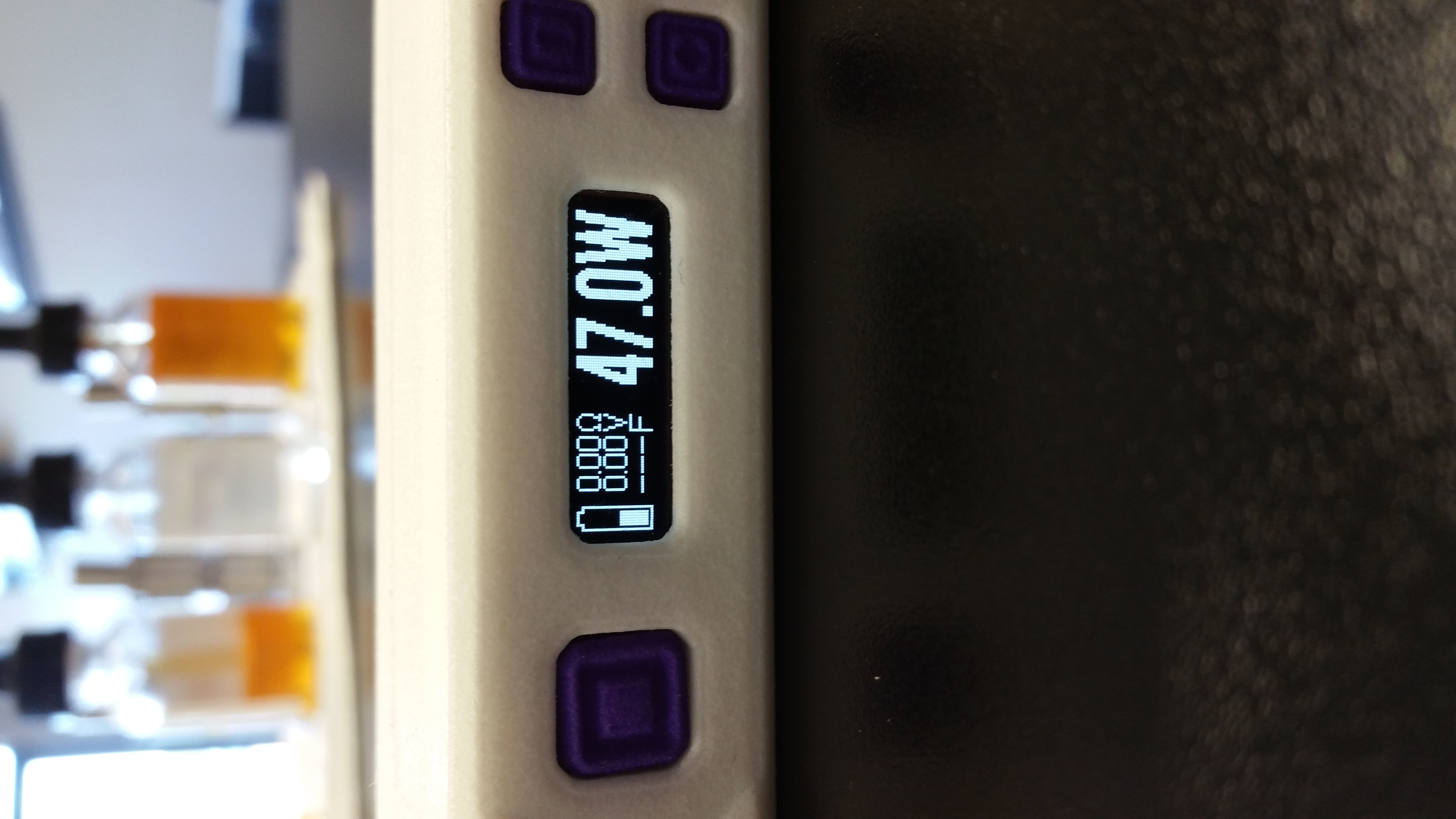

Teddybear Posted September 19, 2015 Report Posted September 19, 2015 I believe this the same issue I'm having. This box had a known good battery, installed good for 2 days then out of nowhere "check battery" "warranty service" errors started. Replaced the battery now it's discharging the battery and the charge port area is warm. Picture attached is 20 min after unplugging from overnight charge.
