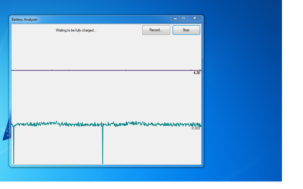

Toysoldiers Posted December 5, 2015 Author Report Share Posted December 5, 2015 im doing my own battery analyser but on the left of stop record it says (waiting for to be fully charged when it it already 100%). does this mean its not working? Link to comment Share on other sites More sharing options...
Jaquith Posted December 5, 2015 Report Share Posted December 5, 2015 It's normal and it's topping off the battery to full. When a battery is fully charged and left on the charger it will discharge a little, balance and trickle charge. It's all normal. Link to comment Share on other sites More sharing options...

Toysoldiers Posted December 5, 2015 Author Report Share Posted December 5, 2015 is this correct? is 70w to high for a battery analyzer? Link to comment Share on other sites More sharing options...
Jaquith Posted December 5, 2015 Report Share Posted December 5, 2015 Yep .. it will start once the battery is fully charged. Link to comment Share on other sites More sharing options...

Toysoldiers Posted December 6, 2015 Author Report Share Posted December 6, 2015 I charged my device all night and I'm still getting the 'waiting for it to be fully charged'. I left it charging over night and just plugged it into my computer for escribe. Does this mean I cannot do the test, any advise ? Link to comment Share on other sites More sharing options...
Jaquith Posted December 6, 2015 Report Share Posted December 6, 2015 Connect to Escribe open the Device monitor and each Cell's voltage. Hopefully it isn't doing something bad like overcharging. Full is 4.2V / cell. Link to comment Share on other sites More sharing options...
