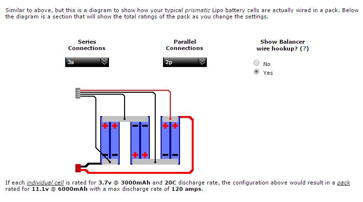

r3DJade Posted December 12, 2015 Author Report Posted December 12, 2015 I have made a 3s2p battery. when I hook up the regulator it dies. hooking up without the regulator seems to work fine. With the regulator it will power up when i press the fire button. What did I do wrong.
Jaquith Posted December 12, 2015 Report Posted December 12, 2015 The schematic is correct. Many of the errors that I've seen are mirroring the balancer exactly backwards .. often the balancer itself being soldered in backwards. Double check your connections.
