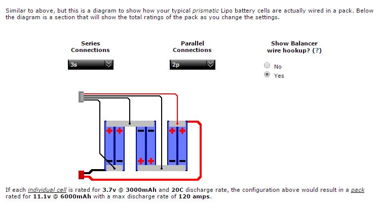

I have made a 3s2p battery. when I hook up the regulator it dies. hooking up without the regulator seems to work fine. With the regulator it will power up when i press the fire button. What did I do wrong.
