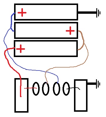

Badazz Vapor Posted January 21, 2016 Author Report Share Posted January 21, 2016 hey DNAersI'm building a box with 3 18650 battery's. I can't seem to find a proper wiring diagram of that.I guess it's not that difficult but i don't want to make a mistake.can someone hook me up with that. I don't want to take my wismec apart to check.thnx Link to comment Share on other sites More sharing options...

Badazz Vapor Posted January 21, 2016 Author Report Share Posted January 21, 2016 That diagram is actually helpfull thanks.The trouble is i have to figure out a proper batterie Lid for the mod and I planned the Batteries in series but have to figure out were to connect wich balancer wire. Link to comment Share on other sites More sharing options...

Guest Posted January 21, 2016 Report Share Posted January 21, 2016 I hard wire all my batteries (18650 and packs) like this Link to comment Share on other sites More sharing options...
Badazz Vapor Posted January 21, 2016 Author Report Share Posted January 21, 2016 So it schould be like this and i need just two wires from the connector. BtW wich battery is actually the first or number 1 Link to comment Share on other sites More sharing options...
Guest Posted January 21, 2016 Report Share Posted January 21, 2016 The one with the red wire going to it in your picture Link to comment Share on other sites More sharing options...
Badazz Vapor Posted January 21, 2016 Author Report Share Posted January 21, 2016 Oke, thnx. So i got to find a way to make the lower Battery Lid removeable with those Wires atached. Link to comment Share on other sites More sharing options...
Guest Posted January 21, 2016 Report Share Posted January 21, 2016 To make the wiring of the lid simple you could use a spring loaded contact pin for the balancing wire Link to comment Share on other sites More sharing options...
Badazz Vapor Posted January 21, 2016 Author Report Share Posted January 21, 2016 Oke that is possible. The original plan was to make the Lid out of damast steel like the other applications on the Mod but i have to build the Bridge for two Batteries in to that lid as wel asthe negative pole and the balancer cable, without shorting the whole thing. Link to comment Share on other sites More sharing options...
