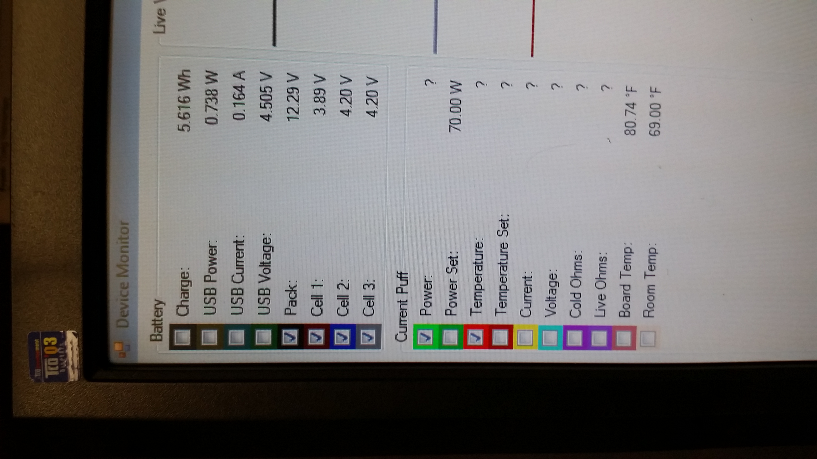

Spector NS5 RD Posted June 18, 2016 Report Posted June 18, 2016 don't condemn the battery yet. wait until you're able to use your friend's comp. make sure all the individual cell and pack voltage boxes are checked off in device monitor then take a screenshot and post it here. the charging is designed to stop when you take a vape (hit the fire button) then charging ramps back up right after you let go of the fire button.

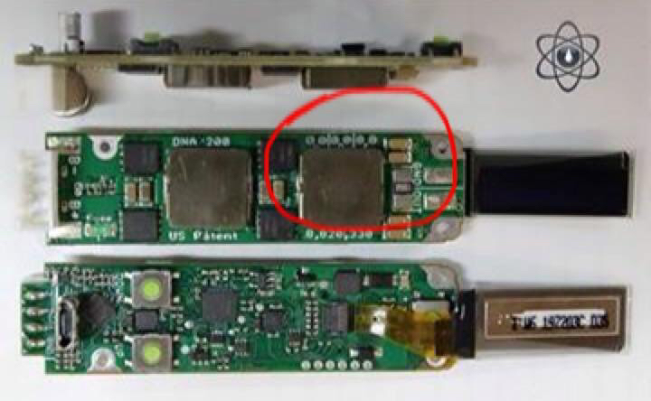

Hoopes242 Posted June 20, 2016 Author Report Posted June 20, 2016 So I connected to escribe last night and cell 1 was at 3.79v and the others were at 4.01v and would go higher at times when charging. But cell 1 would never go higher then 3.79v. I ran USB recovery several times with no change. Well atleast I think it was running it would prompt me if I wanted to run it then tell me it has been ran a certain amount of time and when I hit ok nothing else came up so I figured it was running. I remember before I put it up that there was a small rattle in it, and I took it apart the other night and found a small square piece had broke from the board, looks like a capacitor of some sort. There are two the same size on the back of the board and 3 smaller ones on the front from what I seen from pictures on Google. But that rattle started about a month before I put it up which means it was broke off before that and worked perfectly fine. I think it just needs a new battery. I have contacted hcigar and evolv about both the battery and the broken piece.
Hoopes242 Posted June 20, 2016 Author Report Posted June 20, 2016 Here are some pics of the live view of the voltage in each cell
Hoopes242 Posted June 20, 2016 Author Report Posted June 20, 2016 That's after a full charge overnight, cell 1 will not go above 3.89v so should I replace the battery? And does anybody know of a good replacement other then the hcigar battery that's already in it? I herd hcigar came out with an updated true 1300mah battery but I can't find it. I was looking at turnigy but now sure exactly how much moding will be needed and if it's worth it. And I know thunder power will custom make batteries for you, and are located in the states out of Las Vegas but there pricy.
Spector NS5 RD Posted June 20, 2016 Report Posted June 20, 2016 That square piece is called an inductor. it and other components are Responsible for helping to generate the necessary voltage to run your atty. Also it's part of the charging circuit. The board will run with only one inductor but is designed to run with both. Best to do what you are already doing, RMA the board or device.
