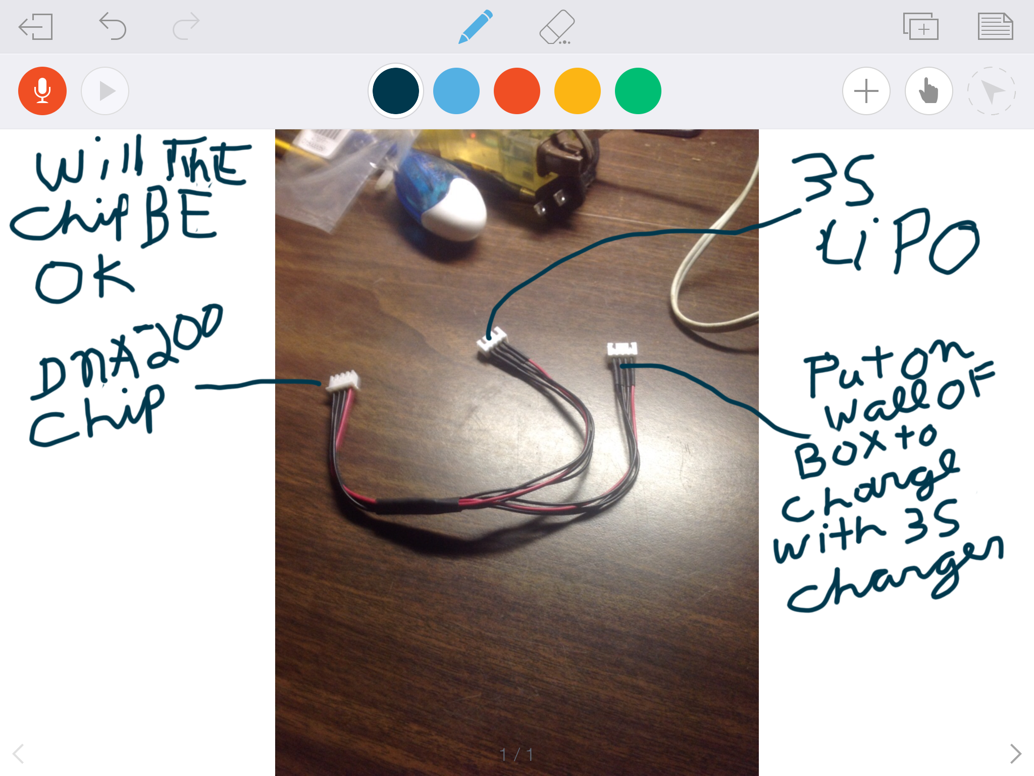

Pm196190 Posted July 15, 2016 Author Report Share Posted July 15, 2016 Want to make sure that it won't damage my DNA 200 board by using a splicer plug in to chip an have 2 plugs one to the Lipo Abe one to the wall off the box were I will plug in and external charger 3s Will it damage the board look at the attachment Link to comment Share on other sites More sharing options...
Spector NS5 RD Posted July 15, 2016 Report Share Posted July 15, 2016 i myself don't foresee any problems with that setup as long as you have the balance tap wired correctly. start at low amp charge the first few times to make sure you're not stressing or confusing the analog front end (square black chip above usb port). Link to comment Share on other sites More sharing options...

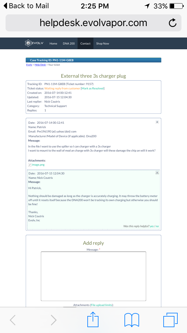

Pm196190 Posted July 15, 2016 Author Report Share Posted July 15, 2016 Evolv said it would work. Link to comment Share on other sites More sharing options...
