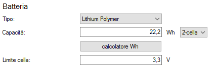

olaffo Posted July 18, 2016 Author Report Posted July 18, 2016 Hi everyone,i'm new in this site and i'm happy to find a rich amount of information about DNA.I've some question.I buied a Hcigar VT133 MOD with DNA chip, and installed 2 brand new Samsung 30Q batteries, setted up the batteri information in Escribe as in the picture below: in the device monitor the readings are this Isn't strange that the mod is reading a third cell?Is the setup rigth?I also used the CSV for the 30Q, but i'm confused about the Wh: with the calcs i reach the 22,2Wh (3000mA * 7.4V), but in the file there is a description tha refers to 28.51Wh. Which one is correct?Thank YouLuca
dwcraig1 Posted July 18, 2016 Report Posted July 18, 2016 That 3rd cell reading is normalI would set the soft cell to 2.9 volts and subtract about 10% from your watt hour calculation. (about 20 watt hours)The 28.51 sounds like what 3 cells would be.Why less watt hours? the battery was rated between 2.5 - 4.2 volts, you will be using 2.9 - 4.2 volts.
olaffo Posted July 18, 2016 Author Report Posted July 18, 2016 That 3rd cell reading is normalI would set the soft cell to 2.9 volts and subtract about 10% from your watt hour calculation. (about 20 watt hours)The 28.51 sounds like what 3 cells would be.Why less watt hours? the battery was rated between 2.5 - 4.2 volts, you will be using 2.9 - 4.2 volts.Thank you.just to understand better your words: is the reason of your suggestion due to the specs, in particular the one bolded above?[CODE]Samsung INR18650-30Q 3000mAh (Pink)Official specifications:...End voltage: 2.5VMax. continuous current: 15ARated discharge capacity (0.2C): 3000mAhRated discharge capacity (10A): 2700mAh...[/CODE]
