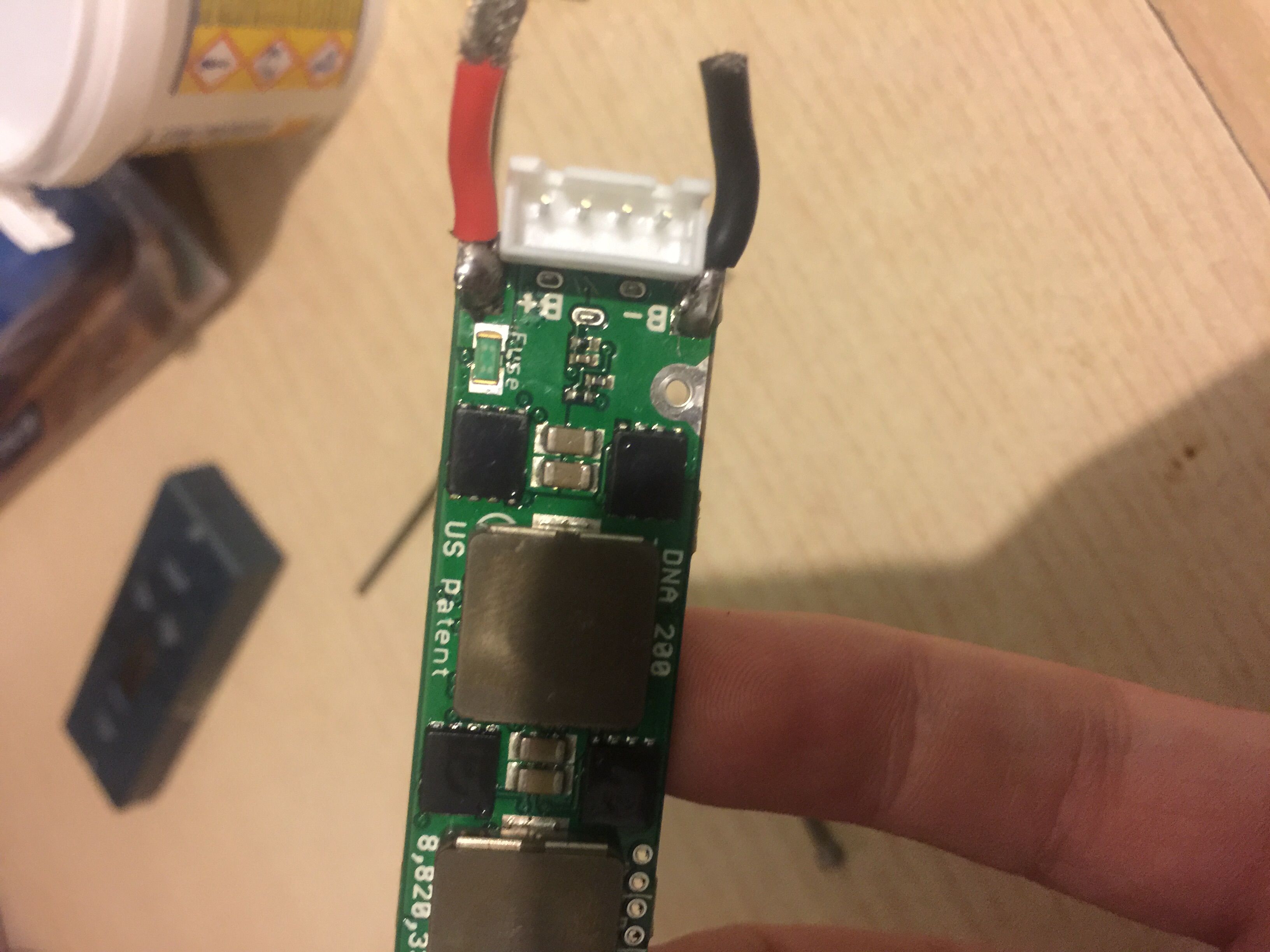

mozzy86 Posted September 9, 2016 Author Report Posted September 9, 2016 Hi guys, I'm new here .. I have a tugboat dna200 that does not work, with connected battery will not turn on but if I connect it to the PC comes on, I detect the battery cells but just detachment dies ... what can it be? the battery and the circuit are new just changedthank you very much and sorry for my english I'm Italian
dwcraig1 Posted September 9, 2016 Report Posted September 9, 2016 That's the way they do when the fuse is blown.
dwcraig1 Posted September 9, 2016 Report Posted September 9, 2016 https://downloads.evolvapor.com/dna200.pdfIt shows it well here.
mozzy86 Posted September 9, 2016 Author Report Posted September 9, 2016 Thanks!! But it is green like in the photo
