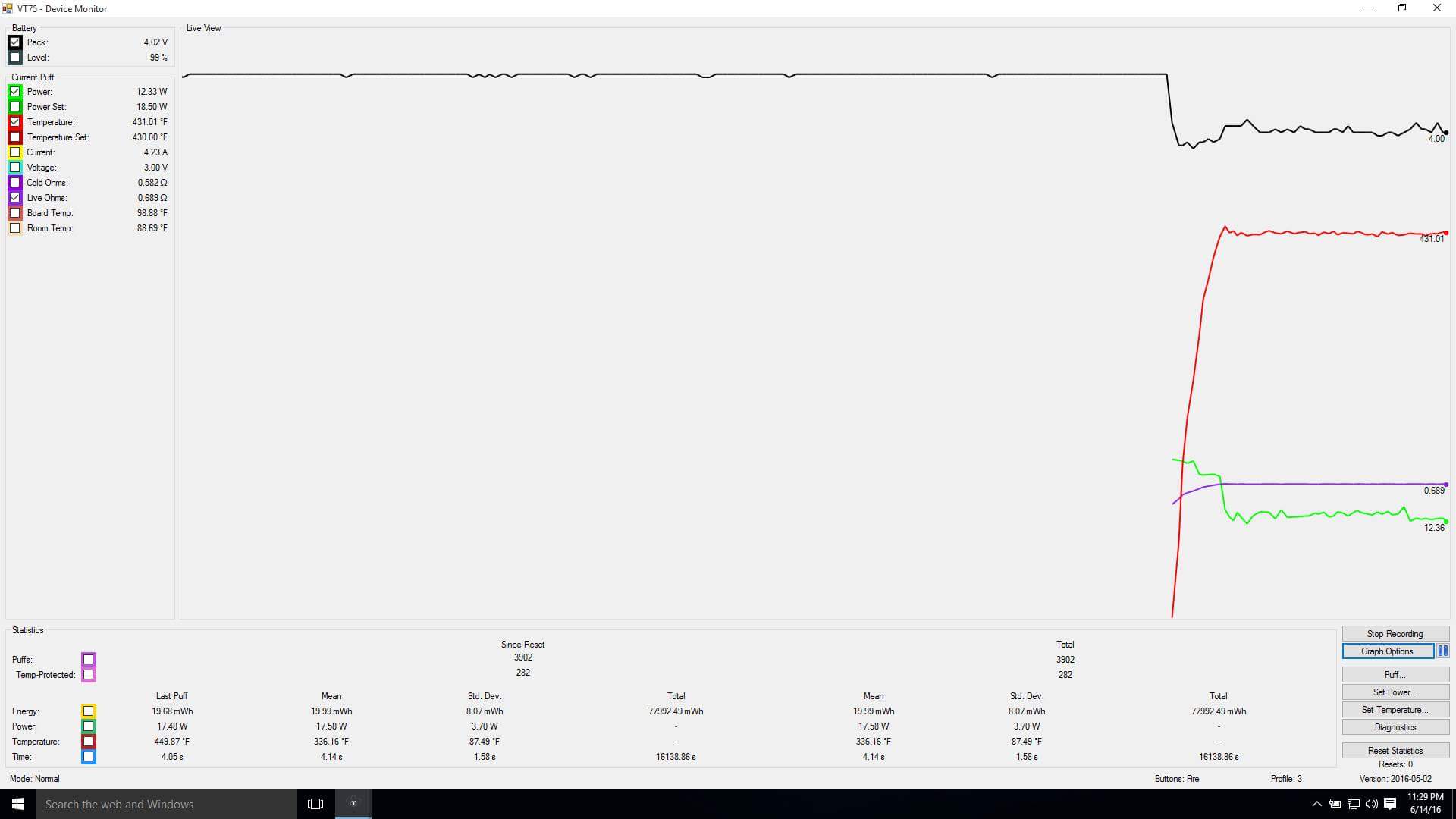

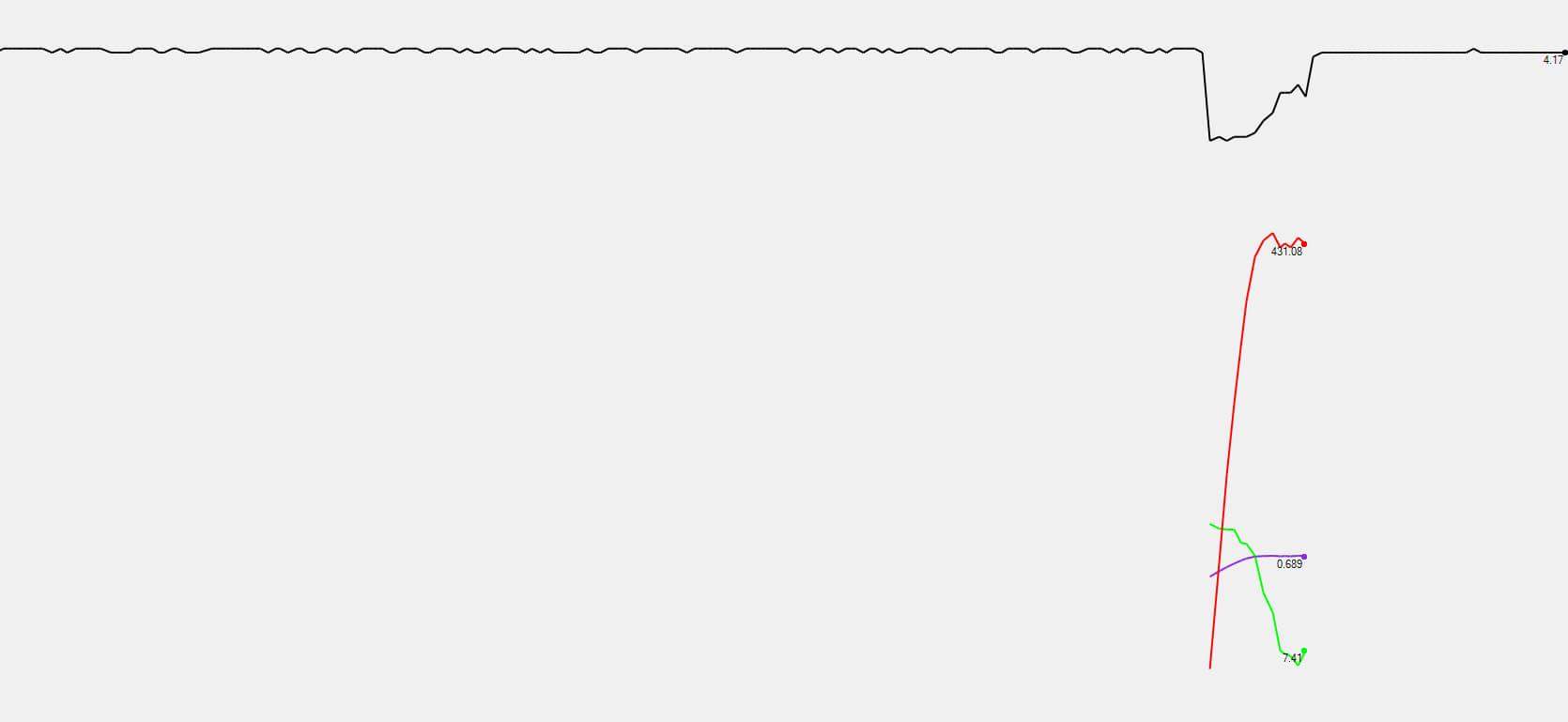

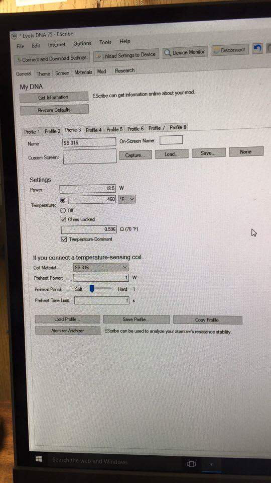

Modbustersecig Posted September 30, 2016 Report Posted September 30, 2016 Welcome aboard for my self and I screw up a lot I had to put my fancy builds a side 24 GA ss 316 wire is pretty much my go to never above .15 ohms after setting up my mod using Escrib I use there wire profIle for 316 ss and lighting vape wire works great for me set up temperature, dominant pre heat set 45 punch medium running watts set to 25 the board takes care of the watts as per were the temperature is set 400 degrees Fahrenheit is a good starting point run the temperature up slowly till you find your sweet spot I like to be hooked to escib device monitor to see how my flat line is holding hope this helps here are some screen shots from I believe DNA 200 edit correction that is from a DNA 75 I help set up awhile back do not lock ohms as in pic
