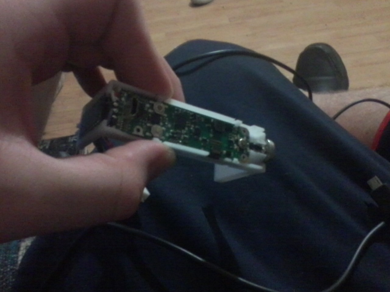

mattbtw Posted March 6, 2016 Author Report Share Posted March 6, 2016 i was wondering if this is a bad fuse or bad battery, because i just replaced the battery.i get the message warranty service. and when i go to device monitor, and this what it looks like. The board works fine when the battery is unplugged, as fine i mean when its disconnected from the mod and just plugged in through the usb.i would just check the fuse but, i cant get to it because its on a thick plastic mounting piece, i don't want to risk breaking the board to get it off. Link to comment Share on other sites More sharing options...
Spector NS5 RD Posted March 7, 2016 Report Share Posted March 7, 2016 does look like a blown fuse. only way to be sure is to check the fuse's continuity or lack of with a DM (digital multimeter). or send it back, if it's still under warranty.double check your main positive and negative connections. make they are both fully snapped in and making good connection. same goes for the balance tap connector. was the mod working/vaping before you replaced the battery? Link to comment Share on other sites More sharing options...
