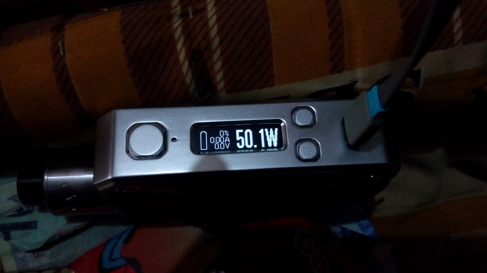

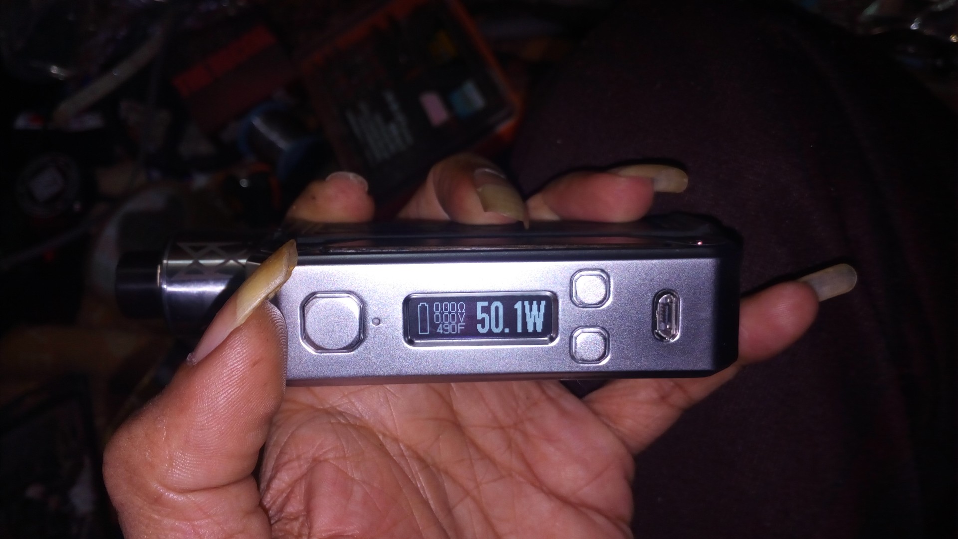

Panca Posted February 8, 2017 Report Posted February 8, 2017 I have therion 133, and when standby about 1 hour, display show " shorted" when im push firing button, when im plug charging , its not show charging, i must pull out the lg hg2, but when i put again that batree all is normal charging, and i can vape normally, but abnormal again if standby more than 1 hour, how can i do ? Im from Indonesia
Spector NS5 RD Posted February 8, 2017 Report Posted February 8, 2017 Behnud Aminrezai said:I have The same problem,but i dont know what i must to do ?I need help toohttps://www.youtube.com/watch?v=VTH_AHKNfhw&t=27s board is most likely bad. in the bottom of my signature are the links for Lost vape warranty repair and Evolv. i suggest contacting the vendor first and ask about a return, if the device is new before contacting LV or Evolv.

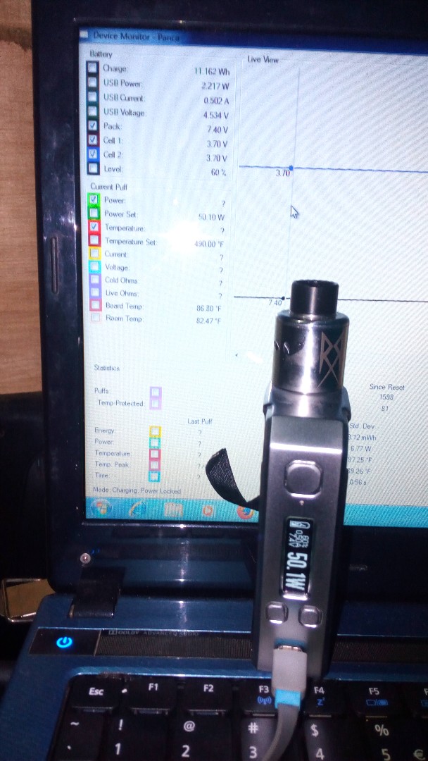

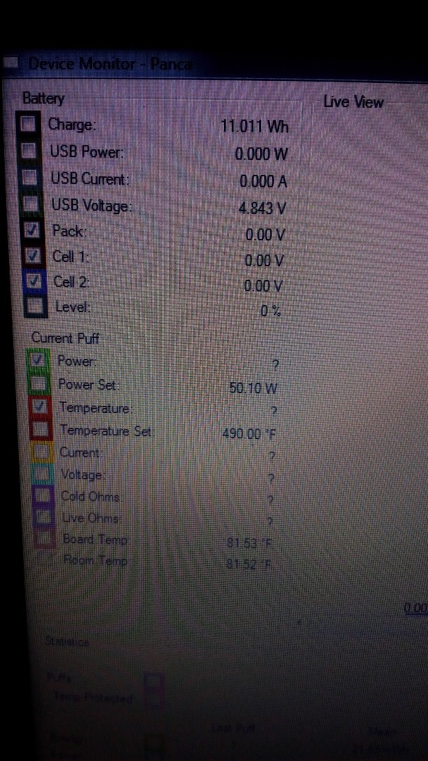

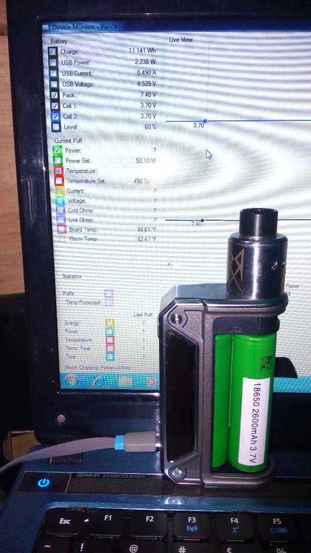

Spector NS5 RD Posted February 8, 2017 Report Posted February 8, 2017 Panca said:I have therion 133, and when standby about 1 hour, display show " shorted" when im push firing button, when im plug charging , its not show charging, i must pull out the lg hg2, but when i put again that batree all is normal charging, and i can vape normally, but abnormal again if standby more than 1 hour, how can i do ? Im from Indonesiapost a screenshot of Escribe's device monitor with the battery option boxes ticked, when the device is displaying shorted.
Panca Posted February 8, 2017 Report Posted February 8, 2017 ChunkyButt200 said:post a screenshot of Escribe's device monitor with the battery option boxes ticked, when the device is displaying shorted. This is when " shorted "

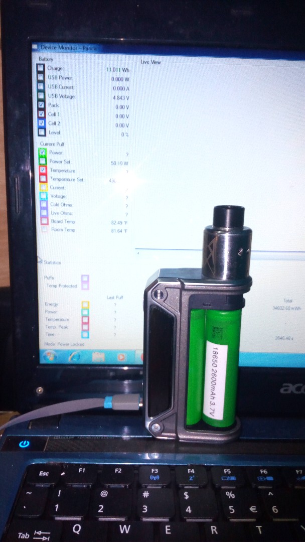

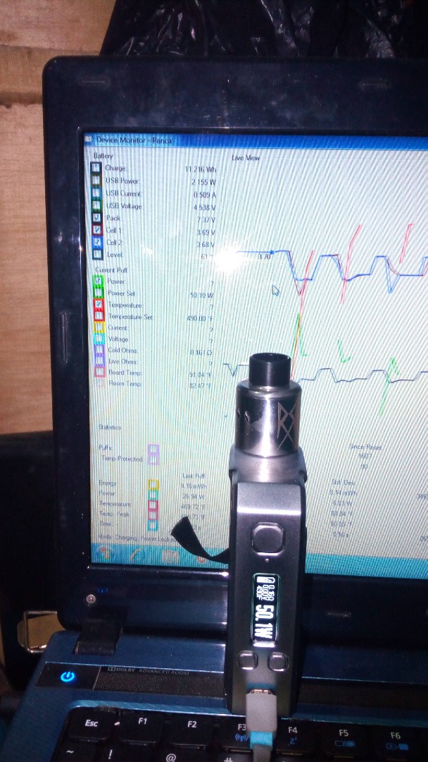

Spector NS5 RD Posted February 8, 2017 Report Posted February 8, 2017 Panca said: This is when " shorted "do you not have cells in the Therion when connected to EScribe? Device Monitor is showing 0 volts for both cells........... put both cells back in and take another screenshot of DM.what version firmware are you running?

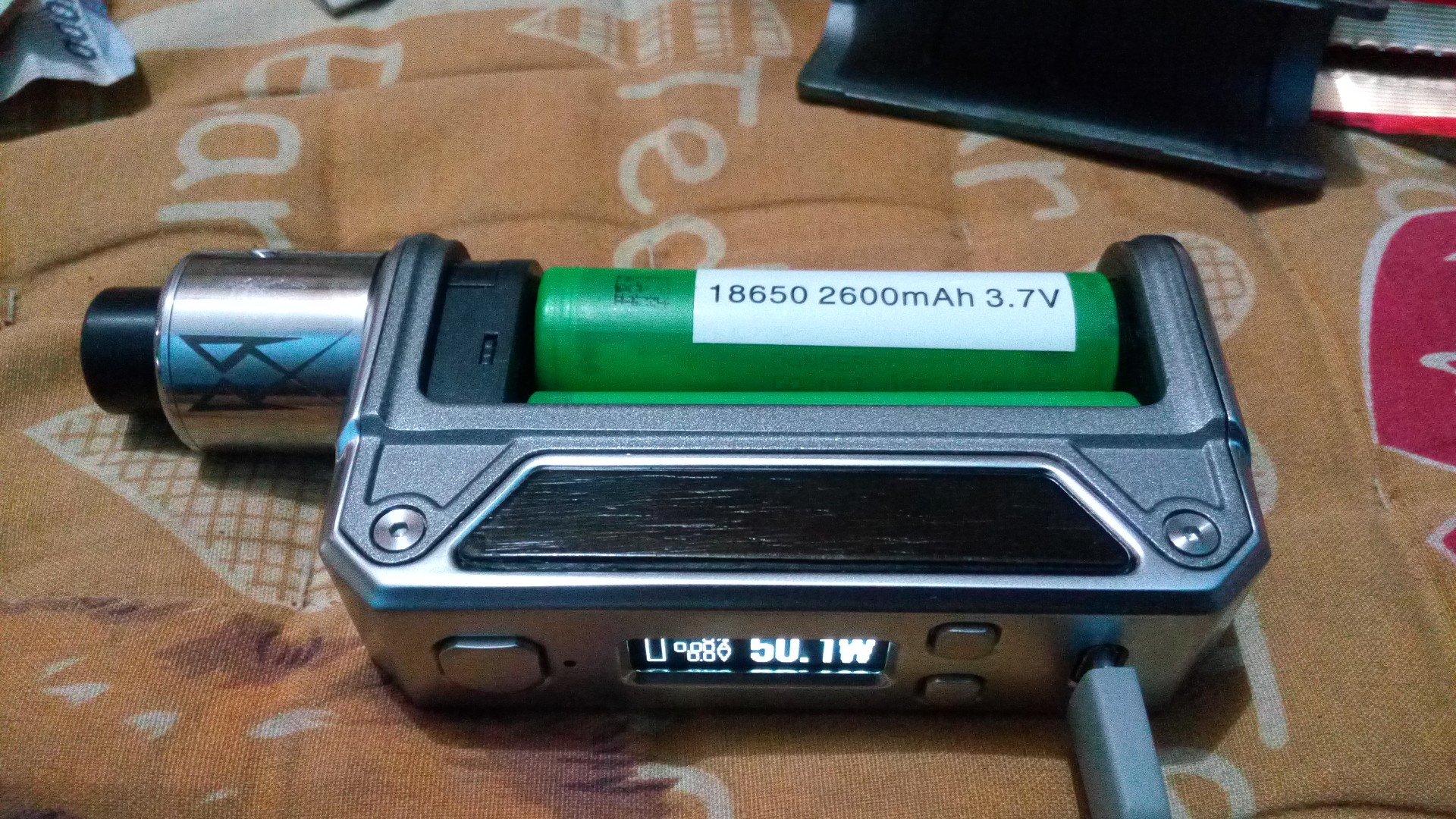

Panca Posted February 8, 2017 Report Posted February 8, 2017 ChunkyButt200 said:do you not have cells in the Therion when connected to EScribe? Device Monitor is showing 0 volts for both cells........... put both cells back in and take another screenshot of DM.what version firmware are you running? Im use sony vtc5 on it, and if standbye mode more than 1 hour is 0 all in the display, even at escribe I have 2 firmwire, 1 is copy from other therion 133 ( normal ) 2 is im using now But still same if i use other therion 133 firmwire
Spector NS5 RD Posted February 8, 2017 Report Posted February 8, 2017 Panca said: Im use sony vtc5 on it, and if standbye mode more than 1 hour is 0 all in the display, even at escribe I have 2 firmwire, 1 is copy from other therion 133 ( normal ) 2 is im using now But still same if i use other therion 133 firmwireit looks as if your cells are not making connection to the DNA board. can you try different cells? it's possible some wires are broken or bad solder joints. can you contact the vendor and ask about a return? other than that, my next suggestion is to take it apart and look around inside for broken wires. this is only if the vendor will not help you and/or shipping costs are very expensive to ship the device to get it repaired by Lost Vape or Evolv. but contact the vendor first. then contact Lost Vape's warranty repair center (link located in my signature at the bottom of this post).
Panca Posted February 8, 2017 Report Posted February 8, 2017 ChunkyButt200 said:it looks as if your cells are not making connection to the DNA board. can you try different cells? it's possible some wires are broken or bad solder joints. can you contact the vendor and ask about a return? other than that, my next suggestion is to take it apart and look around inside for broken wires. this is only if the vendor will not help you and/or shipping costs are very expensive to ship the device to get it repaired by Lost Vape or Evolv. but contact the vendor first. then contact Lost Vape's warranty repair center (link located in my signature at the bottom of this post). Im use lg hg2 and vtc 5, and have same problem, tonight im open my theri, and i test a wire with multitester , all is good, no burning part component, im contact lostavape repair centre about 2 day ago and dont get answer btw , they evolv will accept my board to repair or replace ? Cos if i want vape i must pull out the cell and put it on again All is normal if i pull out cell and put in again, but abnormal if standby mord than 1 hour, batree cell all monitoring on escribe , display show charging, ampere and volt, all is normal i can vape Does evolv can help to rma/ replace my therion board ? Cos when i look device information the board program on october 15, 2016
Spector NS5 RD Posted February 8, 2017 Report Posted February 8, 2017 Panca said: Im use lg hg2 and vtc 5, and have same problem, tonight im open my theri, and i test a wire with multitester , all is good, no burning part component, im contact lostavape repair centre about 2 day ago and dont get answer btw , they evolv will accept my board to repair or replace ? Cos if i want vape i must pull out the cell and put it on again All is normal if i pull out cell and put in again, but abnormal if standby mord than 1 hour, batree cell all monitoring on escribe , display show charging, ampere and volt, all is normal i can vape Does evolv can help to rma/ replace my therion board ? Cos when i look device information the board program on october 15, 2016 if you're handy with a soldering iron you can send evolv the board only and they'll replace it since it's within the one year warranty. This is the fastest way, IMO, to get your Therion back up and running. Maybe wait a few more days for a response from Lost Vape's repair center before de-soldering anything. Up to you........
