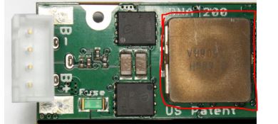

lawtran Posted March 3, 2017 Author Report Posted March 3, 2017 Hi buddy! My dna200 drop down this inductor, someone please tell me what is that and could my device working with out this ( in red square) Thank alot ! have a nice day
Spector NS5 RD Posted March 3, 2017 Report Posted March 3, 2017 lawtran said:Hi buddy! My dna200 drop down this inductor, someone please tell me what is that and could my device working with out this ( in red square) Thank alot ! have a nice dayyou device will still work with out that in place. except, you're putting more strain on the one next to it. both inductors work together to share the load and provide power to the atomizer. i would RMA the board or device.
