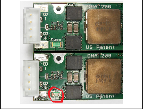

lawtran Posted March 7, 2017 Author Report Share Posted March 7, 2017 Hi all! I need help please!! I try to build my dna200, everything will working fine only when i hate wrong way(+ -> - and - -> +) the cable between battery and mainboard. Afterthat, my put on my battery but of course no working. I fond this, and try to hate the cable correct way again. Now my device can't start up. He can wake up only when i connect to my computer. If i plug off from my computer, my dna switch off. On Escribe, my battery charging nomarlly,So what should i do now ?This device is very important to me cause it a gift. Please help me Here a picture of my monitor device . Battery working fine .Thank alot Link to comment Share on other sites More sharing options...
giz_60 Posted March 7, 2017 Report Share Posted March 7, 2017 Did you blow the on-board fuse?Edit: The DNA 200 doesn't have reverse battery polarity protection, so probably blew the fuse when wired backwards... Link to comment Share on other sites More sharing options...
lawtran Posted March 7, 2017 Author Report Share Posted March 7, 2017 Yes, it looking like you pictureSO have any way to fix it. Could i remove this inductor and connect them directly Link to comment Share on other sites More sharing options...
giz_60 Posted March 7, 2017 Report Share Posted March 7, 2017 You don't want to connect them directly because that is protecting the batteries & board from short circuits...if you have enough room, you can wire in a mini automotive 25 amp fuse...and tuck it away somewhere inside the mod... Link to comment Share on other sites More sharing options...
lawtran Posted March 8, 2017 Author Report Share Posted March 8, 2017 @giz_60 : Thank you for your help! I tried creat another fuse by my self and replace to older and my dna working properly! Link to comment Share on other sites More sharing options...
