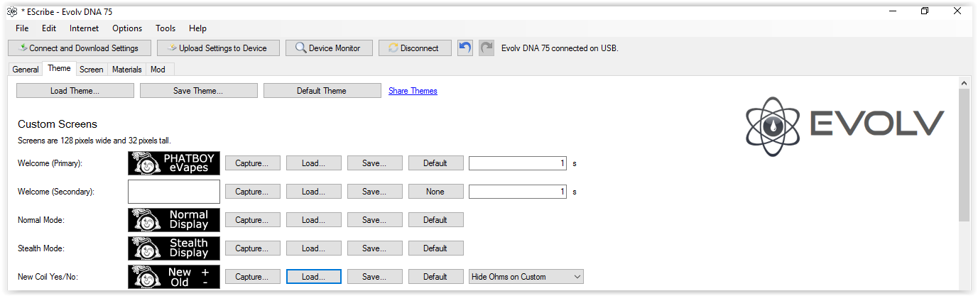

Deezel Posted March 7, 2017 Author Report Posted March 7, 2017 1st image Before i upload to device2nd image after it loads to deviceI am using Photoshop cs5 and saving images as .png 128px x 32px
giz_60 Posted March 7, 2017 Report Posted March 7, 2017 You can try this little program...works well & the images transfer well.... DNA200ThemeImageGenV1.1.02.zip
giz_60 Posted March 7, 2017 Report Posted March 7, 2017 Hey, I checked out your images enlarged & the reason you are having these issues is because every where the images are being distorted, there is gray...almost like a shadow...the screen is monochrome
Deezel Posted March 8, 2017 Author Report Posted March 8, 2017 Hiya giz_60,First off thanks so much for the advice.What i did seem to manage was instead of going with white on black bg.. i went black on white bg.. seemed to make things look as they should.Will see if i can get the images cleaned up without the "grayish" bits.CheersDeez
