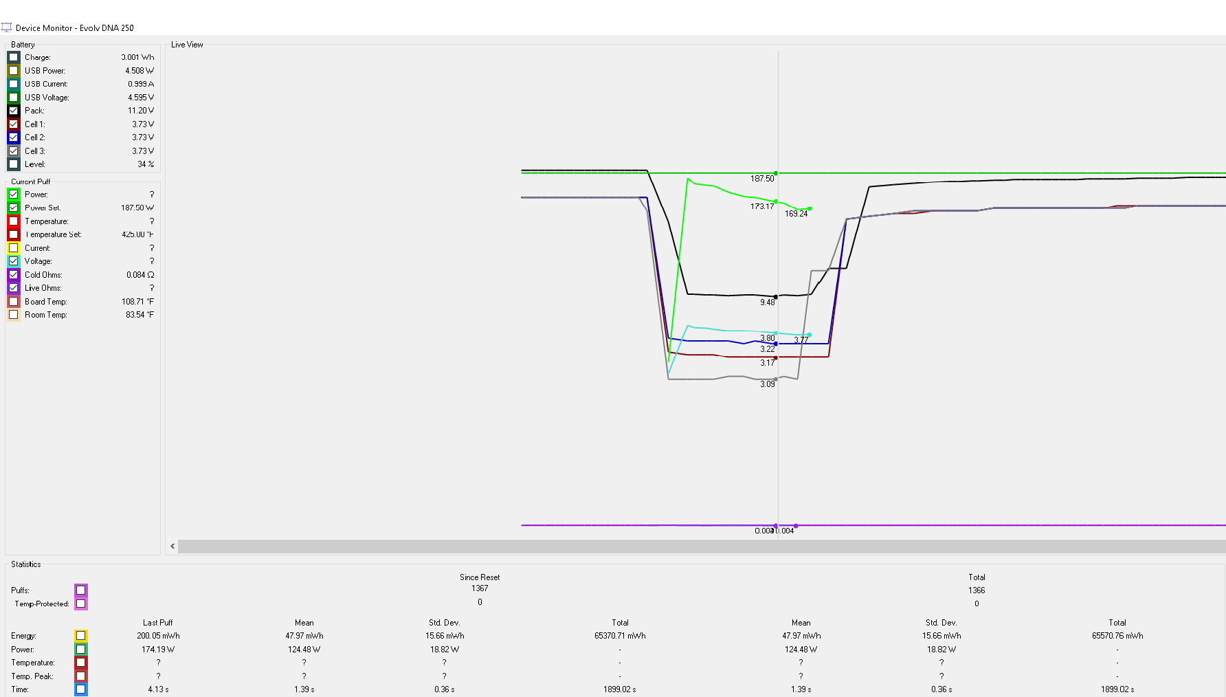

Spector NS5 RD Posted April 10, 2017 Report Posted April 10, 2017 sounds like a classic intermittent connection. the board is receiving just enough power to boot up but when the fire button is pressed, the load is to great and breaks the connection or is asking too much from a weak connection, causing the board to reset. open Escribe's device monitor and look at the pack and each one of the cell voltages. what do they do when firing an atty? post the screenshot of DM while firing a build or at least trying to.
Mourakue Posted April 10, 2017 Author Report Posted April 10, 2017 When firing, all cell voltages drop to 3.17, 3.23, and 3.09 respectively. It's only able to provide 165ish watts throughout firing, even though 187.5 is being requested (easily doable on a .084 build). Let me know if I can provide anymore info, or if there is a fix for this. Cheers
Spector NS5 RD Posted April 10, 2017 Report Posted April 10, 2017 i'm guessing your "cell soft cutoff" is set to 3.09? your not getting the power you requested because the board can not draw the necessary power from the cells. therefore it reduces the power it can draw down to the point of your CSC value. it will not go past your CSC value. i would use 2.75v for 18650's. what kind of cells are you using? is this sporadic rebooting or every time you press the fire button? reboots even with freshly charged cells or charge level doesn't matter, reboots no matter what?

Spector NS5 RD Posted April 10, 2017 Report Posted April 10, 2017 what is you CSC set to in EScribe? if it's 3.09v, knock it down to 2.7v and upload to device.does the issue of wattage decreasing improve (even a little improvement will tell me if it's the battery door) if you put a good amount of pressure on the battery door while firing? also your cells need to be charged, they're almost at the end.
Mourakue Posted April 10, 2017 Author Report Posted April 10, 2017 That was on freshly charged cells... It isn't the battery door, I already made sure that wasn't it. Trying CSC setting now, it was at 3.09.Edit: Thought that fixed it, I was able to hit it a couple times, but it is still sporadically shutting off. A lot.
