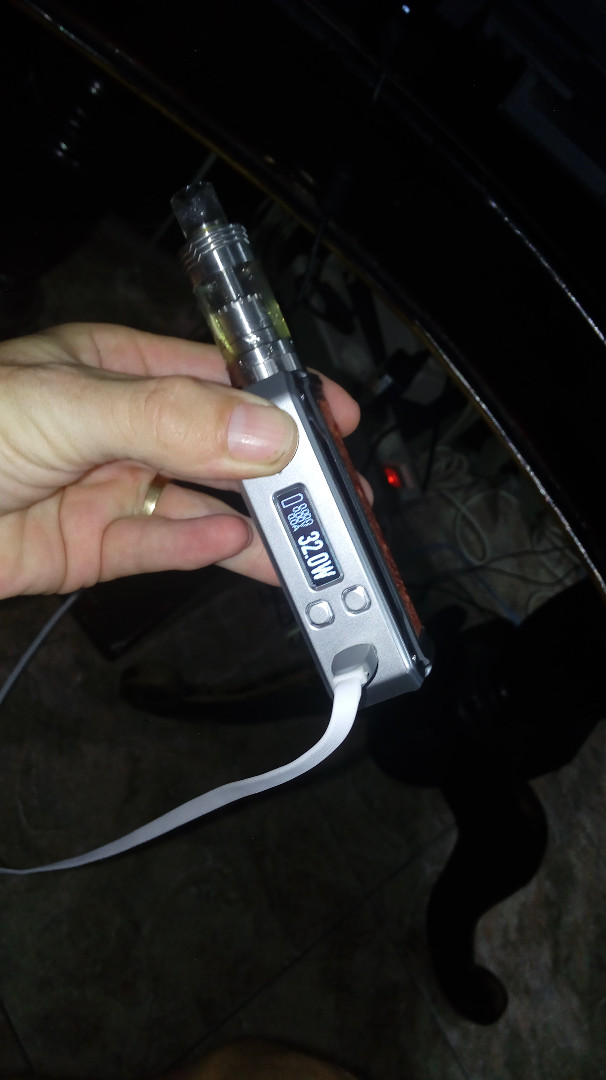

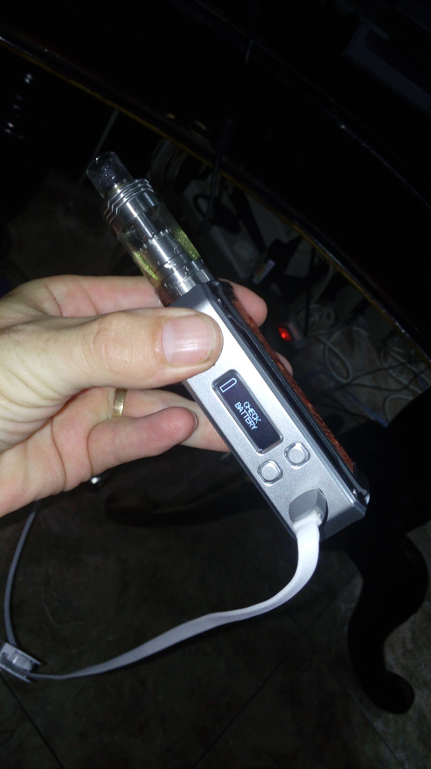

Oli4 Posted April 17, 2017 Author Report Share Posted April 17, 2017 Just received my new Therion 166 DNA 250 today. After charging the batteries and updating the software, the batteries went dead. Every time I hit the fire button I got the check batteries message.Went to the Vape shop around the corner and the guy checked with batteries from his own MOD and same message.Any advise?Thank sOlivier Link to comment Share on other sites More sharing options...
dwcraig1 Posted April 17, 2017 Report Share Posted April 17, 2017 Could be it is now set for 3 cells instead of 2. Check that in Escribe under the mod tab, be sure to upload setting for change to take place.Under "options" be sure "manufacturer" is selected or you won't see your battery settings.Let us know what you find. 1 Link to comment Share on other sites More sharing options...
Oli4 Posted April 17, 2017 Author Report Share Posted April 17, 2017 dwcraig1,You sir are a genius! It works. Thanks for your help!Olivier Link to comment Share on other sites More sharing options...
