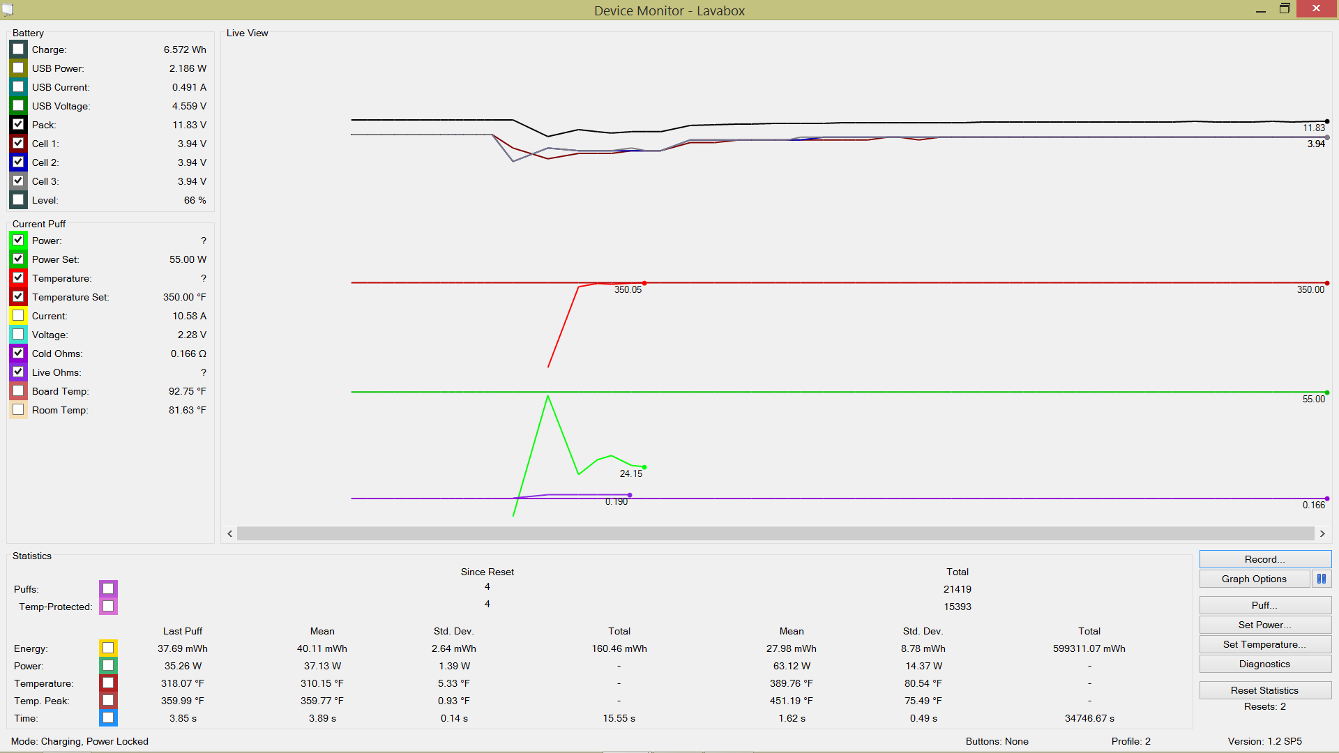

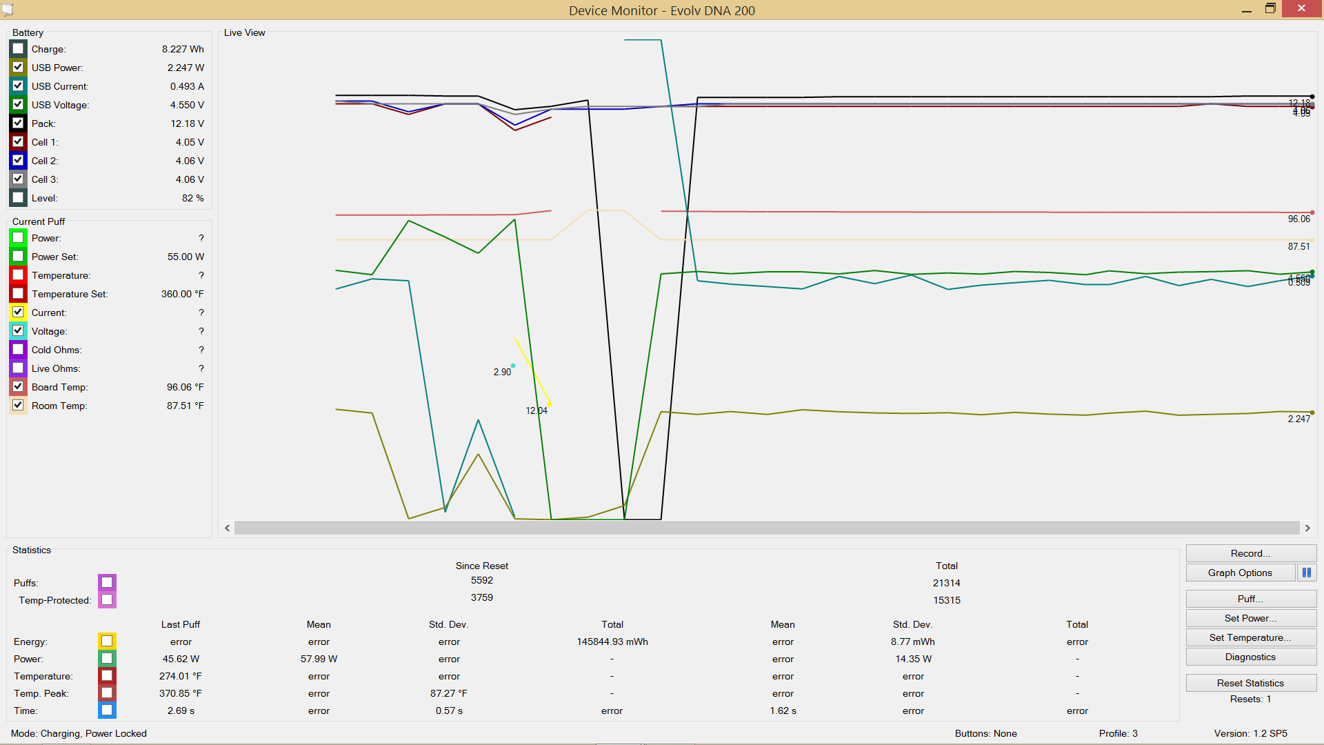

giz_60 Posted April 18, 2017 Report Posted April 18, 2017 Nicholas20 said:Can anyone tell me what's wrong when everytimes I screw back my atty , ohm will getting higher and temp protected immediately when I hit the fire . I'm using ss316L 24g , please help Sounds like you mod may be dropping out of TC into Power mode...can you post a screenshot of the 'Mod' tab in Escribe & Device Monitor while firing with the following boxes checked..Power, Power Set, Temperature, Temperature Set, Cold Ohms, Live Ohms
Nicholas20 Posted April 18, 2017 Report Posted April 18, 2017 done re-post, now the ohm is right. when i unscrew the atty and screw it back , ohm became 0.27 which is not accurate. whats wrong :'(
giz_60 Posted April 18, 2017 Report Posted April 18, 2017 You unchecked all the boxes requested....please check the boxes requested & uncheck all the others & re-post...
