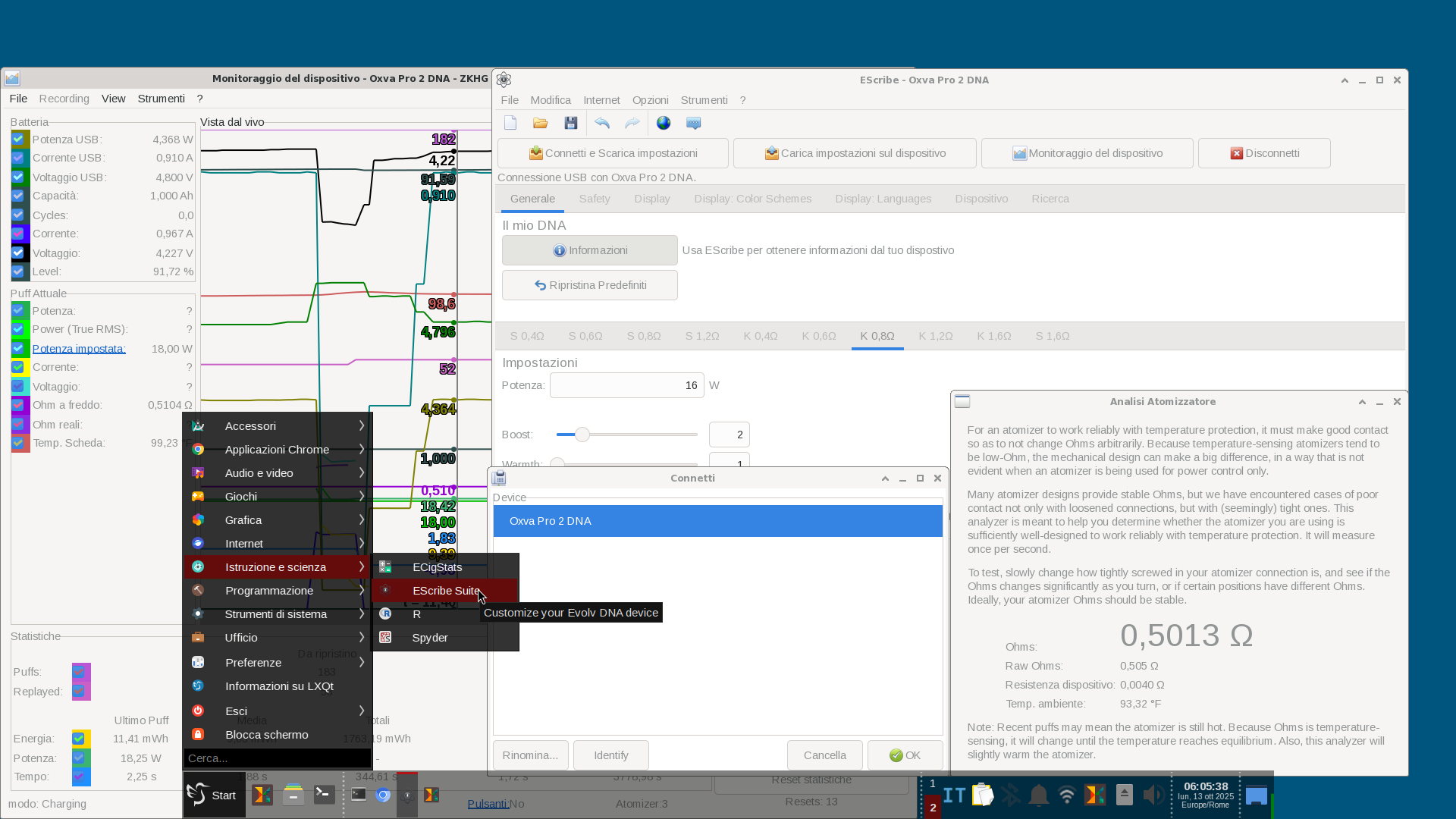

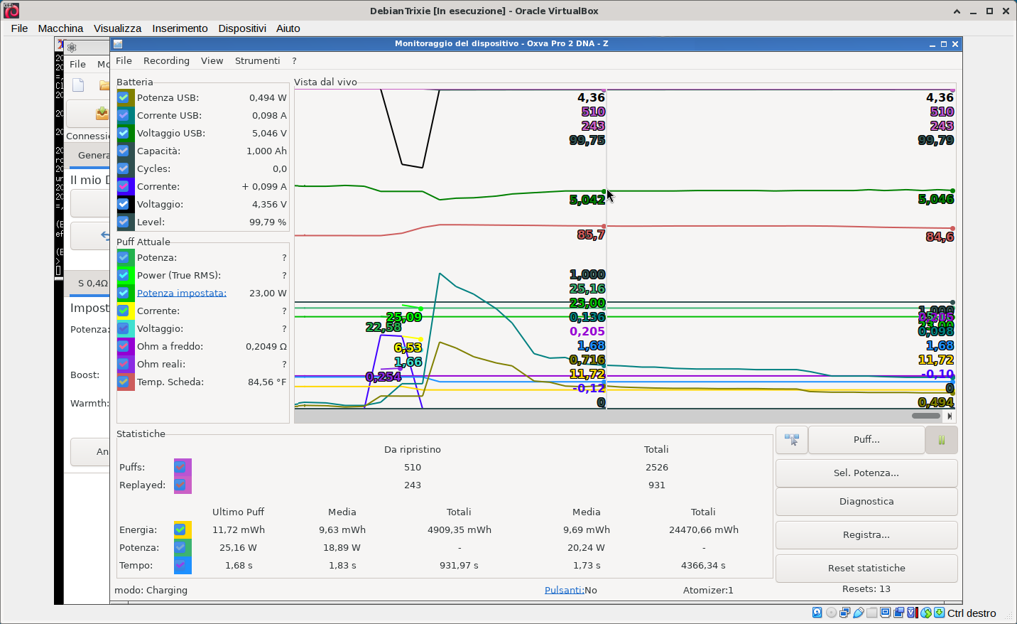

As a side note, I succesfully installed Escribe Suite SP71 (INT) on a fresh paravirtualized Debian trixie (Oracle Virtualbox 7.2) with a base system and a minimal X window manager (openbox)
# apt install xorg openbox obconf xdg-utils mono-complete
libgtk-3-bin and libgtk-3-0t64 are dependencies of package obconf (openbox's simple preferences manager) so automatically installed 🙂
