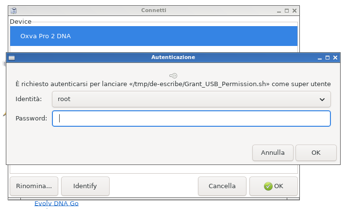

  2. Hi James, The fallback pkexec textual authentication agent doesn't work (see log and a possible reason at the end) so I reverted to a quick bash onliner. Most linux desktop environments (GNOME, KDE, LXQT, Mate etc.) have their own graphical authentication user agent preinstalled so EScribe Suite perfectly fits with them. In my reported minimal configuration (EScribe Suite is started from a controlling terminal such as xterm), openbox could work too in this way but there are some tweaks to do before the Openbox X Session is started # apt install pkexec lxpolkit $ mkdir -p $HOME/.config/openbox $ echo "lxpolkit &" > $HOME/.config/openbox/autostart $ chmod +x $HOME/.config/openbox/autostart >>> Start Openbox X Session $ startx Here is the log of pkexec's textual authentication fallback agent (EScribe Suite is started from xterm with only pkexec package installed, no lxpolkit) ---------------------------------- < cut here > --------------------------------- ==== AUTHENTICATING FOR org.freedesktop.policykit.exec ==== Authentication is needed to run `/tmp/de-escribe/Grant_USB_Permission.sh' as the super user Authenticating as: root Password: ** (process:1904): WARNING **: 04:55:50.418: Got unexpected EOF while reading from controlling terminal. ==== AUTHENTICATION FAILED ==== Error executing command as another user: Not authorized This incident has been reported. ---------------------------------- < end cut > ---------------------------------- I suspect EScribe should wait pkexec process to get root password from controlling terminal (user has to manually enter it in terminal to be authenticated by polkit) before executing Grant_USB_Permission.sh script I hope this could help you. Bye Alessandro
