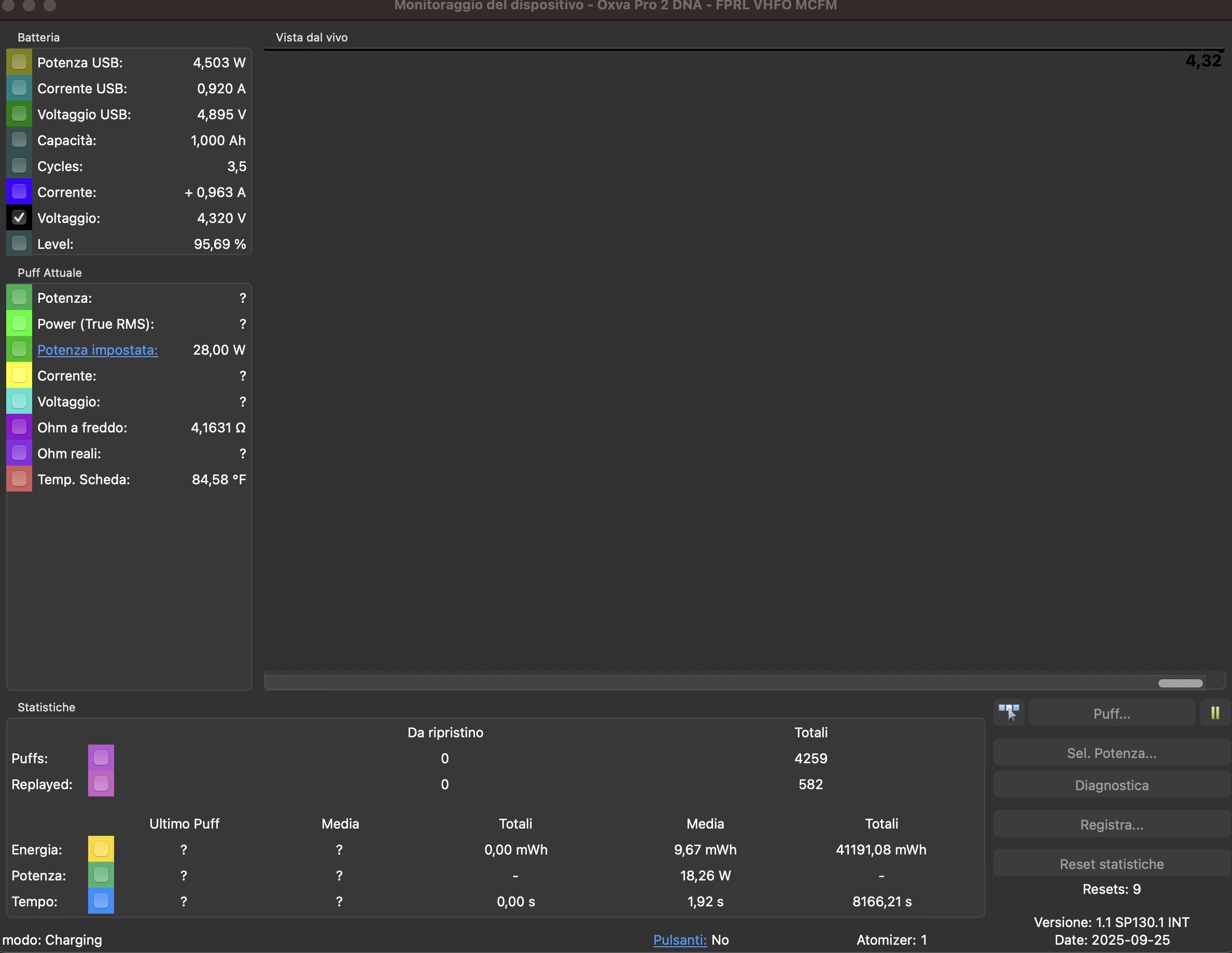

  6. 5V 2A . is an original charger from another pod mod (KIWI) and i use for all the pod mod i have (including 2 more xlim 2 no DNA ) and in few years i never had any problems with the other device .
  7. If you click the icon to the left of "Puff" to bring up the button simulator, and click Fire, does the screen turn on? That'd tell us if there's an issue with the physical buttons. aswer: not Also, before you start Device Monitor (make sure it is closed), go to Help->About in EScribe and left click the logo seven times. This will close the window and put the program into Debug mode. Then, start Device Monitor. answer: Done If you do this, click the "Debug" group on the left to bring it up. What does "Buttons" say? answer: 0 buttons As to 4.16 Ohms, PWM devices like Oxva can't read over 4 Ohm. 4.16 Ohm is probably the 4 Ohms limit with calibration applied. This almost certainly means it's not reading the pod resistance, or the connection has become very bad, but clearly it's detecting that there _is_ a connection, or it wouldn't have tried to measure it at all.
  8. Hello, thanks for your answer , in attachment the screenshot of Device Monitor .4,16 ohm of resistance looks really stange and not i cant fire with puff function in escribe: when i try appear one message "check atomizer"
  9. i have the same problem with my oxva xlim 2 pro dna, after i put the device in charge (with the same charger that i used in the past and that i used for all my oxva device) the mod dont switch on. the strange stuff is that is recognize from escribe ....
