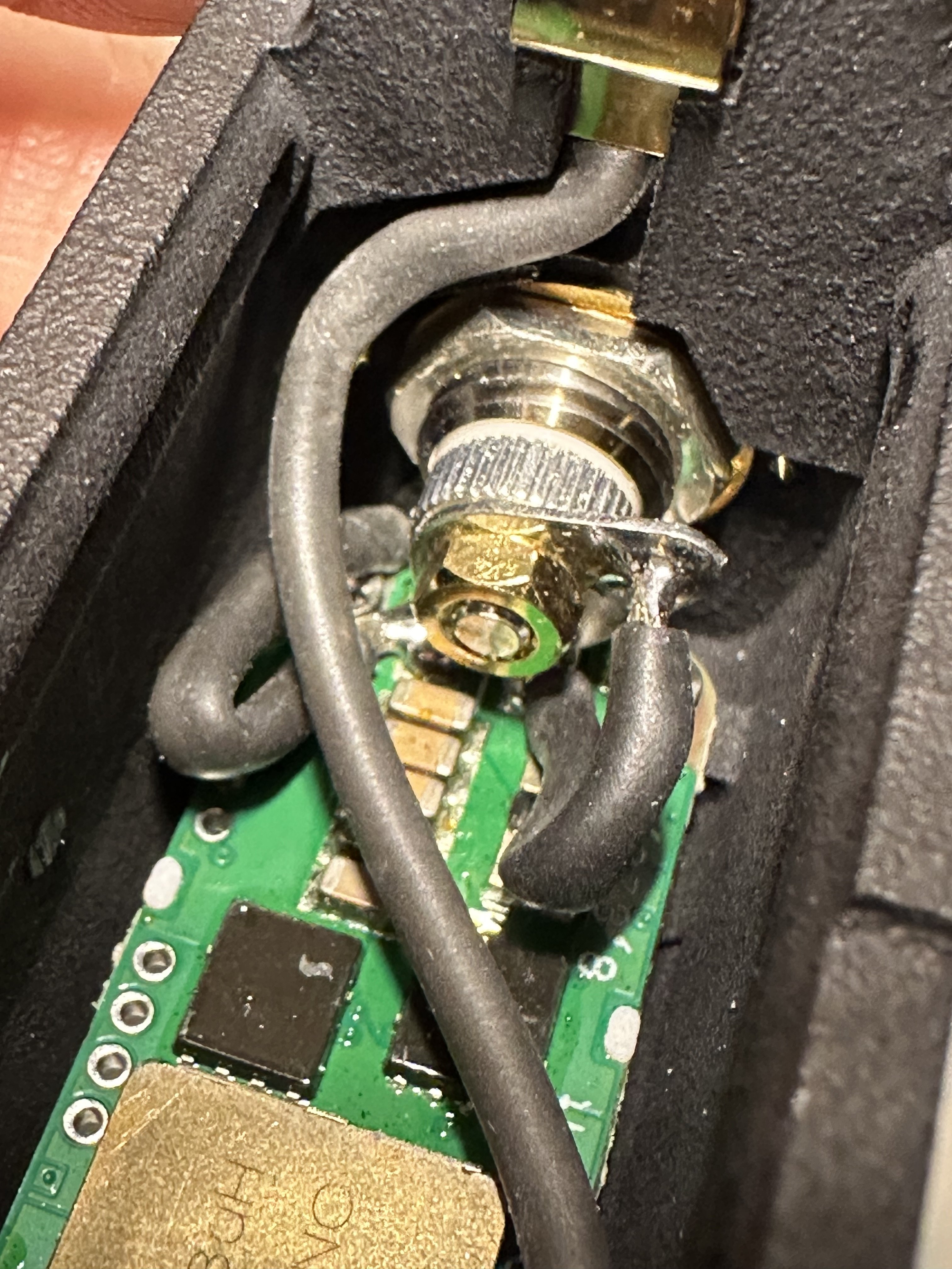

  4. btw do you know which one is the board temperature thermistor? or are there more thermistor for temperature measurement?
  5. Thank you for checking! For me it looks kind of similar to mine..

  7. This board looks different than the one from dna 100c? It has only one of this inductors. And the one get's really warm. Does anyone know where is the temperature sensor for the error: "chip too hot"?
