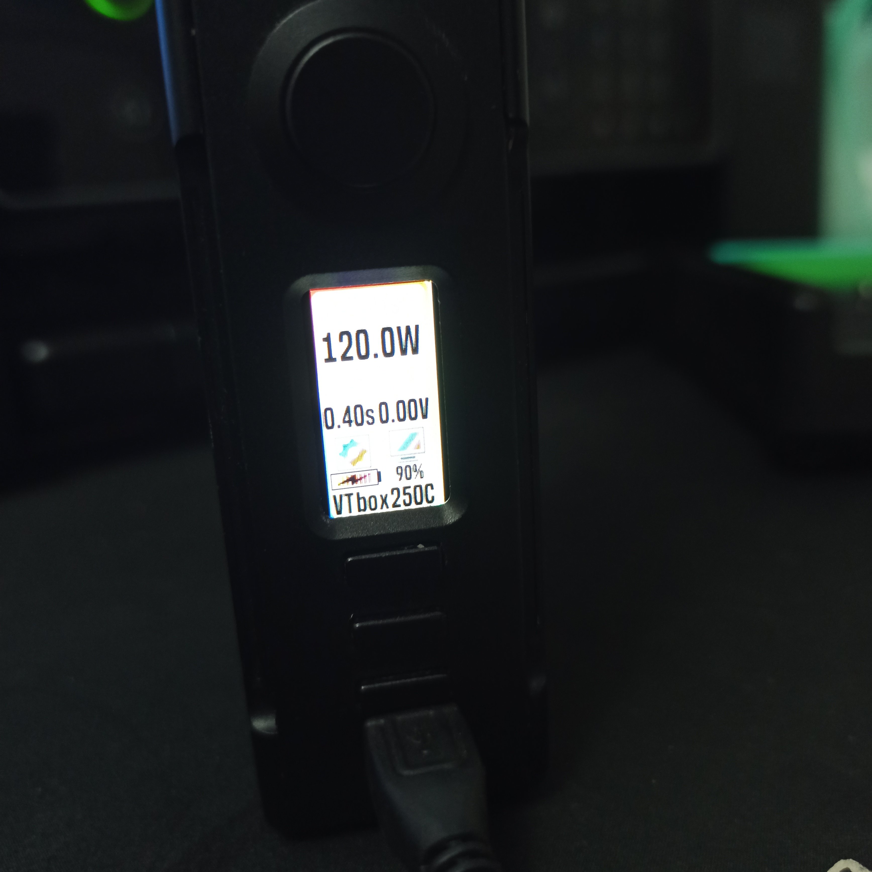

Update. The screen was successfully replaced, but i have the inverted color issue. I tried to find a solution but all the possible options doesn't solve anything. Tried to find the screen options in "mechanical" but even installing the oldest firmware and then the others non screen option appears in mechanical tab. Any help? The background should be black, but there's no way even with the default theme.
evolv specs are for sure like you say, probably brands choose different parts. On the left of the picture a display for a Lost Vape Dna100c. On the right the VTbox250c damaged display. I will try to use the 0,96 instead of the 0,9, but if someone has found the right one i still wait for help.
