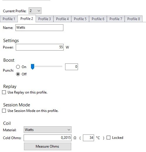

  3. Ok thx for your advice, i think low glow dry burn and turn down the watt should do the trick
  4. Ok like this ? And about turn down the watts you mean while vaping or wicking cotton ? I already try my rda on my friend mod but not problem, anyway his mod is rincoe manto pro not an dna device. About material i dont really know but this is the description "Handcrafted Premium Coils Made with @twistedmesses Wire N80 .. inner wire on all series come with 27/28/29/30/32 Awg and 36/37/38 Awg for outer wire" also thx for replying
