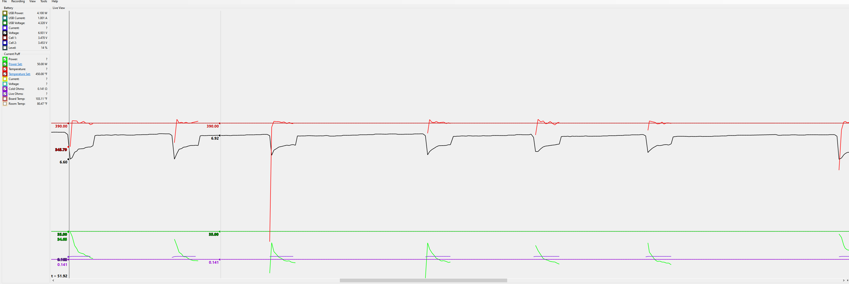

Yeah I've tried all the way down and like this. Found it as idea on another fourm where he called it out specifically on these Wotofo Mesh coils (although it was the original ones that were for the Profile 1 not the Profile 1.5 spec SUS316L coils I have. It will if I don't just keep hitting the puff command. That first one does on this screenshot. I'm not as much concerned on the "dread mesh dry hit" used to use the Profile PS with dual mesh and didn't like it when it happened but it didn't scar me for life either. Yeah its weird alright. Would figure the temp reading would start lower than it does. 2-3 secs in between puffs I understand won't come to room, but it doesn't drop much at all.

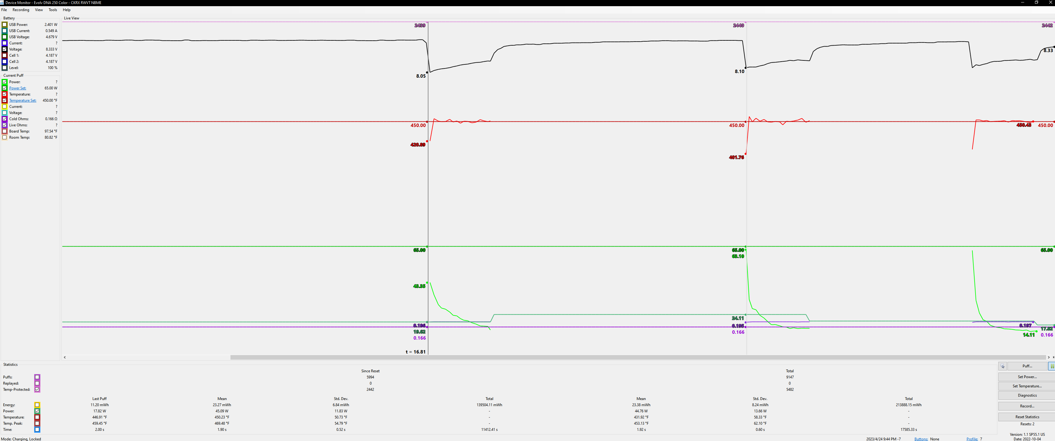

Alright, well I remembered when building that I had swapped out the post screws (for when you wanna build wires on the deck) and that was when I got an accurate read. So I pulled out all the screws for the wires and checked em. Guess 2 of the 8 screws were just a tad shorter than the rest. Cause I just a coil to read at 0.15 when I first inserted. Did a pre-glow, wicked etc. Now its reading at 0.141 stable (never had a reading lower than 0.15 so I"m not mad at all). I also inserted the coil so a bit of the tab is showing as well. will include picture after this post since its on my phone. Here's the puffs. Can record more after the juice soaks a bit more. edit: how my coil is inserted

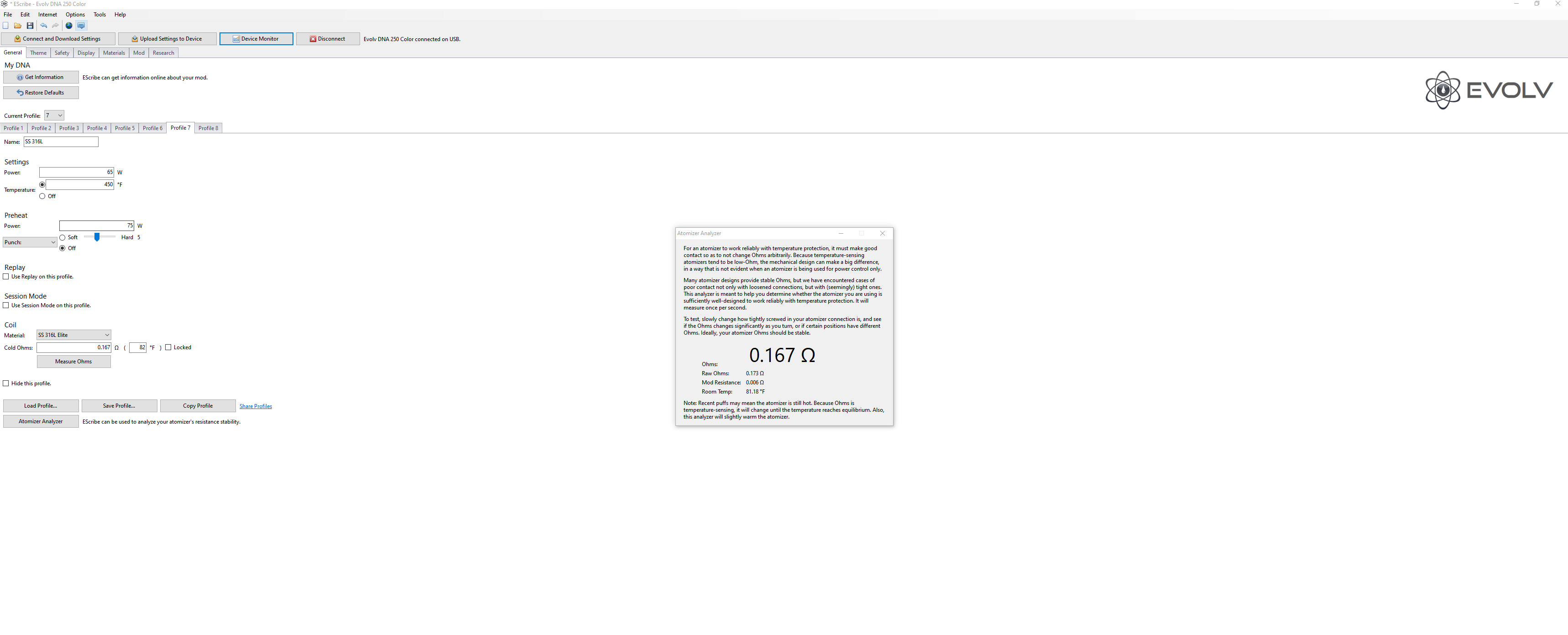

Hey Everyone, Been lurking long enough and went back and forth with support as well on how in the hell to make this Thelema and Wotofo Profile X work in TC mode properly. Had some successes mostly frustrations though. Figured I'd bring it up to the larger community and see if we can nail this one in hopes to also have it available easily for future people. Setup: Thelema 250c Wotofo Profile X (this ends up being the profile 1.5 coils/mesh) Wotofo SUS316L Coils (Ohms ~0.15) Using the stock 316 profile and downloaded a 316L profile from Steam Engine Done Case Analyzer correctly (which fixed the cold/ambient temp read a ton was off initially by +- 20 degrees, usually up) Already changed internal mod resistance from stock value of 0.004 to 0.006 (this was at the recommendation of support, lovely gentleman cause I would have told me to just give up and leave me alone) Have tried hard setting ohms, changing internal resistance to get to the ~0.15 ohms (usually reads about 2.2-2.4 above at the stock internal res of 0.004, Have it right now reading 0.166 stable no fluctuation with atomizer analyzer at 0.006 internal res, but vapor production is relatively non-existent until we get up to the 480+ range which just can't be right), but I haven't tried chucking it in a blender but I'm getting close. Whenever I get a cold reading its letting it cool, or when the coil is freshly bent to shape and inserted (so it hasn't been heated and should thus have a correct cold reading). Have had some luck a few times but not consistent enough to actually enjoy the beauty of TC yet. Adding images cause ya'll will ask for em
