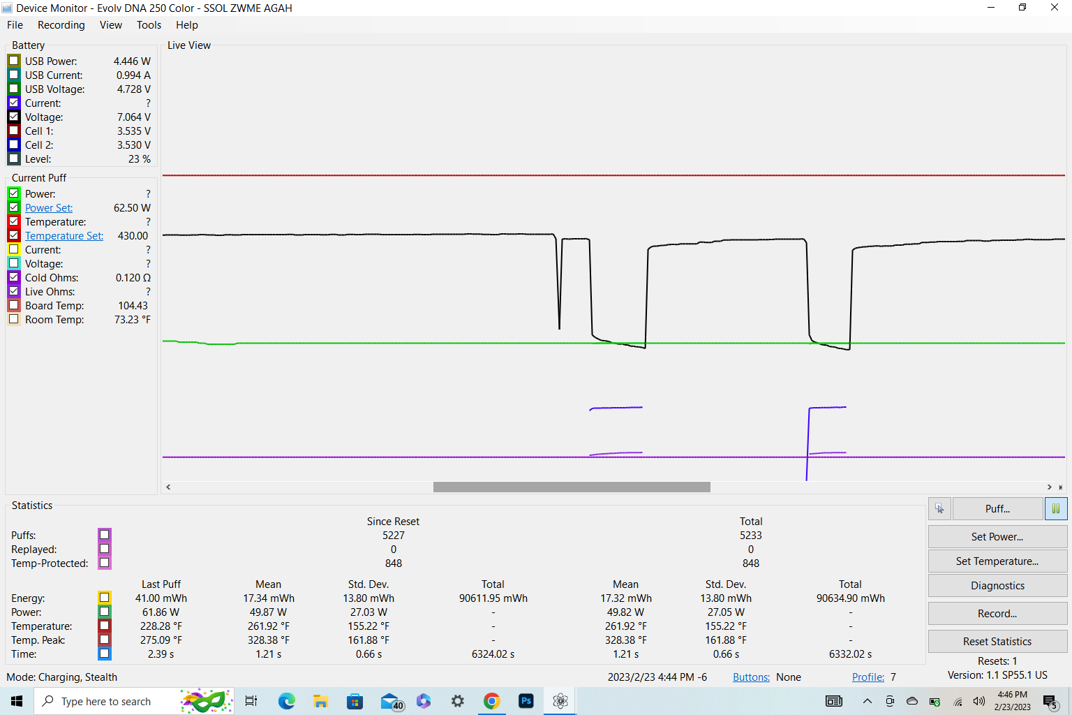

  4. I have had problems with really slow to vape coils due to their density, but after looking at device monitor i have come to the conclusion that replay is better than boost, fire your coil till it is warm and then take the desired hit, once you do that click replay! Set the warmth to what you like, and replay will throttle the wattage way above your desired wattage to get it warm as it was at the beginning of your hit then it will lower the watts way below as you continue to drag, it definitely is a game winner when it comes to high heat capacity coils! and the odd thing is i would reccomend in the mod settings clicking allow dubious coils, because replay although needing a tc coil does not actually use tempurature at all it only uses wattage. All and all, replay is your friend if you have large coils or dense builds (also make sure your batteries cdr and volts can handle whatever watts it throttles to)
  5. but for sure thank you so much for the help with all of the other stuff, you helped me know how to read device monitor and what to change to get a better hit for my rta builds, i appreciate that, thanks when i came on here i did not expect to get such great help that quick so thanks

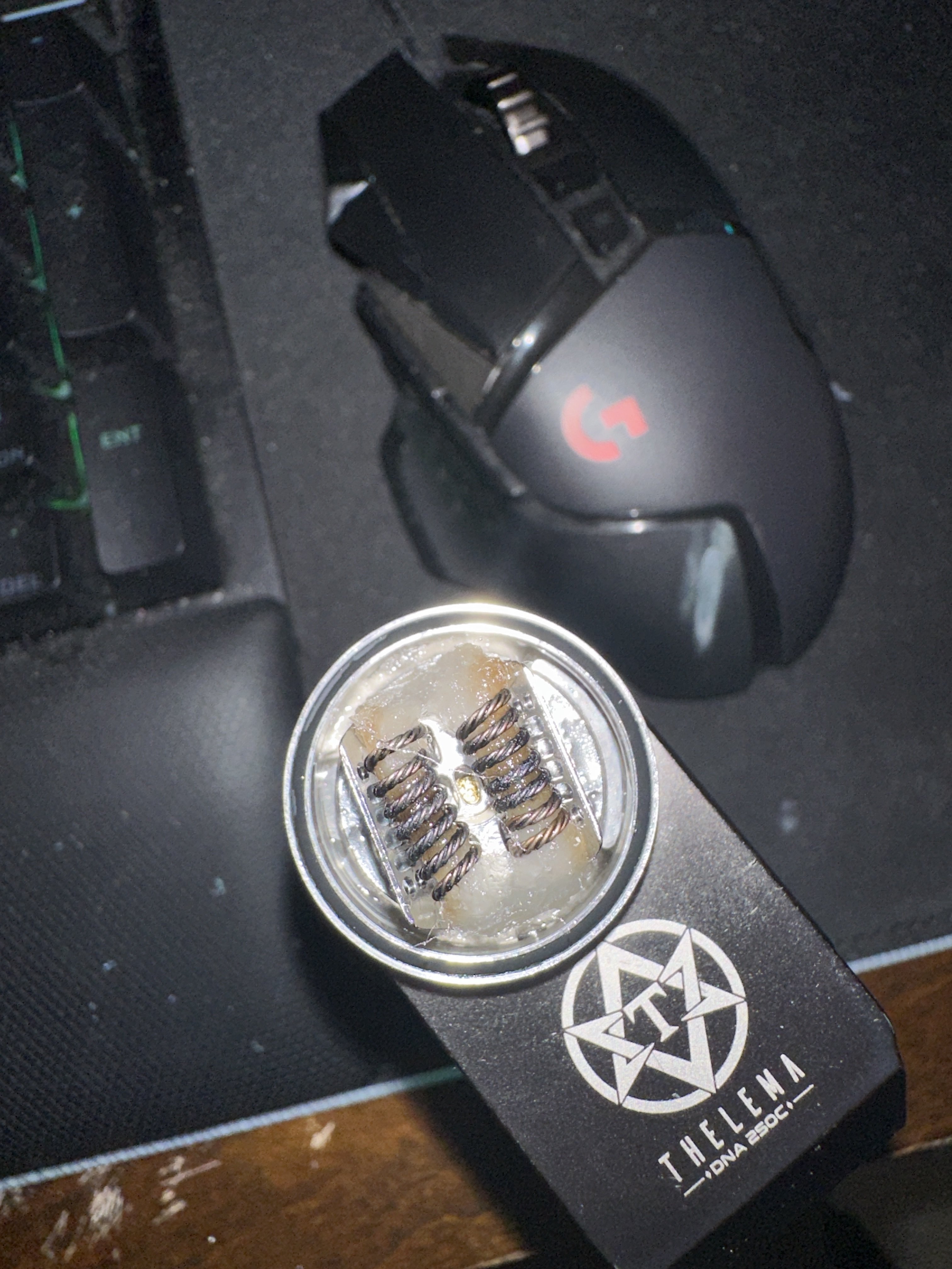

  6. my bad brother i forgot i forgot, this is a 4 strand twist fuck i am stupid as shit i am so sorry for waisting your time, hey but i am pretty proud of my theme i made, i would definitely like to know if a seasoned vaper like you would grade it on a 1-10 scale
  7. it is quite literally a perfect build it isn't even changing from .111 it is constant for minutes on end
  8. nope still definitely at .111-.112 ohms constant and raw ohms is .115
  9. i'll check right now, it seemed to have been working recently and last night i was just adding a working replay function to my theme. seems like the only type of vape that gives me a good hit is replay as of right now lol but yes let me check real quick
  10. nevermind, idk what happened but i just reset the ohms and they were the same yet it stopped saying it lol idk
  11. well damn now i am getting a throttling message smh idk what is wrong with either this mod or atty
  12. here are the pictures after i got an identical tank just a new one with a fixed 510 pin, it is way more stable, and way faster time and idk if there would be any things that might help with showing what could be up with the ohms of the coil, first is watt with boost then with no boost, second is tc with no preheat
  13. it is showing up as a constant .111-.112 perfect not changing at all
