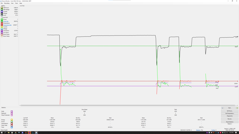

i had the same coil as before, and that was the last coil to check, now i m on wattage and clapton atm till my ss 316 arrives. i did nothing besides restarting the device to default and installing the theme again, had the same coil, same settings but somehow the Watts were not going 24W like before, was dropping to 12-15.. i ll keep you posted after the new wire arrives. Thank you for your time. -

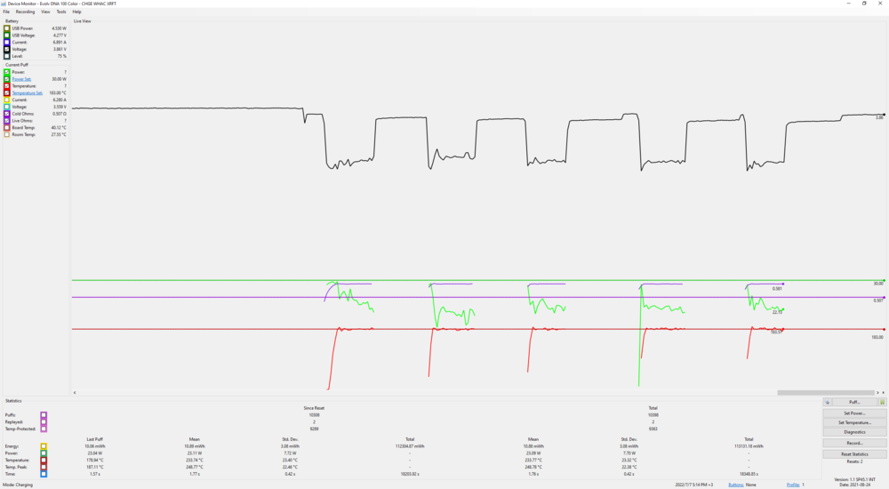

guys, i ve encountered a problem. i ve reseted the device, installed the theme once more and i ve started vaping and found out that it's weird.. then went to device monitor, and i have the same settings as the old profile, my watts won't go beyond 13-15W.. what did i do? or what i did before? -

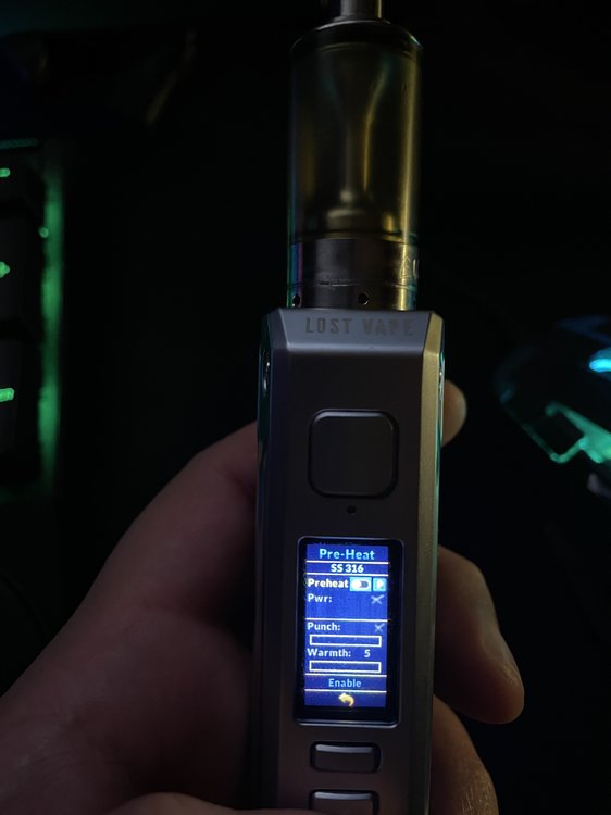

let's say i have SS 316 profile with 220 C and under temp i have wattage which is set to 60W, then in this profile i have a preheat option, it's not a profile, it as an option > so if i enable preheat, does influence the profile? or ignores the profile with temp + wattage and just preheats. alright, i ll go 260C again. yes i did, and felt it was taking longer to heat. maybe just my imagination. also, i saw my battery sometimes ranges from 5-15mwh, what's the optimal discharge? -

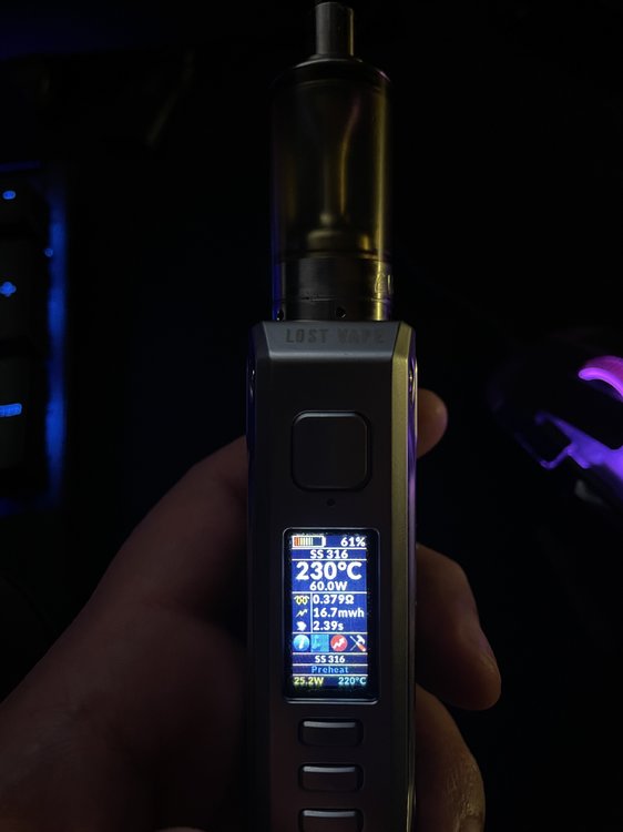

1# if i set 220C + 60W on profile, then go to Preheat (i use hyperion-odin profile theme) i can set there another Wattage + punch level. does this stack with the profile? i saw 220C was safe to not get gunk/little black dots on muji cotton, usually i'd prefer it at 260C but i think it's not safe for SS at that temp. -

i am on MTL conversion evl reaper V3Ti, simple ss316 spaced coil, but the vape is (if i compare to my old mod gen S) something like either 30% of what i ve felt, either this is blowing other notes which i couldn't get with gen S, but i can't get the flavor i had on GenS. -

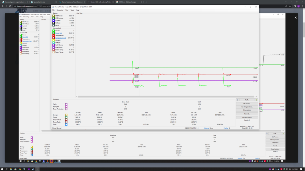

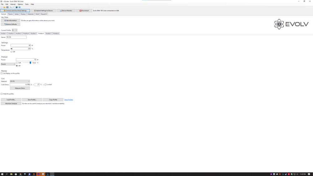

"Can you post 2 screenshots for me. The first being a Device Monitor while firing with the 'Power', 'Power Set', 'Cold Ohm' and 'Live Ohm' checkboxes enabled. The second being the Profile you're using. When you start escribe THAT profile # is shown as 'Current Profile'." yes, it is first dna device. cold ohm you mean first vape after letting it cool down and live ohm, the next vapes after cold? "When not using TC, so straight watts, how many watts are you using for an enjoyable vape?" usually around 18-24W. -
