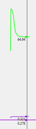

  1. Yup. Seems this was not so much a "cold coil" problem but rather the recently addressed "intermittent issue with output voltage boosting with the screen off." Thanks!

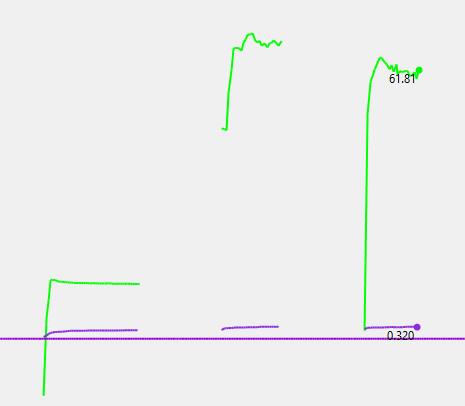

  2. I change that setting to "unlikely" and had the same basic results. Interestingly the second and third puffs had a different power curve than before. I wonder if this means the coil is close enough to the noise floor when warm that the device uses what they call that "noise-resilient" mode. Regardless, I do not believe that explains why the first puff is so power restricted.

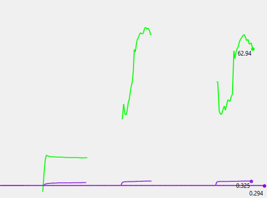

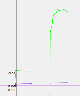

  5. I've got a Lost Vape Hyperion with the 100C and wanted to see if I could use Replay with a UB Pro pod tank coupled with the P3 coil. This coil is 0.3 Ohm SS904L mesh and, according to Lost Vape, should work OK in TC mode. My (limited) understanding is that Replay on the DNA will work as long as the coil has some TC properties. And, using the default theme, the mod will let me save my puff. However, the Replay doesn't seem to work when the coil is cold. The monitor capture below shows where I had a puff at 65 watts that I saved. I paused and let the coil cool down, then puffed again and the board maxed out at 25 watts. An immediate second puff and Replay started doing what it should. Let the coil cool again and took a few more puffs. Same thing. Is this expected behavior with "iffy" coils on Replay? Or is there something I'm doing wrong? Thanks, Gary
