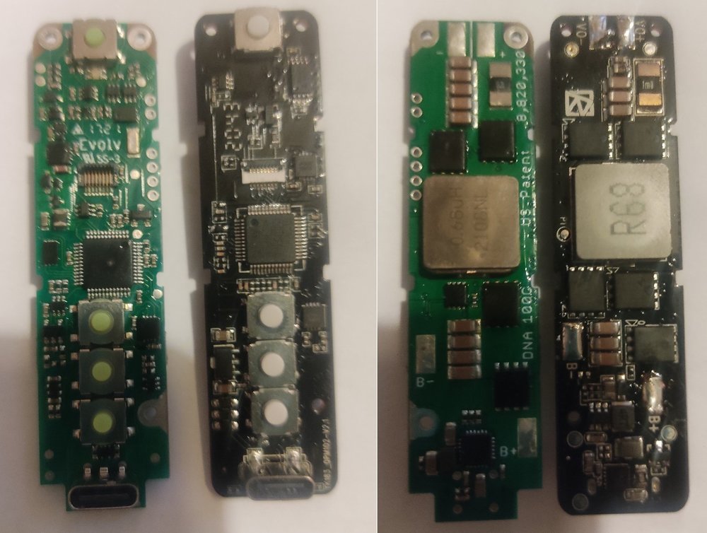

  1. Hi Wayneo, Unfortunately I did not take a picture of the DNA100C in the 'tray' and I did not measure the gauges of the cables. I rebuild the STM32 board back in as I will put Arctic Fox onit and build a nice stabwood mod with the DNA100C. What I could do is open the Ursa again and make a photo of the STM32 board mounted, if that helps.
  2. The Lost Vape Grus can be modified with a DNA75C Board, but the Ursa has the USB port in a lower position than the Grus. So I wondered if the DNA100C Board would fit into a Ursa. To make it short: it does Even the cables do not need any change as the soldering points are nearly 1:1 on the Ursa STM32 board and the DNA100C board. The original Ursa display can be used as well, it needs only 2 adjustments in ESribe: IMHO it is not worth the work as the Ursa STM32 board (Quest) can be flashed with Arctic Fox and get similar functionality than a DNA. But it is 100% doable 😜
