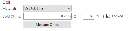

  6. This is what I mean... It's a cold atomizer on a hot mod - so while it reads the ohm's correctly, it thinks that the reading is done at 82F? When the board cools further, will it adjust the ohms of the coil? Or is that not how it all works? If that doesn't explain what I'm trying to ask - Let's say I had two of the same tanks with the same coil installed. I measure the ohms in the morning with both the board and the atty at room temp. It reads .7213 ohms, and 71 F. I vape on it for awhile, and decide to connect the other tank. It reads the same .7213 ohms, but now it says 82F. Will the vape be the same, or is the mod adjusting the vape for ambient temperature? I'm trying to figure out what just went wrong, because I just connected my Kayfun after vaping with my Pioneer, and the flavor is supremely lacking. I didn't let the mod cool, like in the example I listed above.

  8. Do you suggest letting the mod sit for awhile before reading the resistance of new coils (Letting it get to room temp)?. Like if I'm vaping one atty, and I decide to switch to another. Should I wait for the mod to return to room temp, or does it not matter? Also, do you lock your ohms? I was reading the forms and some people say lock it, others say don't.
