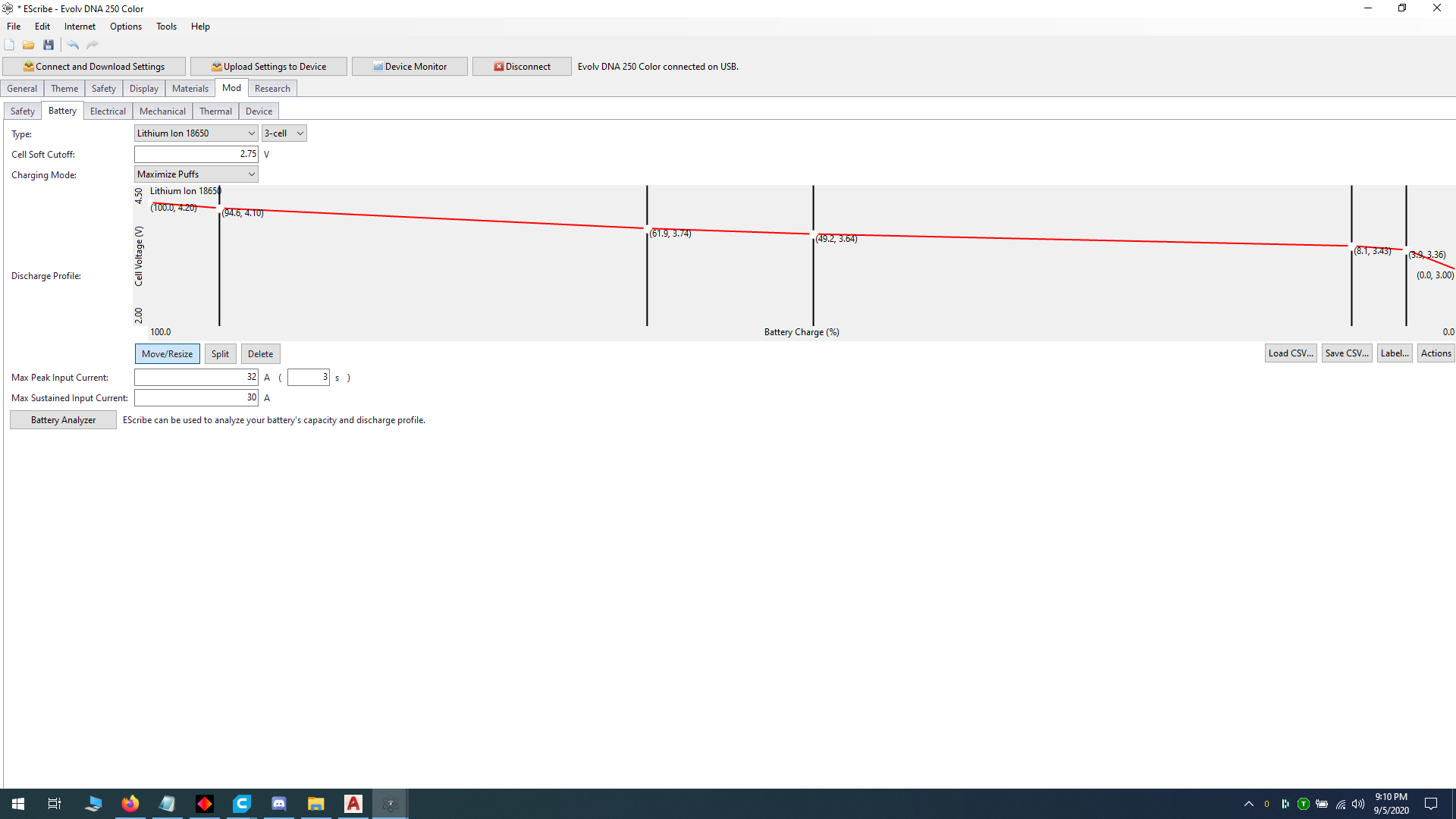

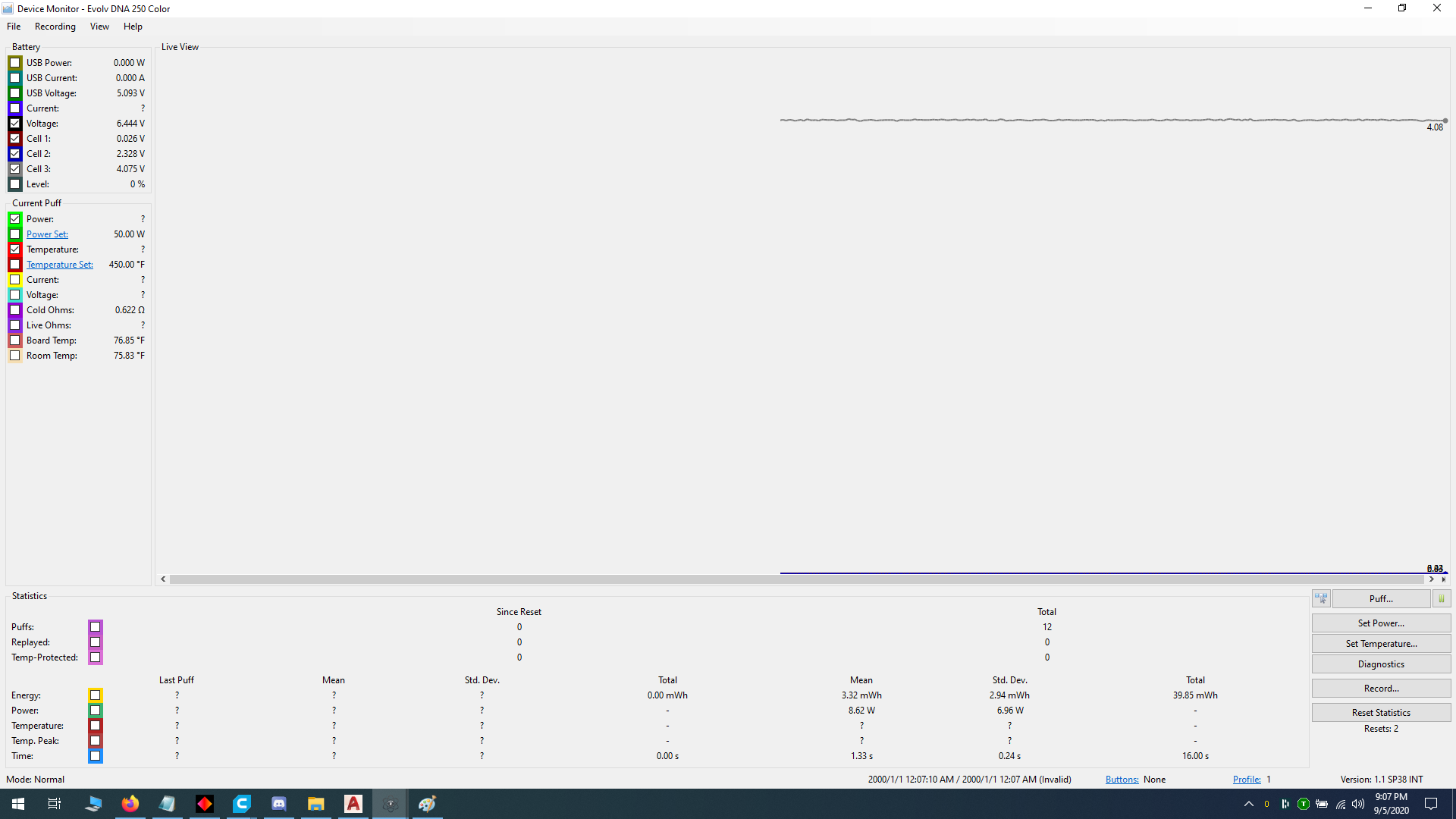

yepper just rechecked. everything looks good on the wiring, batteries, battery clips, soldering, all of that. for some reason the board, both of them, are just not right. even on the device itself its reporting only 6.6v total and all sorts of screwed up crap for each individual cells, similar to what escribe is reporting. the only setting changed is some service packs, and changing it from lipo to lithium ion. one mod thought it had 4 cells so changed that to 3, the other one realized it had 3 cells.
