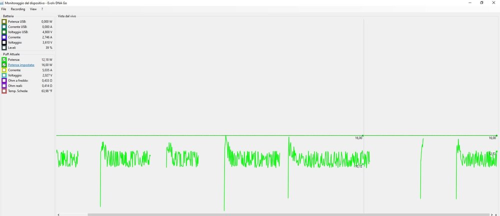

  2. Hello everyone. I update this post after Evolv technical assistance replied to me a couple of weeks ago after I wrote to her telling me after various tests that my Neo Go needed to be repaired. I turned to the dealer who it sold and it was replaced and now i have a new one that works great. I attach the Monitor screen, now the two power lines set and the power supplied are parallel and close together. Thanks again Thanks To all for us support

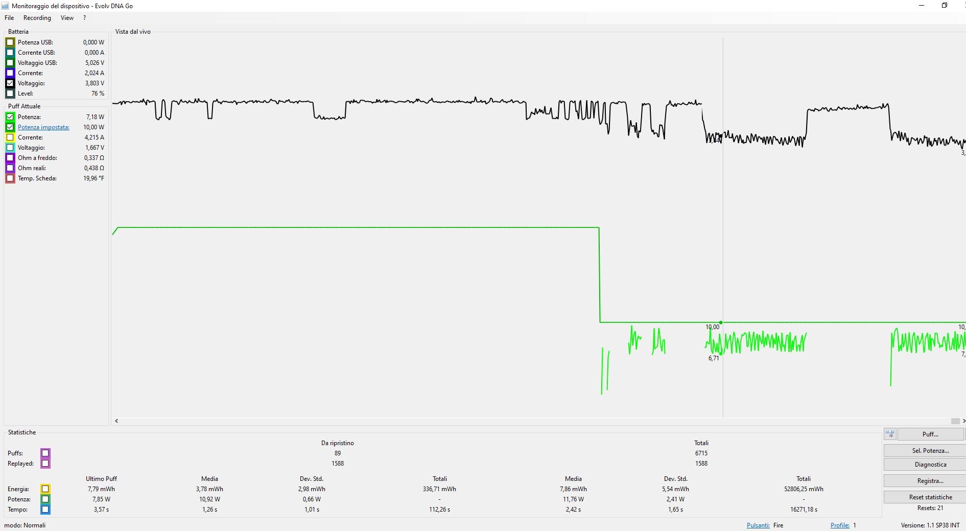

  7. Now jumping at 97% CHARGE and make one screen
  8. the battery I just charged, just inserted in the mod it gave me 98% in escribe, after the first fire 80%, but I'm sure it's charged !!!
  9. done!

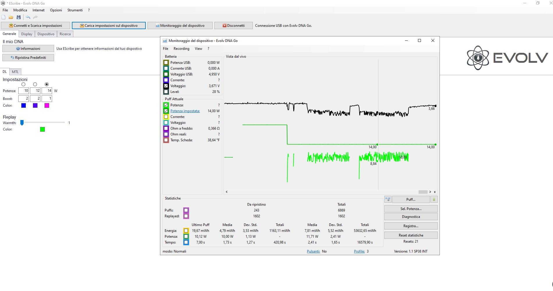

  10. But I noticed a strange behavior, when I change the profile, in the general tab between mtl and dl, the colors on the mod button always remain those of the Dl profile, maybe there will be some mess in the profiles? and then the power of the profile does not match with the power in the device manager .... I don't understand why ...

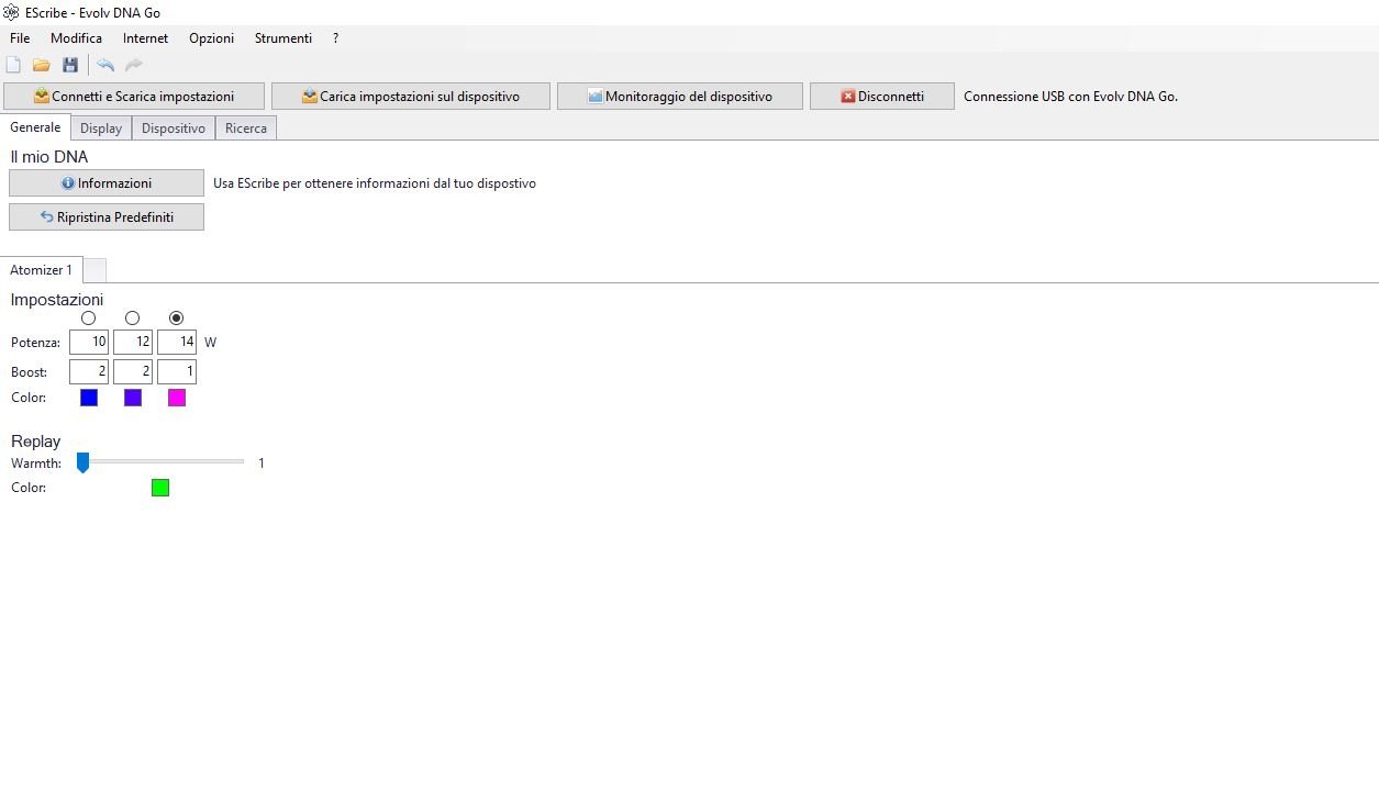

  11. if I don't enable atomizer profiles, in the general tab I see just one tabs that by default atomizer 1 which corresponds to profile 3. now I enable them and let you know

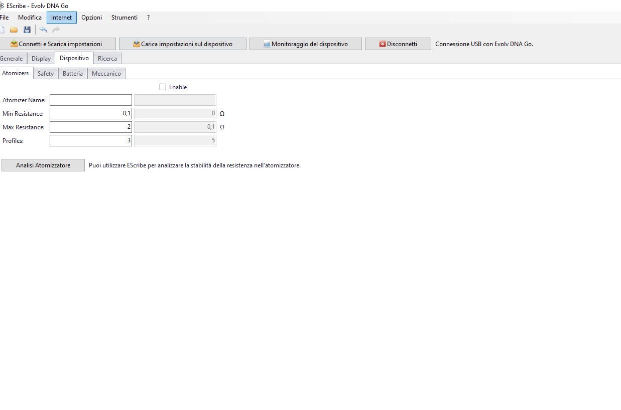

  14. MY atomizer setting=default
  15. i have disabled atomizer profile, i use default setting in atomizer tab, I tried to use the profile values those of the manual 0.50 mtl, and 0.25 dl but it changes little, the box is always irregular. then I disabled the dl and mtl profiles, and I always use the profile with a single atomizer.

  19. Hi retrid The replay is disabled, also you can only activate it by pressing the button on the Mod and not in the software, it is the first thing that I have ascertained, I put 4 attachments so you can see other settings too. you also see that I have also changed the watt setting, I even lowered it with 3 new values, but in the graph, I can barely reach 70% of the watt value I set See the volts as they go down to the Puff box. Pino

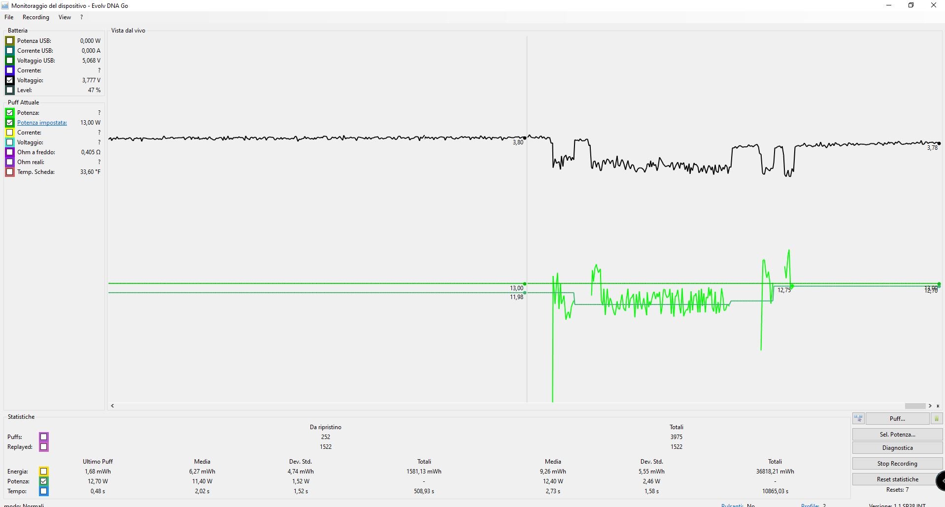

  21. if u can see in this attachment, the volts are at 3,777 despite being 44% battery, with 100% battery also arriving at 4.0-3.9 volts quietly. it is the power that oscillates quickly even in the graph and continuously
