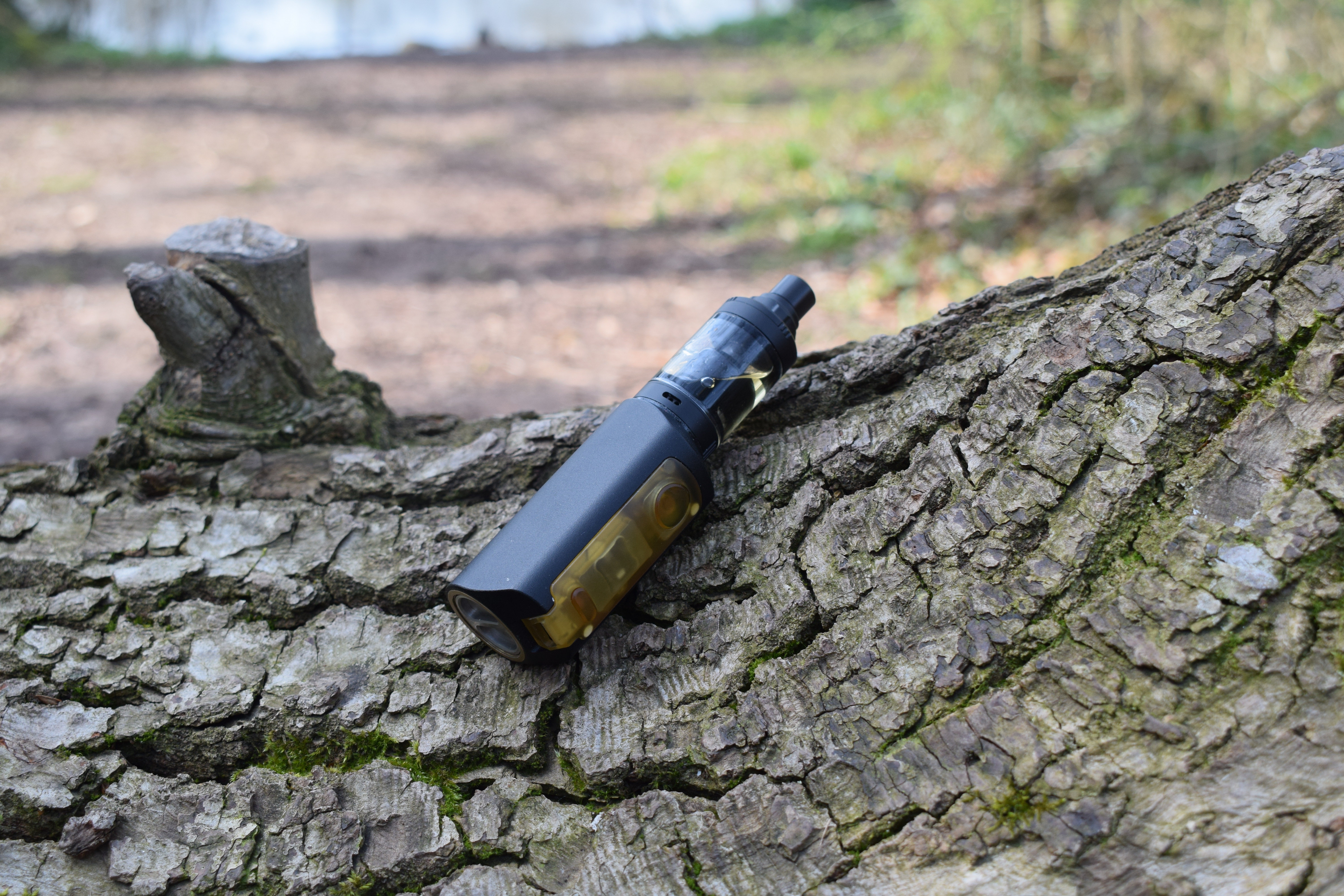

    Neo Go
    Since the modder thread does not exist I allow myself to write here. (delete if necessary) We wanted to use the chipset dna go in a mod using a 18350 battery and a 510 that can accommodate any RTA up to 24mm type MTL. Here is the result This mod is machined from aluminum
