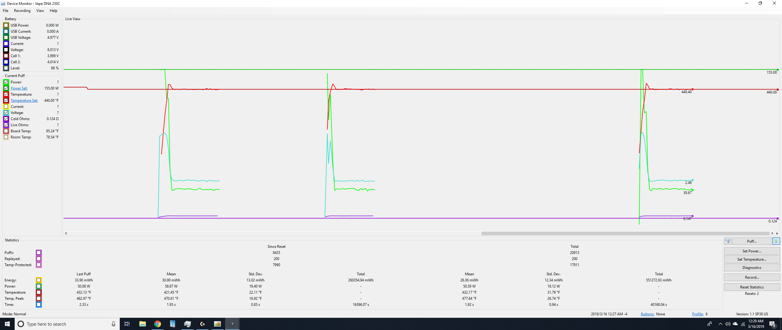

  1. Hey Guy Fawles can you pls just hack my escribe and fix my settings? or at least tell me what iphone app I need?
  2. Info Paranormal DNA 250C Geek Vape Zeus dual coil Advanced Vape Supply triple core fused clapton SS316L wire ~.124 ohms Set to 155w Set to 440 degrees F No punch No preheat These settings work very well for me. It seems like most people use preheat but why? Why not set the wattage high and let the chip back off the wattage when it gets to the correct temp? I also see people saying SS wire builds should have a higher resistance but I've used the same setup for months with no problems. Any thoughts or recommendations are appreciated, thanks.
