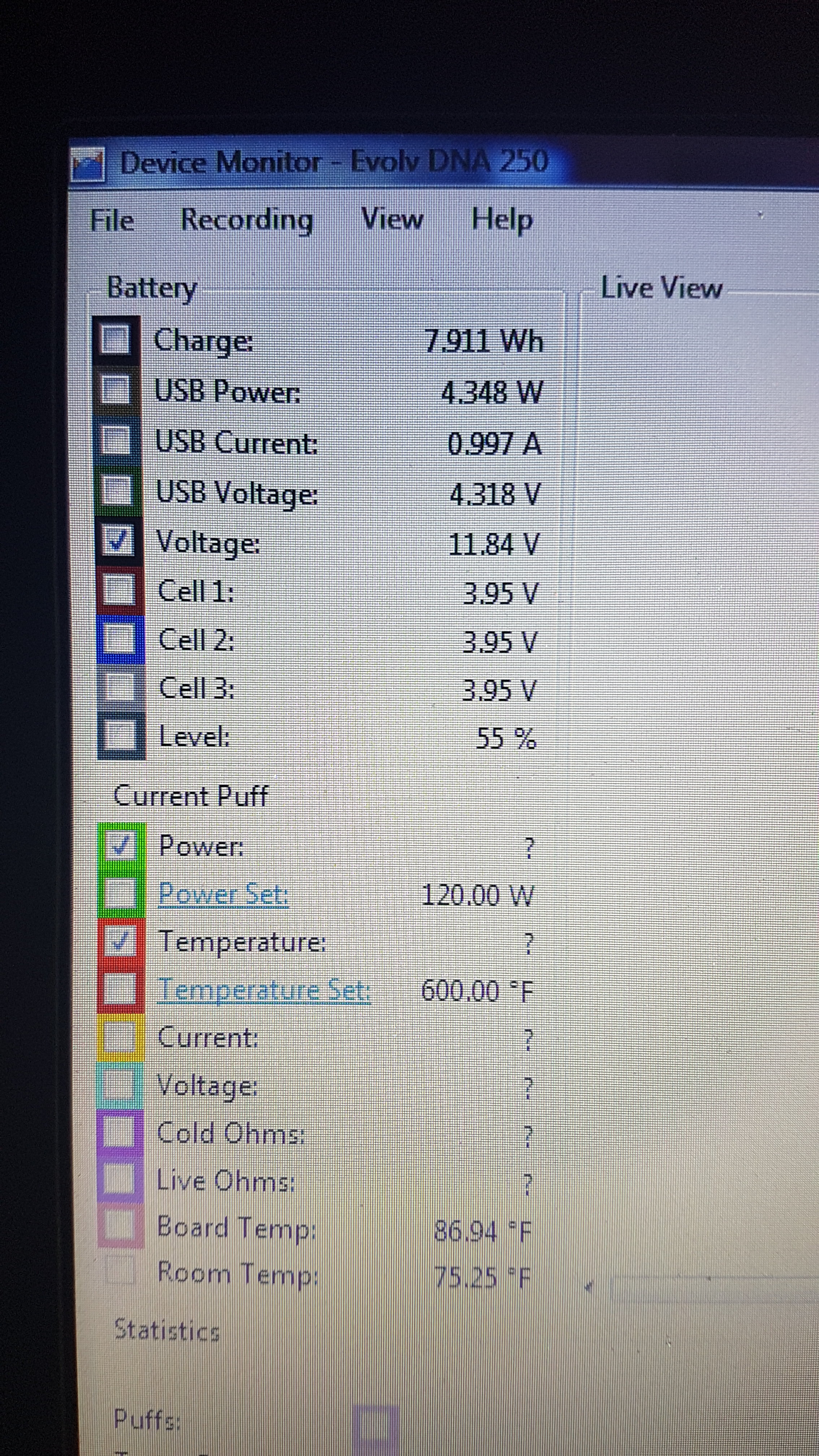

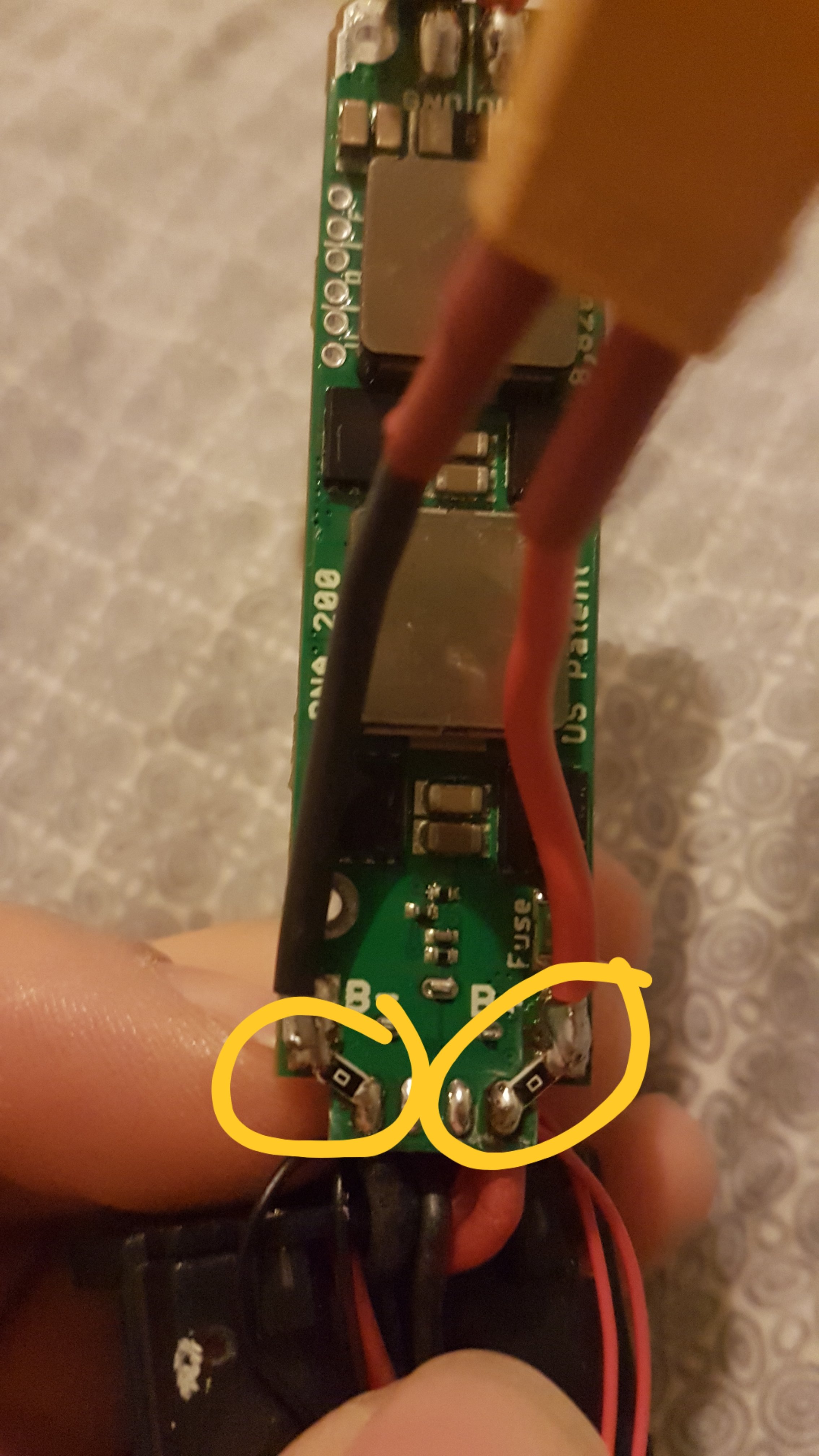

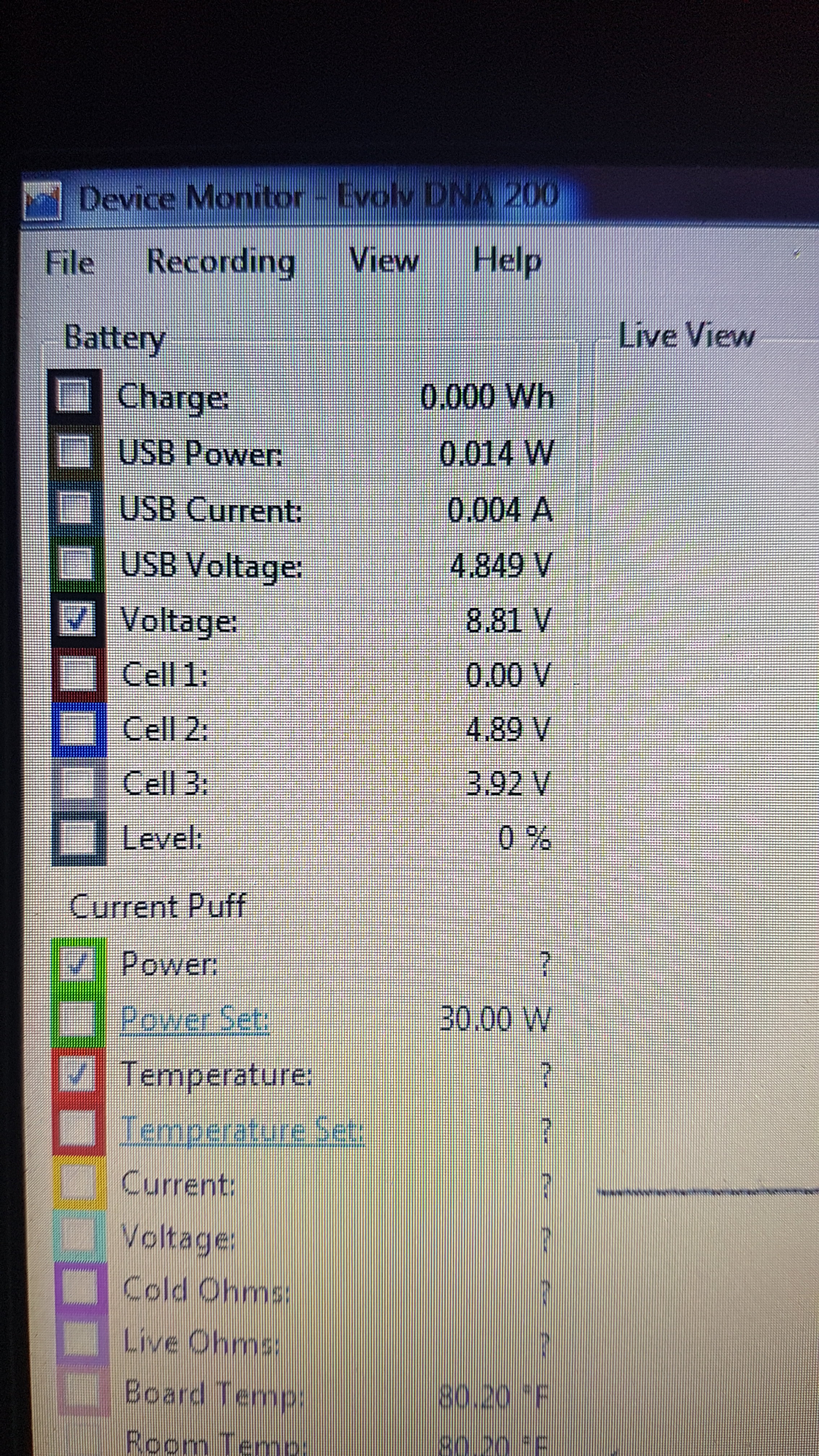

Hello guys . Long story short . I lend my mod to a friend and after a couple of weeks he brought it back after dropping it and it refuses to work . The body took some damage but since I own a 3d printer i wanna reuse the board and have it put in a custom enclosure . As the title says when trying to power the board I get the logo only and it stays on only when pressing the fire button . I cannot see any signs of damage or blown fuse on the board itself . Connected to Escribe and did a factory reset for settings and it still didn't power on but with the usb cable on it displays check atomiser and lets me lock and unlock it . any ideas what it can be ? In the files it's the comparison between this board and another a 250 dna plus the behaviour
