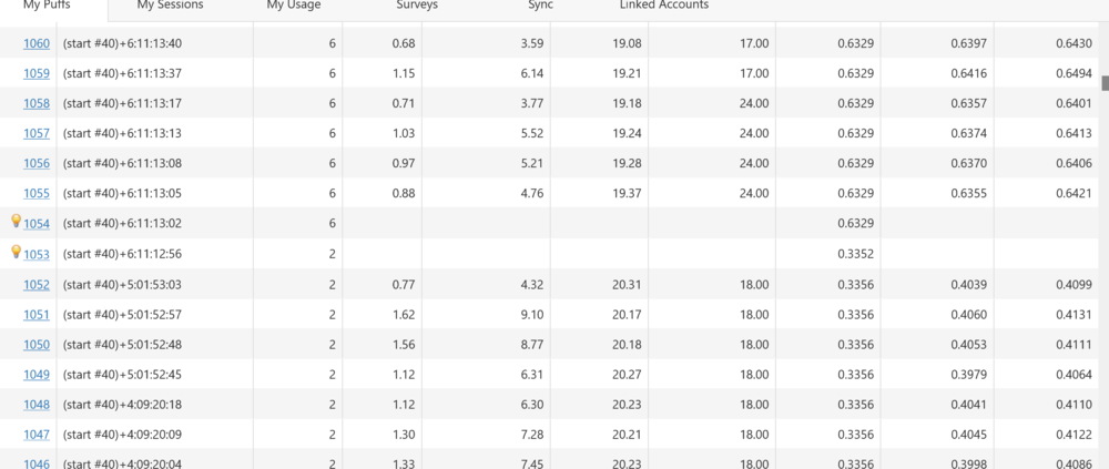

@James Bellinger wow, I've never looked at Ecigstats in 10+ years that I've used DNAs. I don't believe I've had a dry coil event 1200 odd puffs to got through, the Xlim registered a 'fill pod'..I remember it clearly but it wasn't empty. Pod in pod out. Doesn't seem to 'remember' the replay setting every time it comes out of idle, no great inconvenience Also had the device fail to wake up today, thought the battery had gone flat but it woke up when I plugged in the USB. Still at 87%. Must remember to remove the pod to prevent sampling from running it down? Same issue with Steamcrave 4S 250C which wasn't recomended to be updated ..guess what? drain got worse.. I actually bought a few packets of SS and just the one pack of Kanthal. Was almost satisfied with SS at 17-18w , really need replay for the SS too, puff,puff,puff . Got that the wrong way around, now I've tried both materials I prefer the Kanthal, 0.6 ohms@17w better flavour. The SS coil is bland, strangled, Compare those ohms? The thermal dynamics aren't the same..🙃 Screenshot of change over from 0.6ohm stainless pod & first use of 0.6ohm Kanthal pod. -

ah yes, found the 'equivalent ohms' icon in display colour schemes, tbh as I don't mess about with colour schemes or icons so I didn't look further. Just took it out of stealth mode..or not😁 I thought that was to denote SS / anti-burn. still 0.33 is not ~ 0.6, thats like saying cat = dog because it has fur and four legs. thanks for the help sure I'll work it out as I go along, just trying to work out whether I need more 0.6s or should buy a selection 0.4/0.6 SS and a comparative 0.6 kanthal..Be a damned shame if the kanthal turns out to give a better vape. BTW, made up my usual ADV in 50/50 dessert & strawberry..would perhaps benefit from more flavouring or just the wrong way to go? I have two more steeping, @20% conc, an old bottle of Red Astaire and some key lime, -

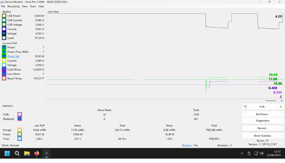

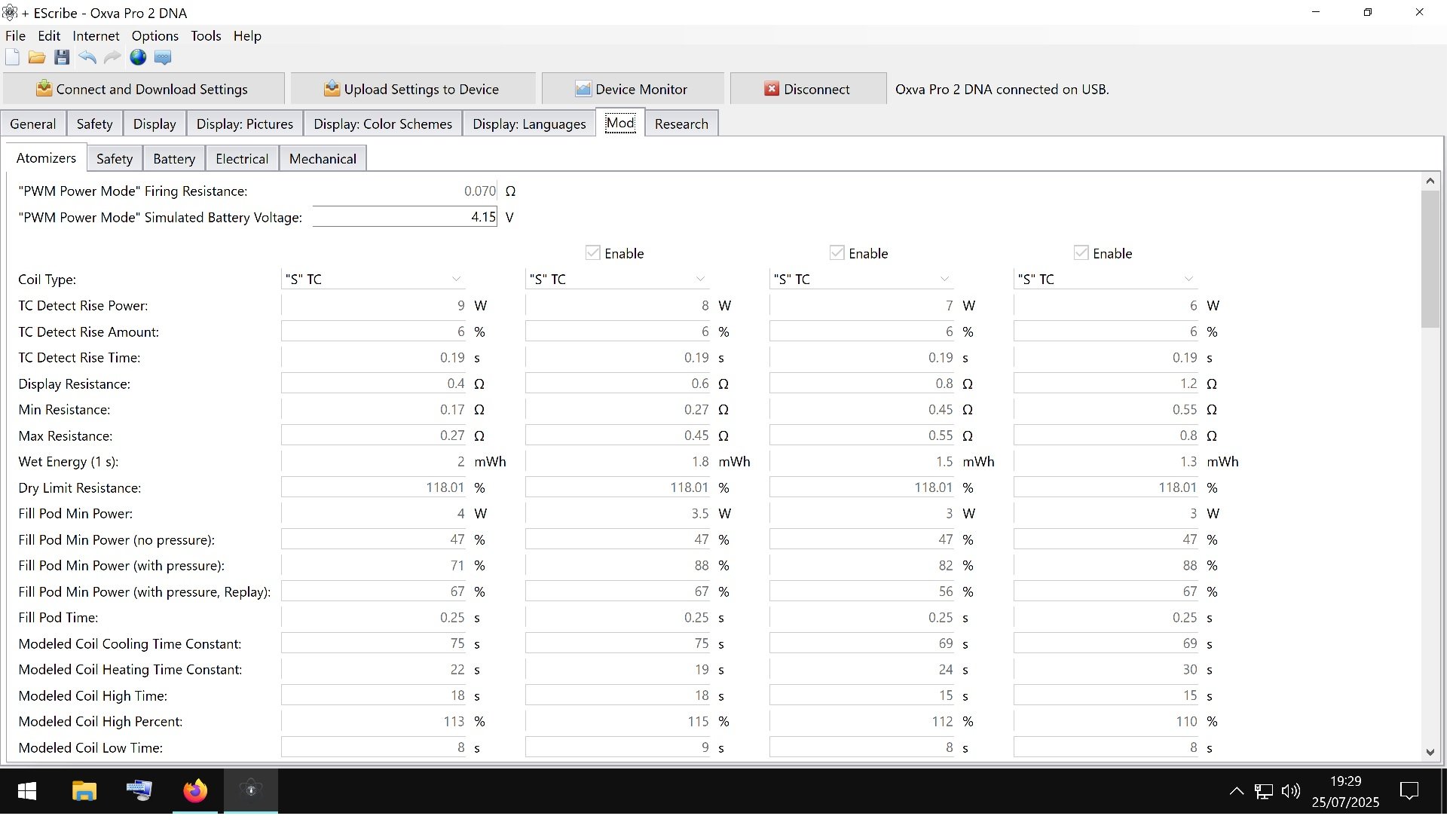

Gone to the opposite end of the scale from my usual table top DNA 250C, RTDAs and RDAs. The replay works, the 'anti-burn' works but all things considered the vapour and flavour is very disappointing. I've never been great a fan of SS coils, but the 0.6ohm pod vapes like it's overpowered on boost but throttles off too soon for warm flavour. I've plugged it into E-scribe, adjusted the wattage (18w), boost (zero) and warmth (7) until I get the flavour and temperature near enough. So the Xlim registers a 0.6 ohm coil, my multi-meter reads 0.6 ohms but E-scribe reads the cold resistance from as low as 0.28 to an average of 0.33. In developer mode, the preset for SS 0.6 ohm pod shows min resistance 0.27 to a max of 0.47. Something can't be right?
