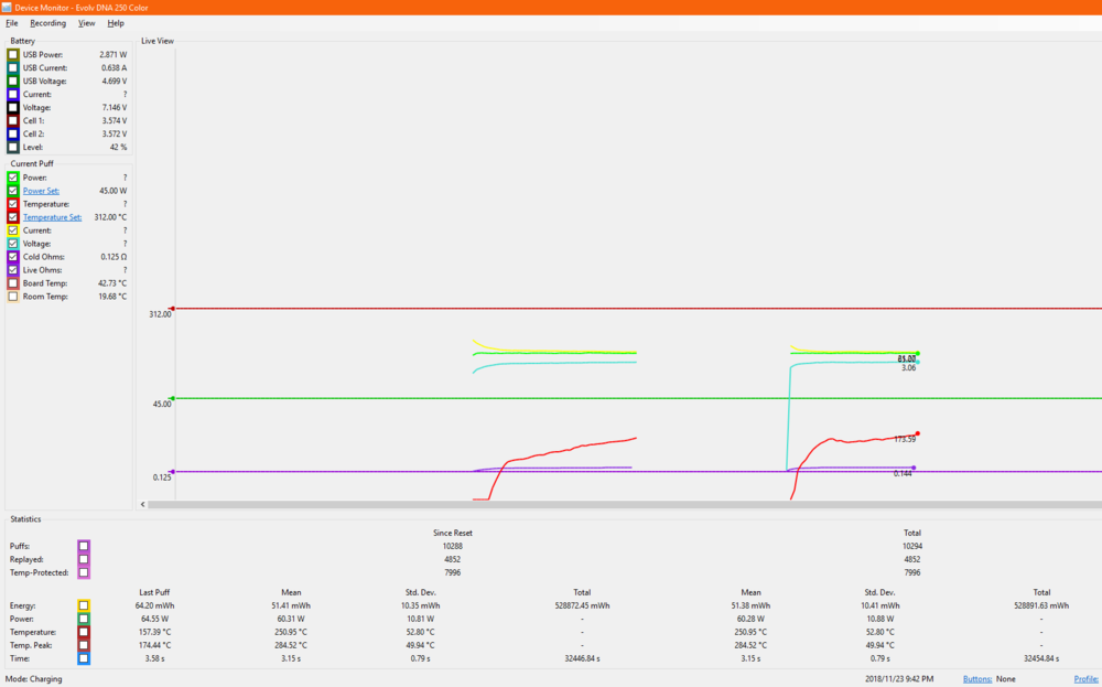

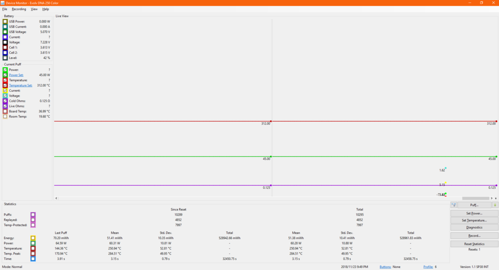

Well, after using the other posted firmware I had no issues. Yet today as soon as I change my coil, it starts to happen again.
No reason behind it. Tank can be full of juice or nearly empty. Be charging or not.
I have no idea what causes it and it's really annoying as I paid (what I consider) a lot of money for this and I have to use it in wattage mode going forward.
Here is a normal puff
Here is "temp protect"
Doesn't show me anything I can work off.

Sure,
This is a normal puff
This is a "temp protect" puff which is happening all the time now. I have to use wattage mode.
