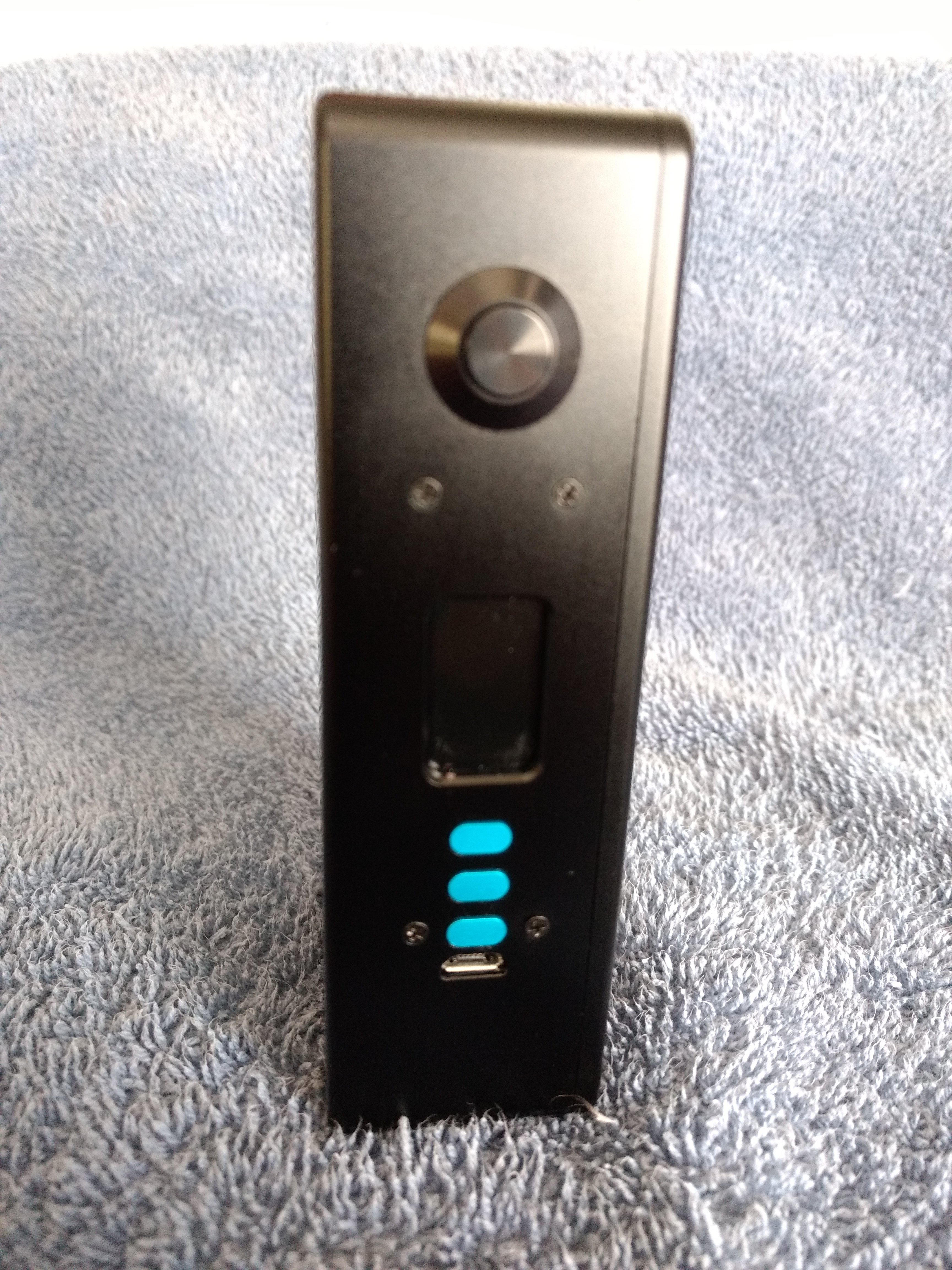

Anybody ever figure out what caused this issue before I replace a board? I have a 250C that throttles almost constantly

If anybody ever has this issue try changing cables. I tried 5 different ones before I got one to work and it loaded right up

I tried quite a few cables before I got one that would connect.
