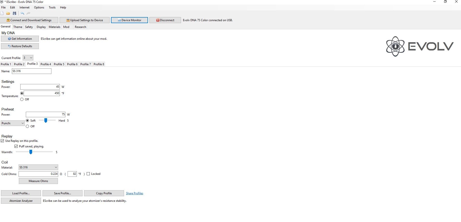

Here are my settings. I am using ss w 8 spaced wraps on the Bonza. No luck.- 20 replies

Hey all, I've recently purchased a Lost Vape DNA 75C Mirage and I'm having issues with Temp Control. I can't get it to work at all with different materials and different atomizers. I've spent countless hours googling, youtubing, and searching the forums but can't figure out what's up. When I hook it up to Escribe and go to device monitor I get no temp reading when vaping. I've spent about a month pretty sure that this is due to my noobness with the DNA and Escribe but now I'm starting to wonder if there could be something wrong with the board. Can anyone help? Attached is a screenshot of device monitor with Temperature checked but not showing anything during two puffs. Atomizers Used: Smok TFRDTA GeekVape Avocado RDTA 24 Vandy Vape Bonza RDA Materials: SS Kanthal Ni80 Document.docx
