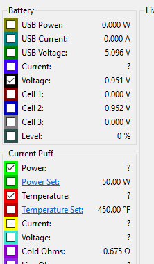

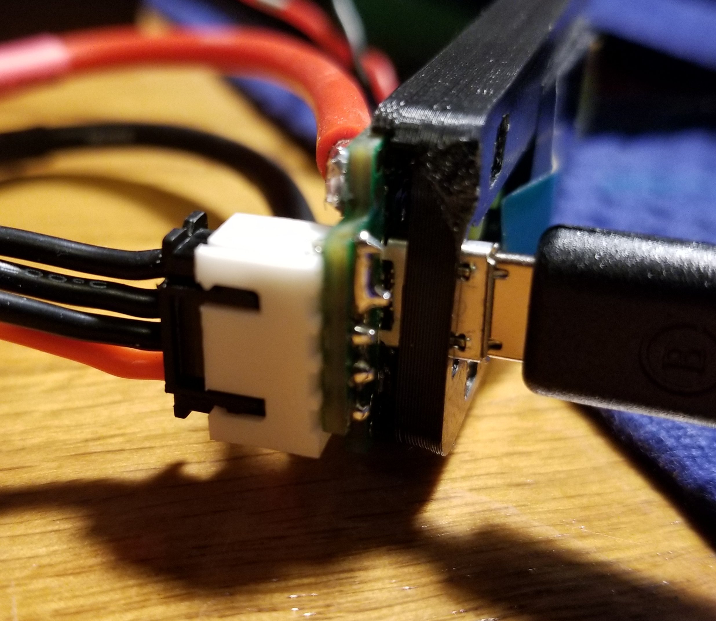

  1. I got a box of parts from a customer that "tried" to build his own dna250c having never done it before, just wanted to start there. Ive got the 250c wired up but it is not reading the 3c turnigy graphene lipo he sent me with all the parts. I have installed a 3s jst plug as shown for a 3s set up and bridged the 3&4 taps and this is all I am getting. (see image) When I unbridge the 3&4 I show 0.178v on cell 2 & 3 but nothing on one. I am lost I have built many 200 and 250 but this is my first 250c. Im wondering if I have it right as well since this Graphene is wired with differnet colors than im used to (assuming red is the ground and 3 black are cells )
