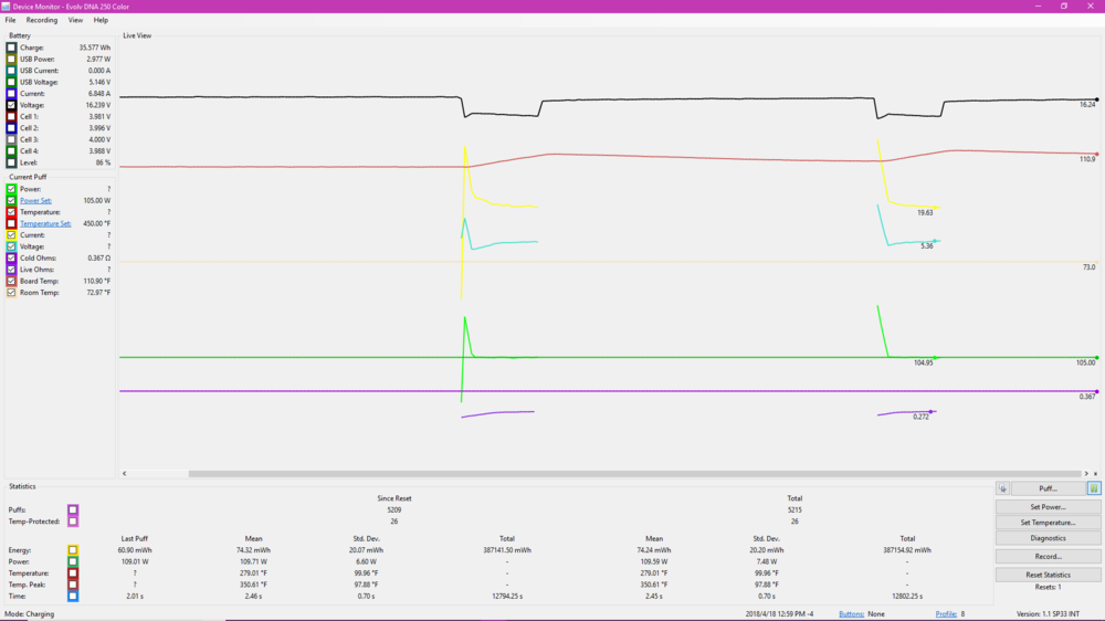

    Here is what I am getting in device manager.

    Help
    I have a Mad Modder Mod with DNA 250C chip with 4s lipo. My build is Lightning Vapes SS316L 2 core fused clapton 26g/36g 8 wraps non spaced 3.5mm id. Cold ohms is .34 and live ohms is .27. I cannot get tcr to work in SS316 mode. I always get temp protect message. Also, when I play replay, I get check atty message. What do I need to do to get these modes to work? I have tried different atomizers as well with no luck.
